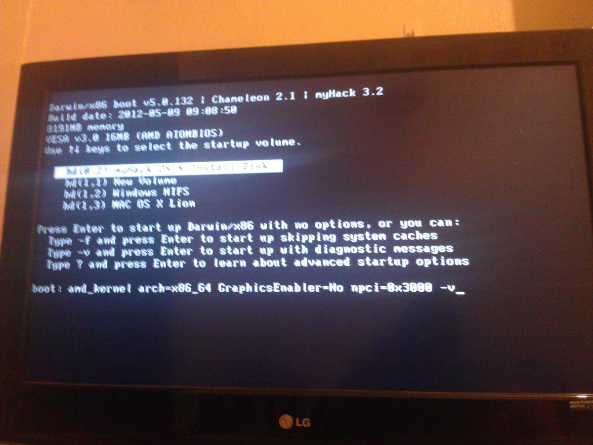

Edit: I installed the myHack bootloader, I have the same com.chameleon.plist as you, deleted ati6000.kext as mentioned before.

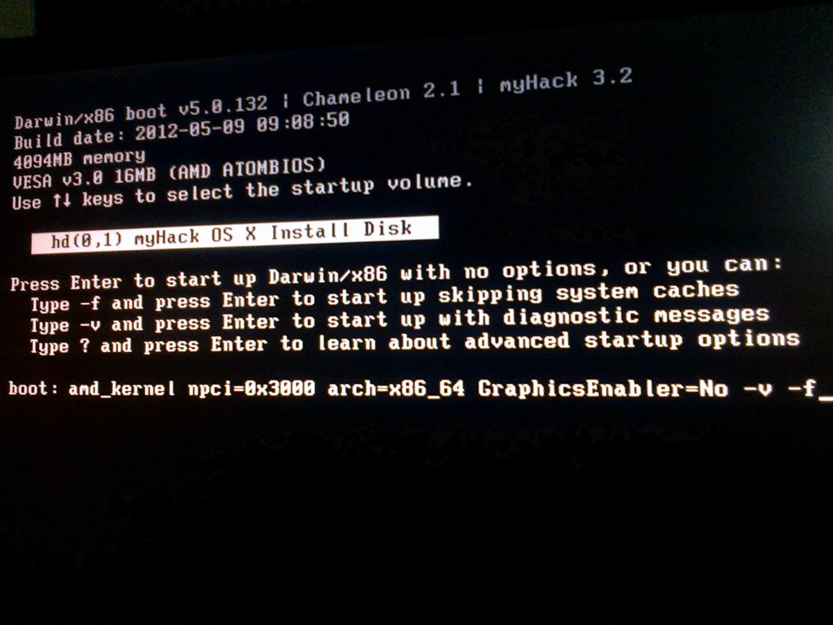

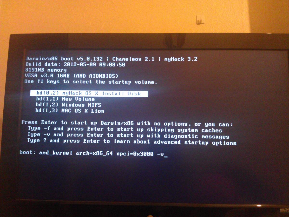

The first time I used flags: amd_kernel arch=x86_64 npci=0x3000 -v as can be seen in the first image and it hung at jn[: disk0s3: journal replay done. as image 1.jpg from one of the previous posts.

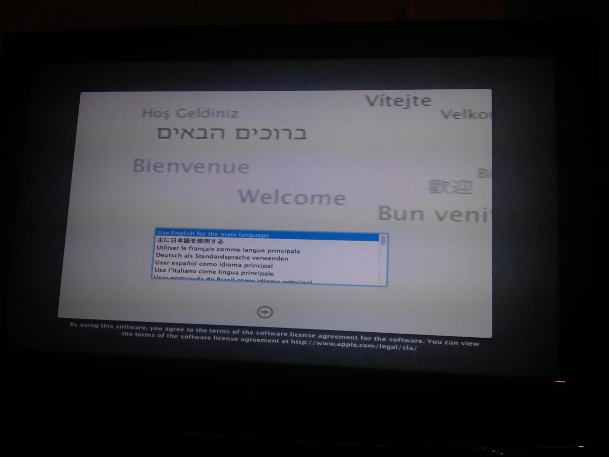

I then rebooted and used flags: amd_kernel arch=x86_64 GraphicsEnabler=No npci=0x3000 -v, as can be seen in the second image and it booted into the install as can be seen in the third image.

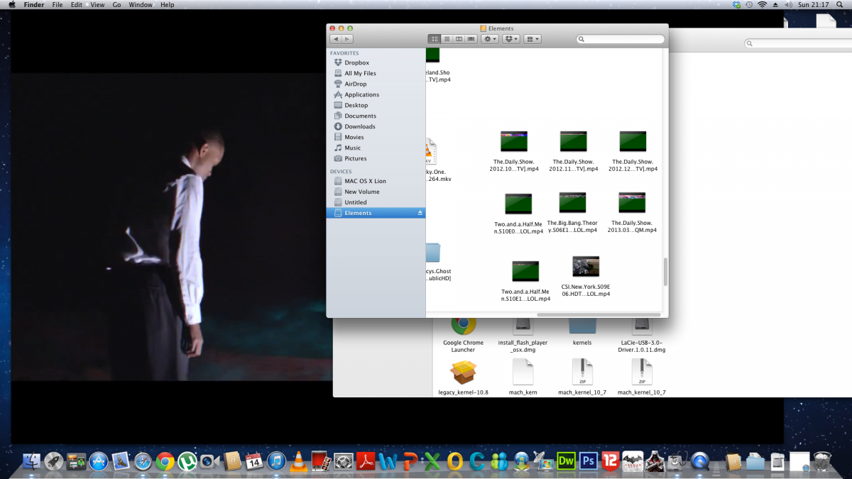

@ptp here are the graphics issues I have...
If i try play the thumbnails they have graphics issues as well, green pixels and all but if I play the actual video in QT or VLC, it is fine
I have the same issues. Any word on a fix...? Certain video formats play with no issues, while others have graphical corruption.
If Mountain Lion, there's no fix yet for any of the know graphics issues on any card. The fix up to date is buying a card that's proven to give the least issues.
That is in 10.7.4, if it was in 10.7.5 the video playing in the background would be green and have various graphical issues
Interesting. Better saying, worrisome: is your card supported by OSX out of the box? Absolutely all reports i have about 10.7.5 with Bronzovka's RC7-13 in 32-bit tells me everything but Adobe CS6 (which needs a little hacking) is working as it should without much any tinkering. You (and possibly ADHDMedia) seem to be the unlucky exception(s) (not counting users of cards that's intrinsically difficult for OSX86 even on Intel boxes).

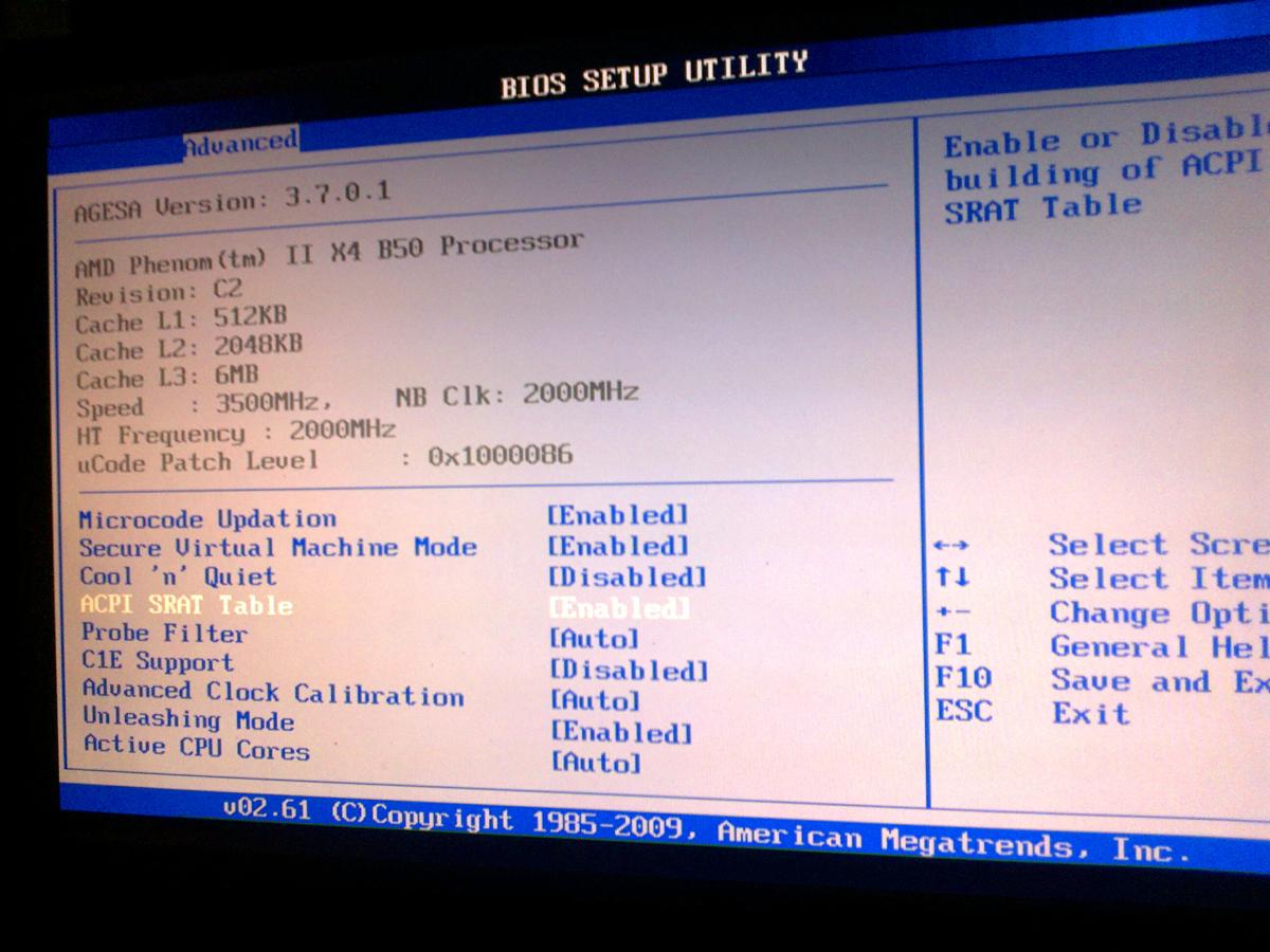

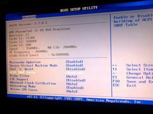

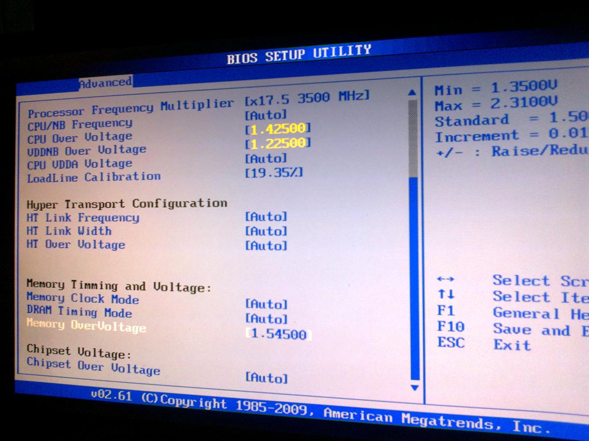

I have made only one change in BIOS - set sata to AHCI. Given that my Phenom II 550 BE is overclocked all the cool'n'quiet etc are all disabled.
Please let me know if there are any other BIOS changes I should take care of.

BIOS) Disable C1E, Cool and Quiet, enable AHCI;

Bootflags for the installer media) amd_kernel arch=x86_64 -v -f npci=0x3000 GraphicsEnabler=No
That at first, and only that. Good luck.

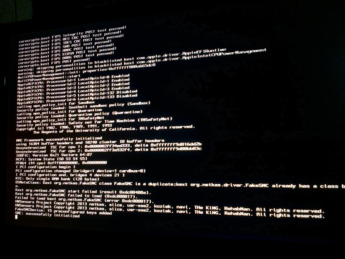

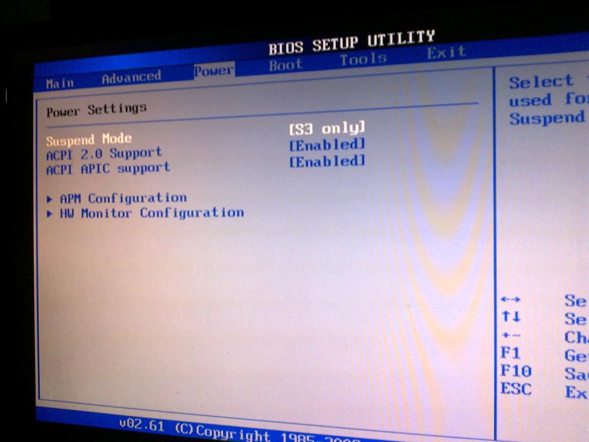

My Secure Virtual Machine Mode was enable but the power setting was set to Auto, made it s3 only.
Made my USB with myHack, put in amd_kernel in the root, put FakeSMC.kext in /E/E
I put in the flags given by theconnactic - amd_kernel npco=0x3000 GraphicsEnabler=No arch=x86_64 -v -f
I end up with a "Fake SMC failed to start" (image attached)
Should I run myFix to rebuild kernel caches etc?
