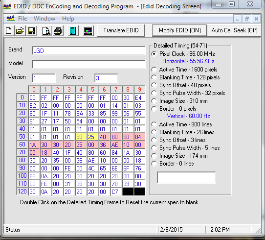

TimeWalker75a Posted February 9, 2015 Share Posted February 9, 2015 I have swapped my 8 GB of 1333 ram with 4 GB of 1600 RAM from my MacBook to my Dell. Ever since I changed the ram to 4 GB I get random horizontal screen tearing with the lines appearing and flickering all across the screen. I have had slide=0 and EDID override for my 14" 1366x768 panel forever, but it's not cutting it anymore for some reason with 10.10.3. Might have to look at your tips for panel size adjustments. Link to comment Share on other sites More sharing options...
TimeWalker75a Posted February 9, 2015 Share Posted February 9, 2015 I used to rely on the assumption of having horizontal sync offset = 48 and horizontal sync pulse width = 32 cure the artifacts, but it doesn't seem to help anymore. I was also playing with pixel clock back in the day an it helped resolve the artifacting for good. Having read your suggestion to alter panel size to 310x174, from default 16:9 format of 309x174 doesn't really change anything for me currently, random horizontal lines still persists. I feel violated :S Link to comment Share on other sites More sharing options...
tluck Posted February 9, 2015 Share Posted February 9, 2015 @TimeWalker - what is your vertical frequency? somewhere i recall should be as close to 60.00 as possible. i had issues with the embedded EDID - the basic params where just broken. the picture shows the EDID i have been using. i realize its for 1600x900. the key fix was on line 20 - basic params - works 80 1F 11 78 EA embedded 90 1F 11 78 02 - the 90 was messed up? Link to comment Share on other sites More sharing options...
