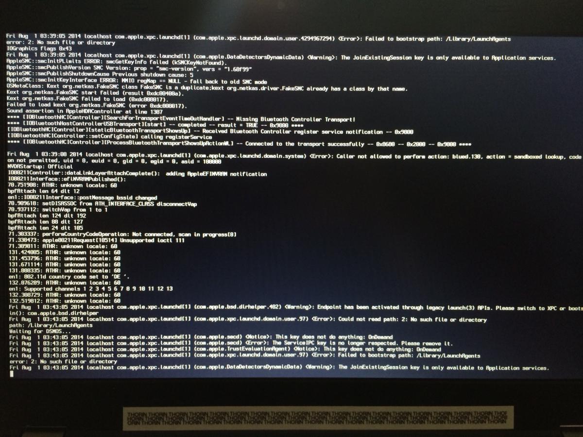

Cowboy Mike Posted August 4, 2014 Share Posted August 4, 2014 congrats @glas_guy and have phun with it @all - - I cannot get that californian national park to boot - stuck at the below - please advise - Thanks Link to comment Share on other sites More sharing options...

tluck Posted August 4, 2014 Share Posted August 4, 2014 @Cowboy Mike - hard to say but it seems like FakeSMC did not load? something about duplicate. is this a fresh install or install onto of mavericks where there are kexts already in /S/L/E. clover with the HFS-plus driver should be able to detect if FakeSMC is there or not and load from ESP if not on the HD. - can't tell from the image what happen or not earlier. - i would NOT try don't boot without caches yet on yosemite - let yosemite rebuild them when up and running. Note: netkas just updated his FakeSMC to 6.10.1323 (vs 1315) for yosemite. i have not updated the bundle yet. 1 Link to comment Share on other sites More sharing options...

Cowboy Mike Posted August 5, 2014 Share Posted August 5, 2014 @Cowboy Mike - hard to say but it seems like FakeSMC did not load? something about duplicate. is this a fresh install or install onto of mavericks where there are kexts already in /S/L/E. clover with the HFS-plus driver should be able to detect if FakeSMC is there or not and load from ESP if not on the HD. - can't tell from the image what happen or not earlier. - i would NOT try don't boot without caches yet on yosemite - let yosemite rebuild them when up and running. Note: netkas just updated his FakeSMC to 6.10.1323 (vs 1315) for yosemite. i have not updated the bundle yet. I'll wait - everything works on the surfer's beach. I'll stay seaside then. Before moving into the mountains later this year Link to comment Share on other sites More sharing options...
