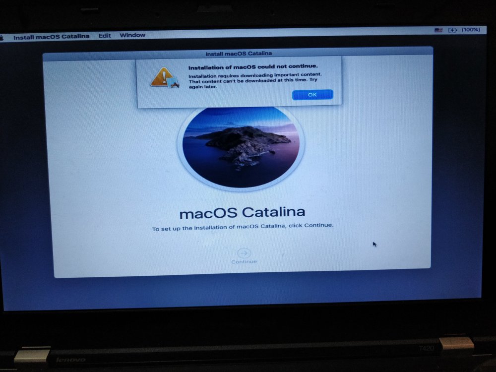

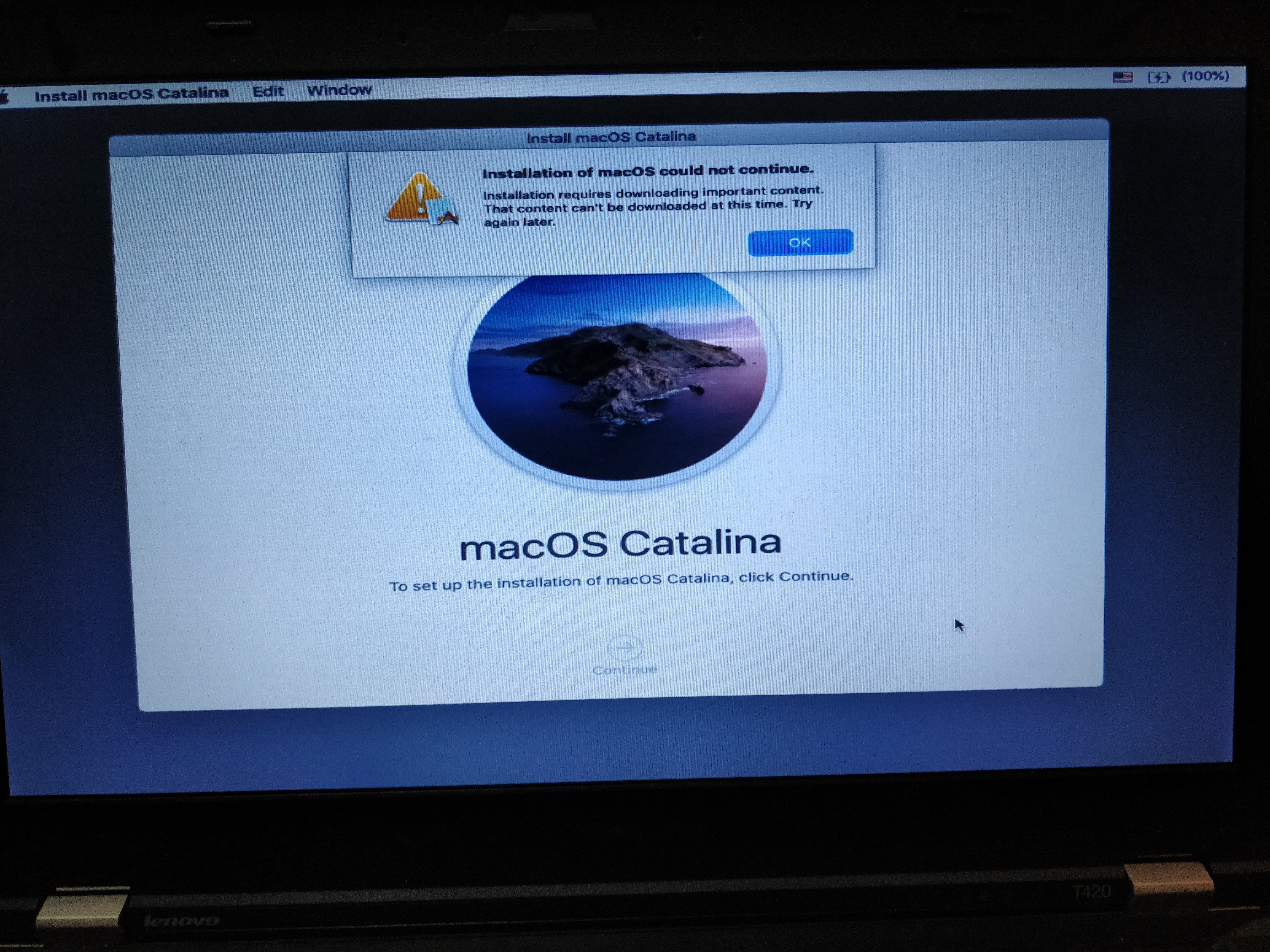

After making the bootable catalina USB for my T420, I have a problem with the installer. I get the error "Installation requires downloading important content". Apparently even real Mac owners were facing this issue with Catalina as well. There are many different suggestions as to how to fix this online, but the most common suggestion is that the SMBIOS is incorrect. I'm using the default config file from March of this year as my machine is the exact same specs as tluck's.
Edit: I am plugged into Ethernet and can even access Google from safari in this live boot environment. I still get this error. I don't think the problem is that I can't reach the internet. Also, I tried this over two days, so I don't think Apple's servers are down either
Can anyone lend a hand here?
Edited by SteamingYams778
lots of talk on this over the last few months here. but yeah MacOS Mojave and Catalina are not supported on HD 3000 gfx - so you have use the dosdude1.com method of creating an macOS Installer and then patching it. you combine the ESP from my guide and then use dosdude1 method to install the OS.

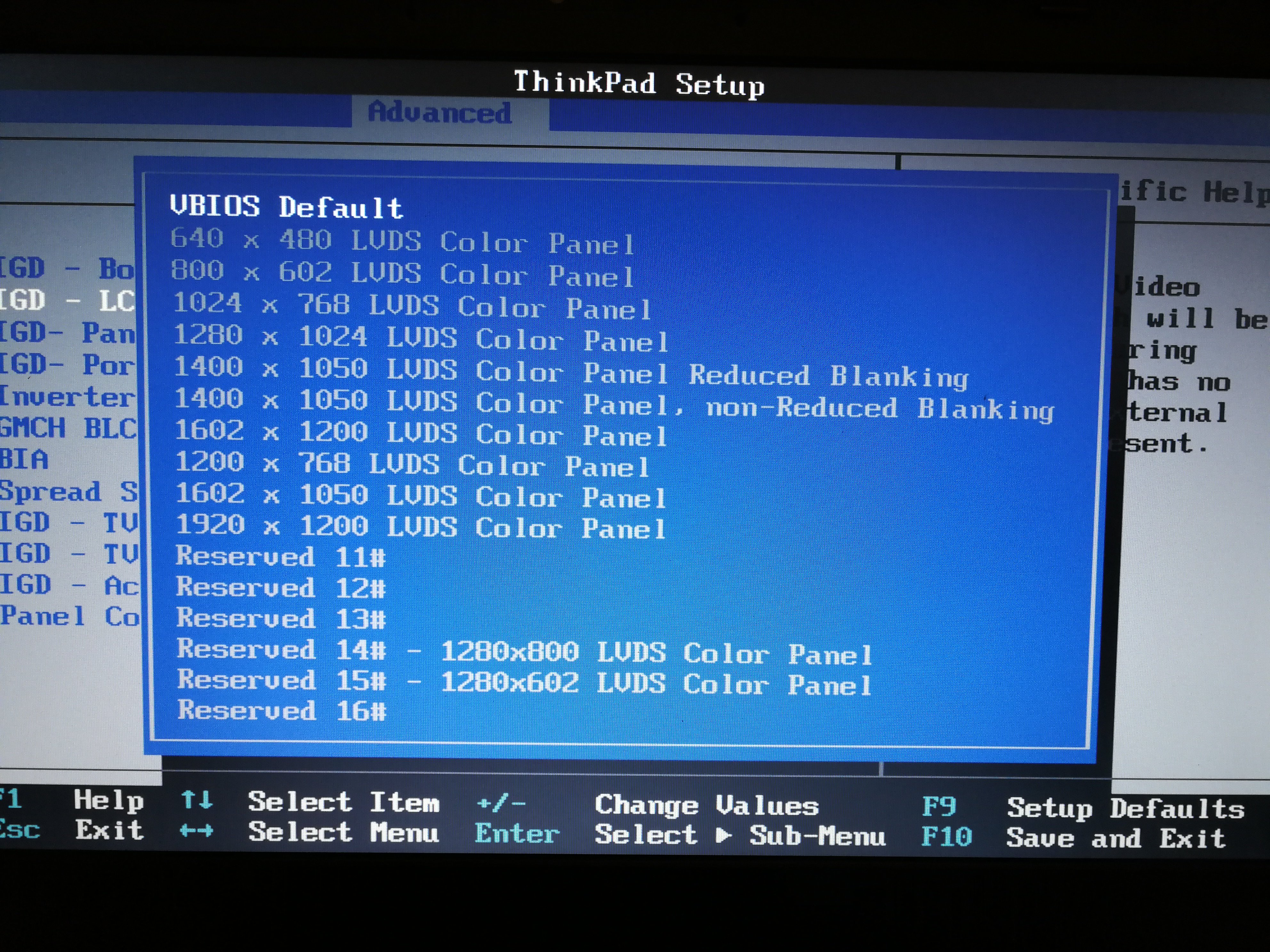

Hello! I have installed modded bios 1.46 on my ThinkPad t420, in boot section high resolution is enabled, but I don't have full resolution in clover. Anyone know why?
in boot section high resolution is enabled - i presume this is in BIOS?
what do get in Clover boot.log for resoltino options - or  when in Clover can you get there with f9 toggle thru available resolutions.

I generated boot.log and it says SetMaxResolution: found best mode 2: 1024x768. In clover i checked load vbios , patch vbios , iin GUI section i put 1600x900 resolution , and in bios i set UEFI only. But no luck
@Kralj which modded bios did you install? my clover boot log has this:
5:901  5:607  === [ InitScreen ] ==============================
5:901  0:000  Console modes reported: 6, available modes:
5:901  0:000   - [01]: 80x25 (current mode)
5:901  0:000   - [03]: 128x40
5:901  0:000   - [04]: 80x25
5:901  0:000   - [05]: 100x31
5:901  0:000   - [06]: 200x47
5:901  0:000  SetScreenResolution: 1600x900 - setting Mode 3
6:218  0:317  Video mode change to mode #3: Success
6:218  0:000  SetScreenResolution: 1600x900 - already set
last one 200x47 should be 1600x900
this is my boot.log
 [01]: 80x25
4:561  0:000   - [03]: 96x25
4:561  0:000   - [04]: 120x31
4:561  0:000   - [05]: 128x40 (current mode)
4:561  0:000   - [06]: 80x25
4:561  0:000   - [07]: 100x31
4:561  0:000  SetMaxResolution: found best mode 2: 1024x768
4:561  0:000   - already set
i downloaded Bios mod from this site
https://sdx1.net/tools/t420bios/
Thanks man. When I go to SA /Graphics configuration / IGD configuration / IGD LCD panel type there is no 1600x900 resolution.
So I need to flash this bios from your link ? Can I do that from this modded version that I have now? It's modded 1.46 but I think it is not the same as this one from your link.
so what resolution do you see?
