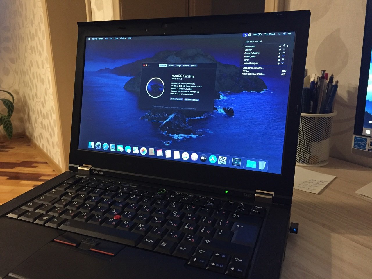

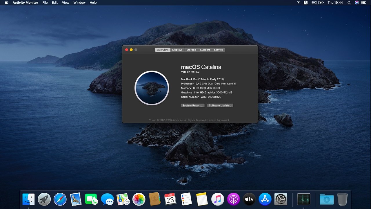

suzunski Posted January 23, 2020 Share Posted January 23, 2020 (edited) Hello, First of all, my big thanks to the truck for its work and guidance, as well as big thanks to goodguess for the tips and assistance, you are №1. After all the tips and clarifications I received, I dare say that I already have a perfectly working Catalina on my ThinkPad T420. I followed all your installation process guidelines and everything went smoothly. After installing the operating system I had a freeze again but after replacing config.plist with one from the dual_link_config.plist archive, I no longer have problems. My display turned out to be AUO after checking with Knoppix 8.6, thank you @goodguess. For WLAN (WiFi), I use the ASUS Wi-Fi Adapter USB-AC53 Nano, which I installed without a problem on Catalina. Once again, thank you all for your support. I continue to follow the topic and will be happy to help someone with my experience. Edited January 23, 2020 by suzunski 2 Link to comment Share on other sites More sharing options...

goodguess Posted January 24, 2020 Share Posted January 24, 2020 (edited) Nice work suzunski! Thanks for reporting back. Is the USB WLAN working as Airport Extreme? Looks like that, from your pictures. I would like to recommend Lulu, if you do not use a firewall already. https://objective-see.com/products/lulu.html If you are looking for anything else, send me a PM and I´ll see what can be done. Edited January 24, 2020 by goodguess Link to comment Share on other sites More sharing options...

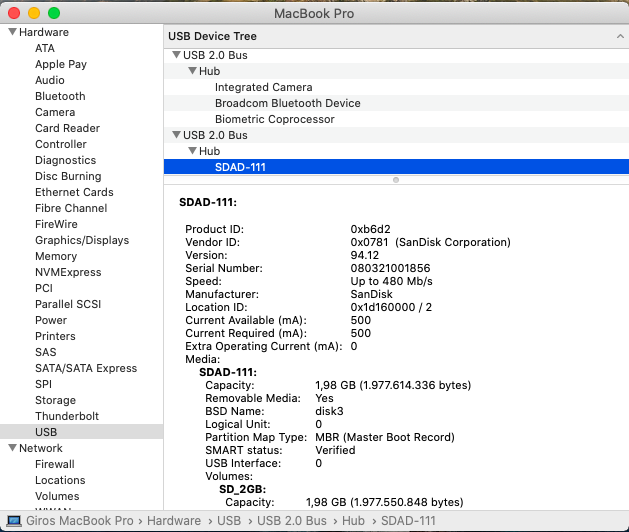

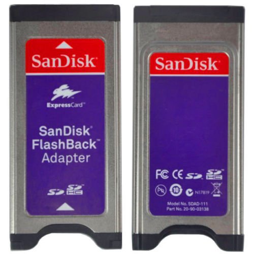

goodguess Posted January 27, 2020 Share Posted January 27, 2020 (edited) One little gadget I received to today from China: The ExpressCard is available for round about five bucks from Chnese sellers. To my bewilderment this beast just works with macOS in the T420 ExpressCard slot. No driver has to be installed no kext has to be patched, I tried with Mojave and Catalina. So this looks like the solution for everybody still looking for a SD Card reader. The ExpressCard fits in he slot perfectly, as does the SD Card fit into its place. There seems to be no way to get out the SD Card however. There is no spring to let the SD slide out as usual, pulling at the SD drags out the attached ExpressCard with the SD. That seems to be the usual behaviour for this type of card. Maybe a feature rather than a bug, as SanDisk designed this item as a permanent backup solution. Except for that the SDAD-111 is working surprisingly well. Edited January 27, 2020 by goodguess Link to comment Share on other sites More sharing options...
