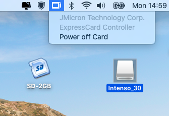

goodguess Posted January 13, 2020 Share Posted January 13, 2020 (edited) Status report: I was lamenting that my JMicron SD card reader stopped working with Catalina. Tried again with the T420S and can confirm the SD card reader is still working. Mounted the system partition read/write and did run JMicron PCIe Card Reader.mpkg. The installer told me that it was not made for this macOS, but proceeded anyway. Success so far! Too bad the JMicron based PCI card readers are that hard to find these days. As for the USB3 port of the T420S, its working with Rehabman 2015 Generic kext mostly. Sometimes a second trial is needed to have the device show up on the desktop. Last not least, I found the patched config.plist, tluck recommended, working with all T420(s) displays, no matter whether they are LG, AUO or Samsung brands. Feel free to try the attached config.plist. config.zip Edited January 13, 2020 by goodguess Link to comment Share on other sites More sharing options...

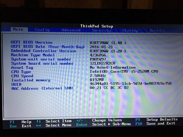

goodguess Posted January 18, 2020 Share Posted January 18, 2020 (edited) Nice finding tluck, thanks for sharing! Looks like /mod/original/$01C8000.FL1 is the one to flash first and /mod/$01C8000_NWL.FL1 the second one. I´m tempted to try with one of my T420, as 1.52 seems to be the latest BIOS, security fixes only, but still… Edited January 18, 2020 by goodguess Link to comment Share on other sites More sharing options...

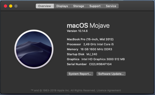

goodguess Posted January 19, 2020 Share Posted January 19, 2020 Thats strange suzunski, Safari on my side collapses to the dock in an instant, same for expanding again. What do you get when opening "About this Mac" from the Apple menu? Did you check whether the HD3000 kexts are loaded? With 8GB RAM you should see your HD3000 with 512MB RAM as above. If thats not the case, something is wrong with your setup, presumably. Link to comment Share on other sites More sharing options...
suzunski Posted January 20, 2020 Share Posted January 20, 2020 23 hours ago, goodguess said: Thats strange suzunski, Safari on my side collapses to the dock in an instant, same for expanding again. What do you get when opening "About this Mac" from the Apple menu? Did you check whether the HD3000 kexts are loaded? With 8GB RAM you should see your HD3000 with 512MB RAM as above. If thats not the case, something is wrong with your setup, presumably. Hello, thank you for your reply. When I open "About this Mac" I see exactly what you uploaded - Intel HD Graphics 3000 512 MB. I'll read if I have to do the installation again, but I really want to get it working fine. Link to comment Share on other sites More sharing options...
suzunski Posted January 20, 2020 Share Posted January 20, 2020 Hi again, I think I've fixed the freezing problem on the screen. Of course it was because I had read between the lines. Before starting OS, I went into clover options and set it to run with config.EDID-2e2.plist and I no longer have any clogs and freezes even with all the dock effects Now I have the following question, do I need to do something special to automatically load this config.EDID-2e2.plist so I don't manually ask it, or if it is already asked once it will start automatically? And one more question, come to me Security Update 2019-002, 10.14.6 - 1,36 GB which I had previously installed but then starting up the laptop and staying on the black screen, ignore it or look for a solution to this problem as well? Link to comment Share on other sites More sharing options...
