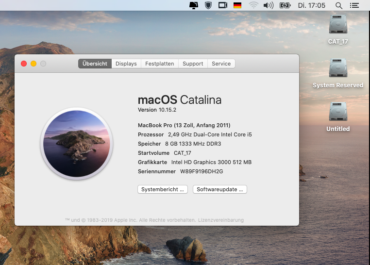

80486sx Posted December 28, 2019 Share Posted December 28, 2019 My screen is 1600*900 and in macOS is seems like it is working and it does say Intel HD Graphics 3000 when I go to about this Mac Also MBP10,1 is the only way the system boots Link to comment Share on other sites More sharing options...
goodguess Posted December 28, 2019 Share Posted December 28, 2019 No Intel kext and no Multi Fail especially. Honestly, do NOT use that Multi Shxt - NEVER. For WLAN, swap the Intel WLAN card for a compatible Broadcom one. See my post above. Link to comment Share on other sites More sharing options...

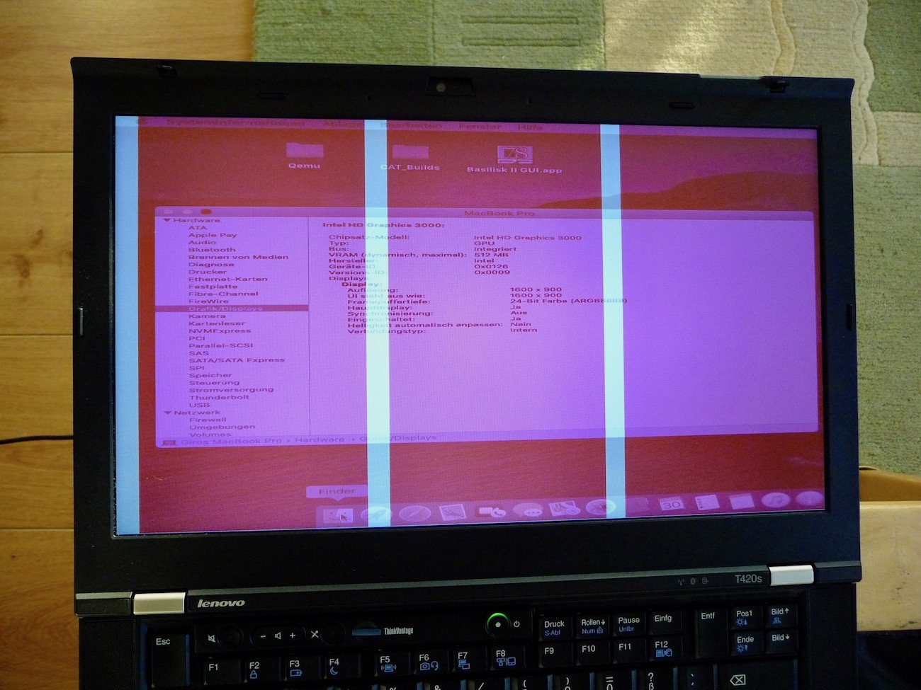

goodguess Posted December 30, 2019 Share Posted December 30, 2019 Last deal in 2019, just received a T420S which is misbehaving so far. The device has a Samsung 1600x900 display, good looking in GNU/Linux. I´m using the T420s ACPI folder and the 2e2 config.plist to test with the T420s. Starting with a Catalina mSATA made with my T420 I´m getting this: hwinfo has this about the LCD device: 30: None 00.0: 10002 LCD Monitor [Created at monitor.125] Unique ID: rdCR.iJ8kUQMT86A Parent ID: _Znp.PSB+pK7KRn9 Hardware Class: monitor Model: "SAMSUNG L KT LCD Monitor" Vendor: SEC "SAMSUNG L KT" Device: eisa 0x324c Resolution: 1600x900@60Hz Size: 310x174 mm Year of Manufacture: 2010 Week of Manufacture: 0 Detailed Timings #0: Resolution: 1600x900 Horizontal: 1600 1648 1680 1760 (+48 +80 +160) -hsync Vertical: 900 902 907 930 (+2 +7 +30) -vsync Frequencies: 98.21 MHz, 55.80 kHz, 60.00 Hz Config Status: cfg=new, avail=yes, need=no, active=unknown Attached to: #22 (VGA compatible controller) Is there an easy fix for the garbled screen maybe? A Mojave USB installer stick suffers from exactly the same graphics issue. 1 Link to comment Share on other sites More sharing options...
tluck Posted December 30, 2019 Share Posted December 30, 2019 (edited) @goodguess - it looks like duallink=1 is not applied. and since it not an AUO LCD - maybe you could try to use the native EDID vs inject the LG 2e2 info? Edited December 30, 2019 by tluck Link to comment Share on other sites More sharing options...
tluck Posted December 30, 2019 Share Posted December 30, 2019 (edited) add the AddProperties key to your config.plist to ensure DualLink -- this works whether you inject IntelGFX or not. <key>Devices</key> <dict> <key>AddProperties</key> <array> <dict> <key>Device</key> <string>IntelGFX</string> <key>Key</key> <string>AAPL00,DualLink</string> <key>Value</key> <data> AQAAAA== </data> </dict> </array> <key>Audio</key> <dict> <key>Inject</key> <string>14</string> <key>ResetHDA</key> <true/> </dict> <key>Inject</key> <false/> <key>USB</key> <dict> <key>AddClockID</key> <true/> <key>FixOwnership</key> <true/> <key>HighCurrent</key> <true/> <key>Inject</key> <false/> </dict> <key>UseIntelHDMI</key> <true/> </dict> Edited December 30, 2019 by tluck 1 Link to comment Share on other sites More sharing options...

goodguess Posted December 31, 2019 Share Posted December 31, 2019 Thank you so much - another time - tluck. I pasted the the text you gave me into the config.plist and everything is looking good. No idea where to get the displays ID, but it does not seem to be needed for now. I have yet to find a way to upgrade BIOS and put on a modded one, the notebook is on 1.31 and winflash stops on an error, even with /sa. Maybe pflash from DOS will work. 1 Link to comment Share on other sites More sharing options...
tluck Posted December 31, 2019 Share Posted December 31, 2019 (edited) 1 hour ago, 80486sx said: I had a message earlier that you didn't respond to can you repeat the question? i thought you were good to go. @goodguess cool. you can get display ids from the EDID. ioreg -l |grep yEDID if you see "30e4 e202" in the EDID, then you need to not inject that EDID to see the native one. but if it works fine as is = good! happy new year! $ ioreg -l|grep yEDID | | | | "IODisplayEDID" = <00ffffffffffff0030e4e2020000000001140103801f1178e233859956559127175054000000010101010101010101010101010101018025408060841a303020350036ae10000018000000000000000000000000000000000000000000fe004c656e6f766f0a202020202020000000fe0031363030783930300a2020202000ad> Edited December 31, 2019 by tluck Link to comment Share on other sites More sharing options...

goodguess Posted January 2, 2020 Share Posted January 2, 2020 (edited) Please disregard the writing below. BT was working with Catalina as soon as I had activated it in Windows 7 Quote One last little nag: The T420S has a BT device built in. I won´t use it much, but as usual - if its there, it should work, if possible. From Linux, the device looks like this: Quote SysFS BusID: 1-1.4:1.1 Hardware Class: bluetooth Model: "Broadcom BCM2045B (BDC-2.1)" Hotplug: USB Vendor: usb 0x0a5c "Broadcom Corp." Device: usb 0x217f "BCM2045B (BDC-2.1)" Revision: "7.48" Serial ID: "NOTTELLINGHERE" Driver: "btusb" Driver Modules: "btusb" Speed: 12 Mbps How should I proceed adding the BT device in my config.plist? Is the BCM 2045B working with macOS still? Edited January 2, 2020 by goodguess Link to comment Share on other sites More sharing options...

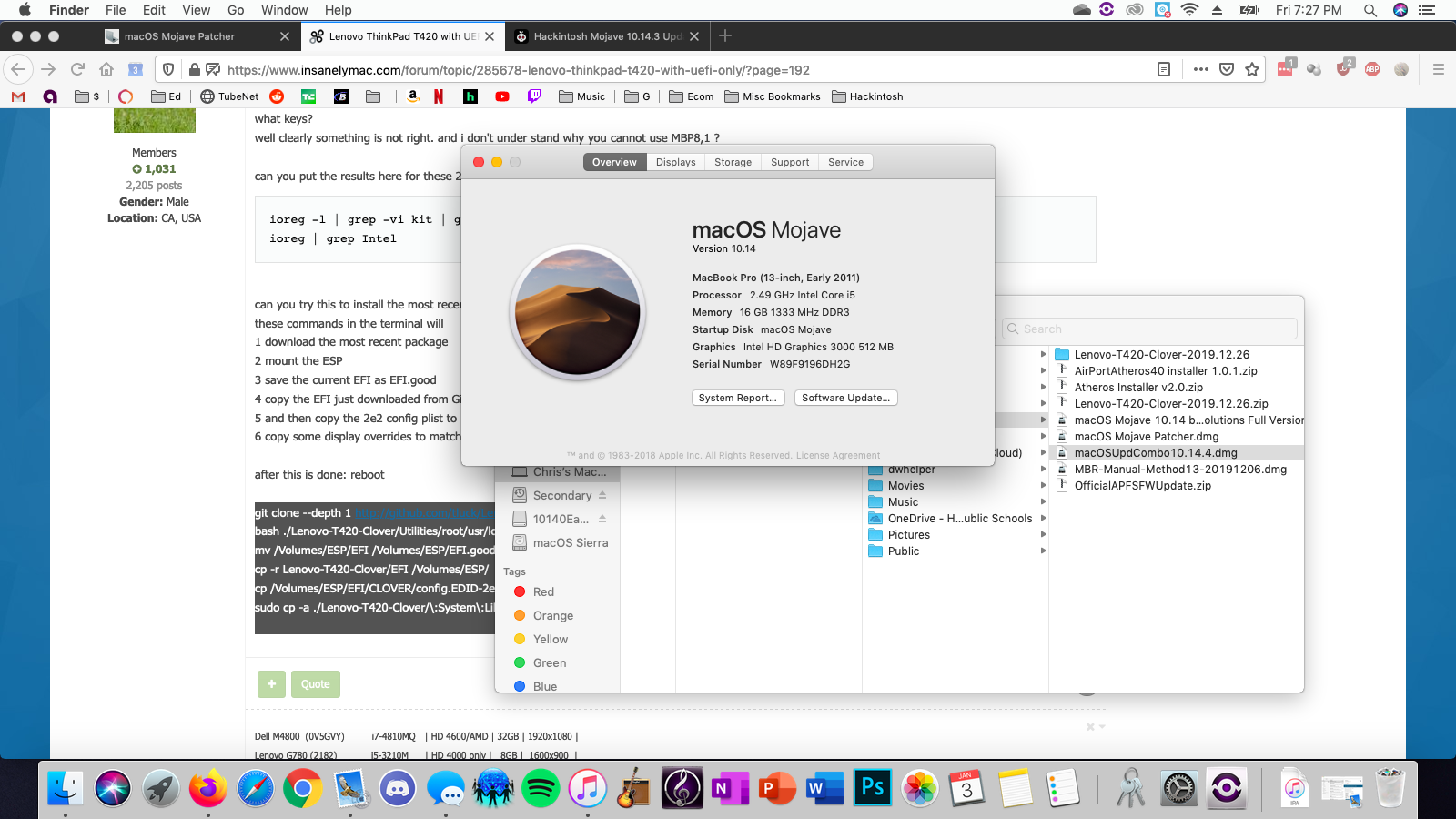

tluck Posted January 3, 2020 Share Posted January 3, 2020 4 hours ago, 80486sx said: Im not able to control brightness, getting low FPS in Minecraft, and the keybinds are annoying me what keys? well clearly something is not right. and i don't under stand why you cannot use MBP8,1 ? can you put the results here for these 2 commands: ioreg -l | grep -vi kit | grep Panel ioreg | grep Intel can you try this to install the most recent stuff?? these commands in the terminal will 1 download the most recent package 2 mount the ESP 3 save the current EFI as EFI.good 4 copy the EFI just downloaded from GitHub to your ESP 5 and then copy the 2e2 config plist to be the default 6 copy some display overrides to match the new EDID after this is done: reboot git clone --depth 1 http://github.com/tluck/Lenovo-T420-Clover bash ./Lenovo-T420-Clover/Utilities/root/usr/local/bin/espmount.bash / mv /Volumes/ESP/EFI /Volumes/ESP/EFI.good cp -r Lenovo-T420-Clover/EFI /Volumes/ESP/ cp /Volumes/ESP/EFI/CLOVER/config.EDID-2e2.plist /Volumes/ESP/EFI/CLOVER/config.plist sudo cp -a ./Lenovo-T420-Clover/\:System\:Library\:Displays\:Contents\:Resources\:Overrides/* /System/Library/Displays/Contents/Resources/Overrides/ Link to comment Share on other sites More sharing options...
namisloc Posted January 4, 2020 Share Posted January 4, 2020 (edited) It took a bit of work, but I was able to successfully install Mojave. This may seem like a noob question, but I downloaded a combo update to 10.14.4, but I'm unsure how to proceed. I should note: I used Dosdude utility/guide to create my USB, however I didn't have the update patcher (must have done something wrong when creating). I followed his guide to add the patch updater utility post-install and I now see the option to upgrade to 10.15.2, but I think I'd like to stay in mojave. Edited January 4, 2020 by namisloc Link to comment Share on other sites More sharing options...

tluck Posted January 4, 2020 Share Posted January 4, 2020 (edited) 16 hours ago, namisloc said: It took a bit of work, but I was able to successfully install Mojave. This may seem like a noob question, but I downloaded a combo update to 10.14.4, but I'm unsure how to proceed. I should note: I used Dosdude utility/guide to create my USB, however I didn't have the update patcher (must have done something wrong when creating). I followed his guide to add the patch updater utility post-install and I now see the option to upgrade to 10.15.2, but I think I'd like to stay in mojave. To stay on Mojave, you would just the install Combo Update. (presuming the post install happened and the Patcher daemon got installed) ... but your graphics does not seem to have transparency on the menu/dock so i am suspicious about whether you did the post install step: boot up dosdude install USB and run the post tool. I tend to use the full installer vs combo on the USB modified by the dosdude tools. I download the standard full install for Mojave 10.14.6 and Catalina 10.15.2 and create the USB. This way I can install the OS and then run the post install tool. Edited January 4, 2020 by tluck Link to comment Share on other sites More sharing options...

namisloc Posted January 4, 2020 Share Posted January 4, 2020 (edited) 6 hours ago, tluck said: To stay on Mojave, you would just the install Combo Update. (presuming the post install happened and the Patcher daemon got installed) ... but your graphics does not seem to have transparency on the menu/dock so i am suspicious about whether you did the post install step: boot up dosdude install USB and run the post tool. I tend to use the full installer vs combo on the USB modified by the dosdude tools. I download the standard full install for Mojave 10.14.6 and Catalina 10.15.2 and create the USB. This way I can install the OS and then run the post install tool. I realized that I downloaded all of the dosdude patcher stuff but never actually used it, I ended up using the EasyMBR installer Maker. I had a few beers that evening lol. I tried to use the Dosdude patcher originally, but after I create the USB and boot from it I end up staring at the apple load screen as it crawls to a complete bar (usually takes ~15m) and then it sits frozen at 100% loaded moving to the Mojave installer. Any ideas? I have a working 10.14, should I reinstall fresh if I get the Dosdude patcher to work or is there an easier updater? When I try to run 10.14.4 combo updater, it says "software not supported on your system". Edited January 4, 2020 by namisloc Link to comment Share on other sites More sharing options...
tluck Posted January 5, 2020 Share Posted January 5, 2020 well even if you have a "working" installation, you will still need to boot up the dosdude installer to install the postinstall patch items. i would download the full installation from here: https://support.apple.com/en-us/HT210190. then use the dosdude tool to make the USB. clover on the hd will work or drop the clover zip on the EFI and youre good to go. just boot up and you can either update or use the post-install tool. Link to comment Share on other sites More sharing options...
namisloc Posted January 6, 2020 Share Posted January 6, 2020 20 hours ago, tluck said: well even if you have a "working" installation, you will still need to boot up the dosdude installer to install the postinstall patch items. i would download the full installation from here: https://support.apple.com/en-us/HT210190. then use the dosdude tool to make the USB. clover on the hd will work or drop the clover zip on the EFI and youre good to go. just boot up and you can either update or use the post-install tool. Is there a download link that you would recommend that is not the app store? I keep getting an error from the app store when I try to download it saying "this software may not be installed on your computer". Link to comment Share on other sites More sharing options...
tluck Posted January 6, 2020 Share Posted January 6, 2020 well you can temporarily set your model to something like MPB9,1 and that is a supported model. Link to comment Share on other sites More sharing options...
