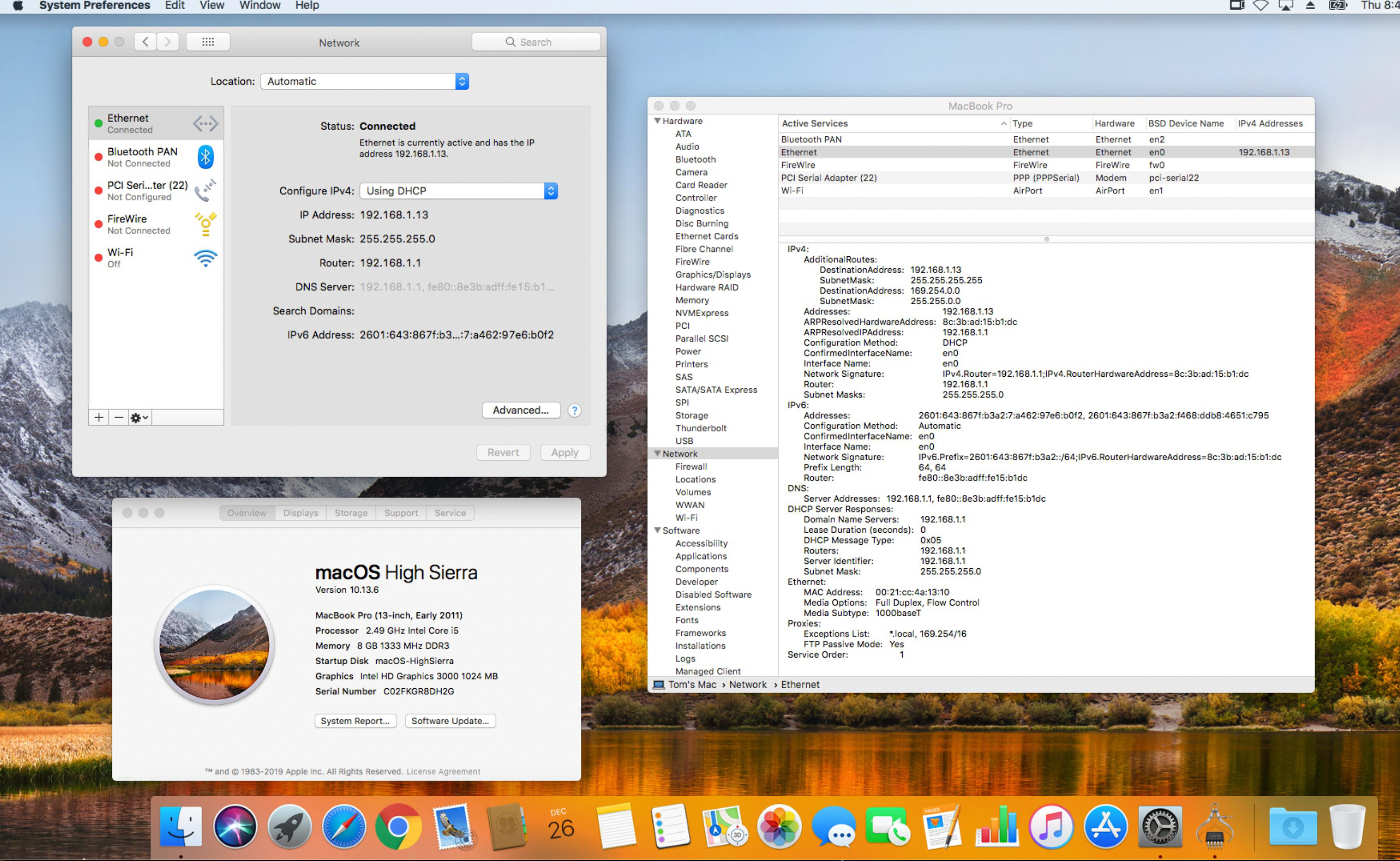

tluck Posted December 26, 2019 Share Posted December 26, 2019 2 hours ago, 80486sx said: Yeah High Sierra was working except Ethernet. I did notice though that graphics seems a little choppy, maybe the screen was in the wrong mode because the T420's screen has a 50hz and 60hz mode, and it looked like it was in 50hz mode ethernet will work now with latest pack. hmm. 50 vs 60hz should not make it choppy. check to make sure you have full gfx. LaunchPad should be nice and smooth coming and going. menu bar and dock should have transparency. etc. the About this Mac/ System report should show look something like this: -^ tluck@Toms-Mac ~ $ ioreg -l | grep HD3000 | | | | | "IOCFPlugInTypes" = {"ACCF0000-0000-0000-0000-000a2789904e"="AppleIntelHD3000GraphicsGA.plugin"} | | | | | "IOCFPlugInTypes" = {"ACCF0000-0000-0000-0000-000a2789904e"="AppleIntelHD3000GraphicsGA.plugin"} | | | | | "IOCFPlugInTypes" = {"ACCF0000-0000-0000-0000-000a2789904e"="AppleIntelHD3000GraphicsGA.plugin"} | | | | | "IOCFPlugInTypes" = {"ACCF0000-0000-0000-0000-000a2789904e"="AppleIntelHD3000GraphicsGA.plugin"} | | | | "IODVDBundleName" = "AppleIntelHD3000GraphicsVADriver" | | | | "IOGLBundleName" = "AppleIntelHD3000GraphicsGLDriver" | | | | "IOCFPlugInTypes" = {"ACCF0000-0000-0000-0000-000a2789904e"="AppleIntelHD3000GraphicsGA.plugin"} | | | | "CFBundleIdentifierKernel" = "com.apple.driver.AppleIntelHD3000Graphics" | | | | "CFBundleIdentifier" = "com.apple.driver.AppleIntelHD3000Graphics" tluck@Toms-Mac ~ $ ioreg -l | grep "model" | "model" = <"MacBookPro8,1"> | | | | "model" = <"Intel HD Graphics 3000"> | | | | "model" = <"Intel E1000e"> | | | | "model" = "Intel 82579LM PCI Express Gigabit Ethernet" | | | | "model" = <"Apple WiFi card"> | | "model" = "Disk Image Driver for MacOS X" tluck@Toms-Mac ~ $ ioreg -l | grep -v Kit | grep "IntelAccel" | | | | | "IOAccelTypes" = "IOService:/AppleACPIPlatformExpert/PCI0@0/AppleACPIPCI/IGPU@2/IntelAccelerator" | | | | | "IOAccelTypes" = "IOService:/AppleACPIPlatformExpert/PCI0@0/AppleACPIPCI/IGPU@2/IntelAccelerator" | | | | | "IOAccelTypes" = "IOService:/AppleACPIPlatformExpert/PCI0@0/AppleACPIPCI/IGPU@2/IntelAccelerator" | | | | | "IOAccelTypes" = "IOService:/AppleACPIPlatformExpert/PCI0@0/AppleACPIPCI/IGPU@2/IntelAccelerator" | | | +-o IntelAccelerator <class Gen6Accelerator, id 0x1000003e8, registered, matched, active, busy 0 (0 ms), retain 49> Link to comment Share on other sites More sharing options...

tluck Posted December 27, 2019 Share Posted December 27, 2019 (edited) 2 hours ago, 80486sx said: Whats really bothering though is how I have to delete all the boot args and change the SMBIOS every time i boot, something that is still happening on the new version what do you mean - change the SMBIOS and delete the boot args? copy the zip to /Volumes/ESP/EFI copy config.EDID-2e2.plist to config.plist does the IntelMausiEthernet kext load? Edited December 27, 2019 by tluck 1 Link to comment Share on other sites More sharing options...

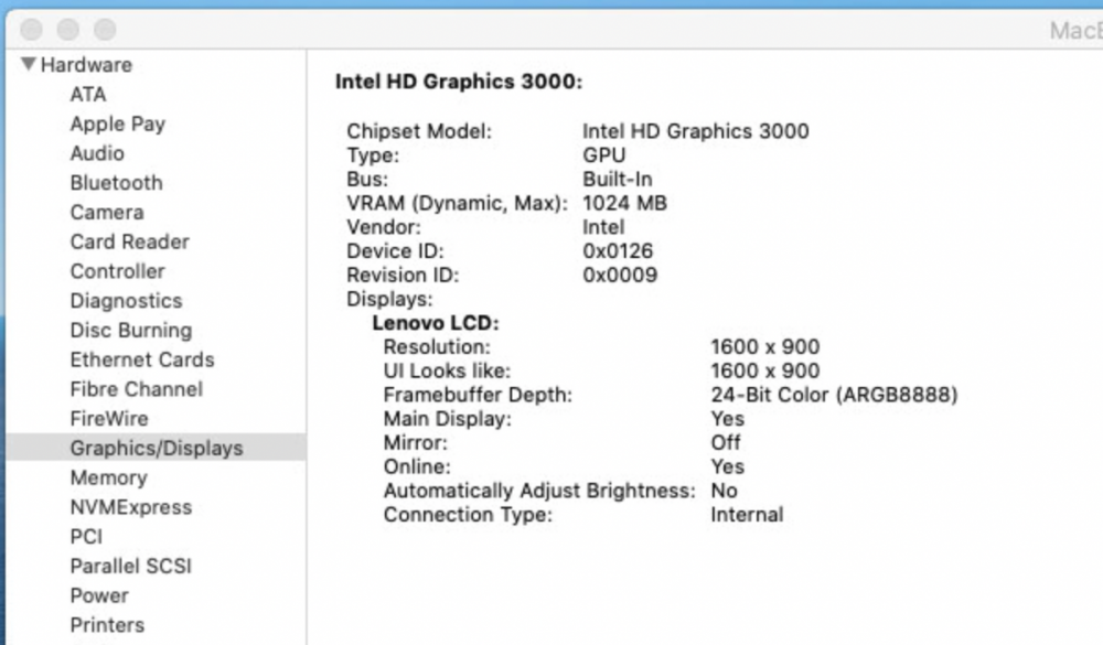

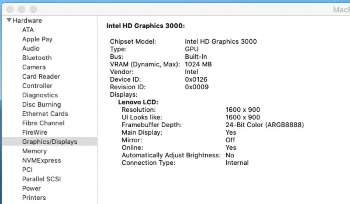

tluck Posted December 27, 2019 Share Posted December 27, 2019 3 hours ago, 80486sx said: Okay heres the thing. even when using config2e2 it doesn't boot unless I delete the -no_compat_check boot argument and set the smbios to MacBookPro10,1 Also when I am in Network settings Ethernet doesn't show up heres the thing from my point of view: can you collect some information? does your system have Nvidia gfx? what gfx is showing when you use MBP10,1 ? if you boot with MBP8,1 and use -v or -x ... does it get running? can you be more specific on what doesn't boot mean? does nothing? or stops at some point? does show a black screen or apple logo not completing? run these: kextstat | grep -i mausi kextstat | grep -i graphics if you see that IntelMausi kext is running, then delete and re-create your ethernet interface. Link to comment Share on other sites More sharing options...
80486sx Posted December 27, 2019 Share Posted December 27, 2019 (edited) Sorry I wasn't being specific. Ill run those commands in a little while but I'll give you more info. My system on has the intergrated graphics, when I boot it with the MBP10,1 it shows HD Graphics 3000. Normally when it boots the loading bar goes halfway, then it goes to the login screen, what happens now is the bar goes halfway, then goes to a black screen and hangs there EDIT Ok i booted it with -v and -x like you said and it hangs on "Wating for DSMOS" EDIT 2 If I remove -no_compat_check it doesn't change anything in safe mode but in normal mode it gets passed DSMOS and then goes to a black screen EDIT 3 tried again in safe mode and it got passed DSMOS, but then it goes to a black screen after the verbose stuff Edited December 27, 2019 by 80486sx Link to comment Share on other sites More sharing options...

tluck Posted December 27, 2019 Share Posted December 27, 2019 (edited) you don't have to copy anything to the OS folders. just leave kexts in the ESP/EFI location. but if you do then use /Library/Extensions what does this mean? I did the commands you said and the kext doesn't work still does the kext load when using the commands above? does it show up when you run: kextstat | grep -i Mausi if so then create the Ethernet in the Sys Prefs. Edited December 27, 2019 by tluck 1 Link to comment Share on other sites More sharing options...

80486sx Posted December 27, 2019 Share Posted December 27, 2019 I fixed it!!!, the ethernet kext you included was broken so I downloaded RehabMan's one and now its working! Link to comment Share on other sites More sharing options...

tluck Posted December 28, 2019 Share Posted December 28, 2019 3 hours ago, 80486sx said: I fixed it!!!, the ethernet kext you included was broken so I downloaded RehabMan's one and now its working! no it's not broken - i include the kext from the author. and i just downloaded the full pack (dated on the 26th) from github and it worked for me on 10.13.6, 10.14.6, and 10.15.2 but glad you found something that works for you. anything to do with the keyboard is from VoodooPS2Controller kext. you can edit the plugin Info.plist to suit your needs. and what other minor issues did you run in to? Link to comment Share on other sites More sharing options...

tluck Posted December 28, 2019 Share Posted December 28, 2019 (edited) 17 minutes ago, 80486sx said: Never mind about M U L I T I B E A ST. Some of the other issues include not being able to control brightness, and low FPS compared to windows in a game i tested (Minecraft) Thanks for all the help BTW If you cannot control brightness, and. slow FPS wonder if you do not have full gfx? if you boot with MBP10,1 it probably wont be. what resoution is your screen? Edited December 28, 2019 by tluck Link to comment Share on other sites More sharing options...
