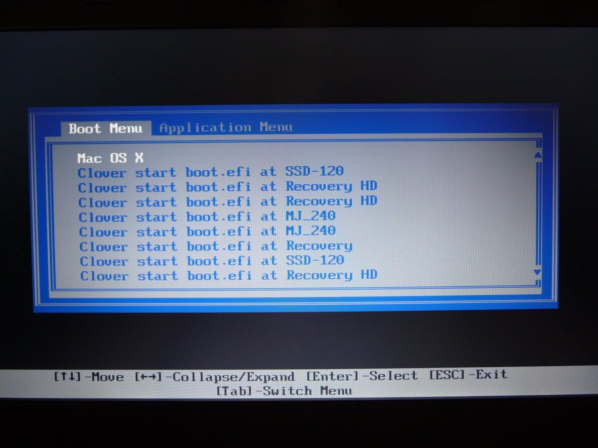

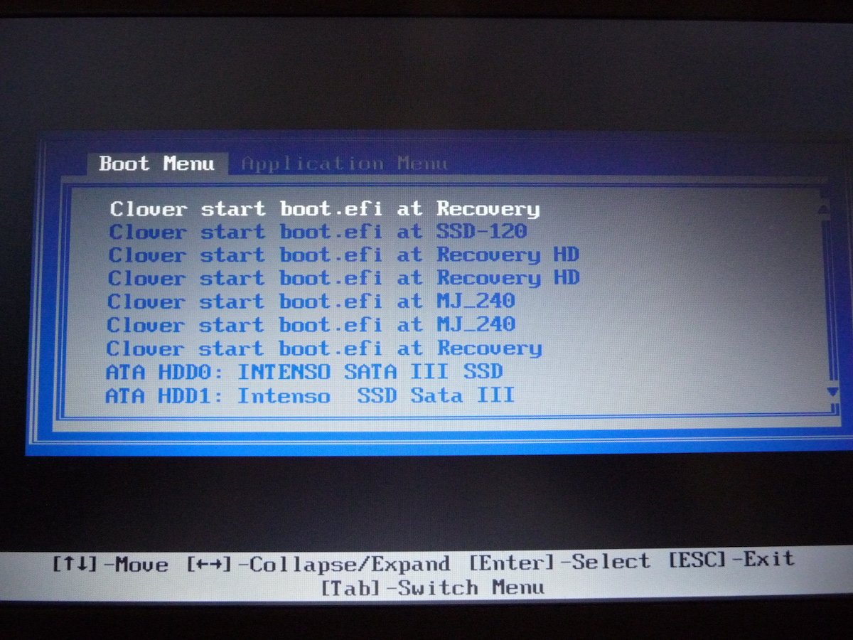

One thing is somewhat annoying though. I tried upgrading three times an now my BIOS boot screen is crowded like this:
How can I clean up that? (SSD-120 and MJ_240 are the two SSDs installed.)

Cleaning up the boot devices goes like this, just to let you know. ;)
t3chman posted this in the Lenovo forums in 2013.
Quote
Ladies and Gentlemen...  I have the solution you have been looking for:
Go to the BIOS Setup page.
In the BIOS page go to the "Startup." tab.
Press, "Enter, (the, "Boot," option should be hilighted)."
Now... You don't see the USB device listed, huh?
Press, "F9," for, "Setup Defaults."
A dialogue will appear that asks, "Setup Confirmation.  Load default configuration now?" To which you will press enter for, "Yes."
After you do this ALL of the bootable devices should appear.  I went from only seeing two devices to seeing 12 devices.  If your USB jump drive is in, it should display the make/model of the USB device too.  You can then press the +/- keys to move that deviceto the top of the list.
Note 1:  I am running BIOS version 1.38.
Note 2: I signed up for this forum just so that I could share this information with you because I couldn't find it anywhere else online. :-)
Clover can remove these Clover boot options.
boot to clover and stop... and then move down to Clover boot options with arrow key and then it will be obvious.
