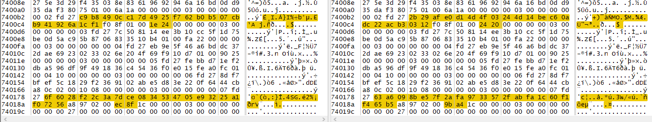

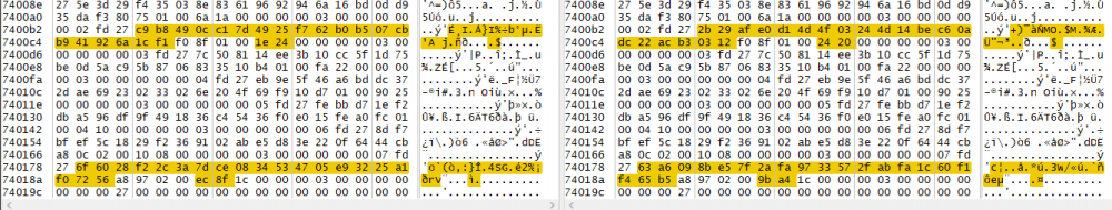

ludufre Posted January 21, 2019 Share Posted January 21, 2019 (edited) With the wireless whitelist removal some AMT features are also disabled with the mod and on some Lenovo you get 5 beeps (twice) on boot. This is because of RSA signature that as verified on boot. I can fix that. If anyone want, send me the DUMP of the current patched BIOS. Soon I will make a guide so you can do it alone. [EDIT] Edited January 22, 2019 by ludufre 2 Link to comment Share on other sites More sharing options...

tluck Posted January 22, 2019 Share Posted January 22, 2019 2 hours ago, ludufre said: With the wireless whitelist removal some AMT features are also disabled with the mod and on some Lenovo you get 5 beeps (twice) on boot. This is because of RSA signature that as verified on boot. I can fix that. If anyone want, send me the DUMP of the current patched BIOS. Soon I will make a guide so you can do it alone. huh, i was wondering why i get that from time to time! i thought maybe it was my MoBo clock battery i am on 1.46 mod for T420 - but some are on a later 1.48 mod and maybe 1.52... see this file: https://drive.google.com/open?id=15KmNGZkoJ1ToTyHDfvp9Uu55Xk3tOR-S 2 Link to comment Share on other sites More sharing options...

ludufre Posted January 22, 2019 Share Posted January 22, 2019 (edited) 17 hours ago, tluck said: huh, i was wondering why i get that from time to time! i thought maybe it was my MoBo clock battery i am on 1.46 mod for T420 - but some are on a later 1.48 mod and maybe 1.52... see this file: https://drive.google.com/open?id=15KmNGZkoJ1ToTyHDfvp9Uu55Xk3tOR-S @tluck Fixed your BIOS signature: https://www.sendspace.com/file/w9cafl I could not understand how you are flashing your BIOS, this file was inside the folder: 83ET76WW/ [EDIT] Two volumes on BIOS has been fixed: Edited January 22, 2019 by ludufre 1 1 Link to comment Share on other sites More sharing options...

ludufre Posted January 22, 2019 Share Posted January 22, 2019 2 hours ago, ludufre said: @tluck Fixed your BIOS signature: https://www.sendspace.com/file/w9cafl I could not understand how you are flashing your BIOS, this file was inside the folder: 83ET76WW/ [EDIT] Two volumes on BIOS has been fixed: @tluck More info in my guide: 2 Link to comment Share on other sites More sharing options...
