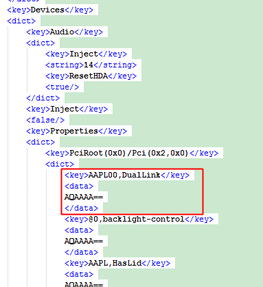

I am having the same issue, after I started using the mojave plist. I see a blank screen after boot up, but I can see the HDD light flickering. I am still on High Sierra. Can you tell me how you change the default screen resolution to 1600X900  ?
I am using T420 (4177CTO)  I5 Sandybridge HD 3000 with 16GB RAM 1600x900 screen

My screen is also 1600*900 and I use release 2018.10.12. I add this to config.mojave.plist in devices/properties:
<key>AAPL00,DualLink</key>
<data>
AQAAAA==
</data>
Edited by tonyyang123
Sorry - Somehow i lost that item in config.mojave.plist from the latest release. i will add it back for a 1600x900 version.
            <key>PciRoot(0x0)/Pci(0x2,0x0)</key>
            <dict>
                <key>#AAPL00,DualLink</key>
                <data>
                AQAAAA==
            </data>
