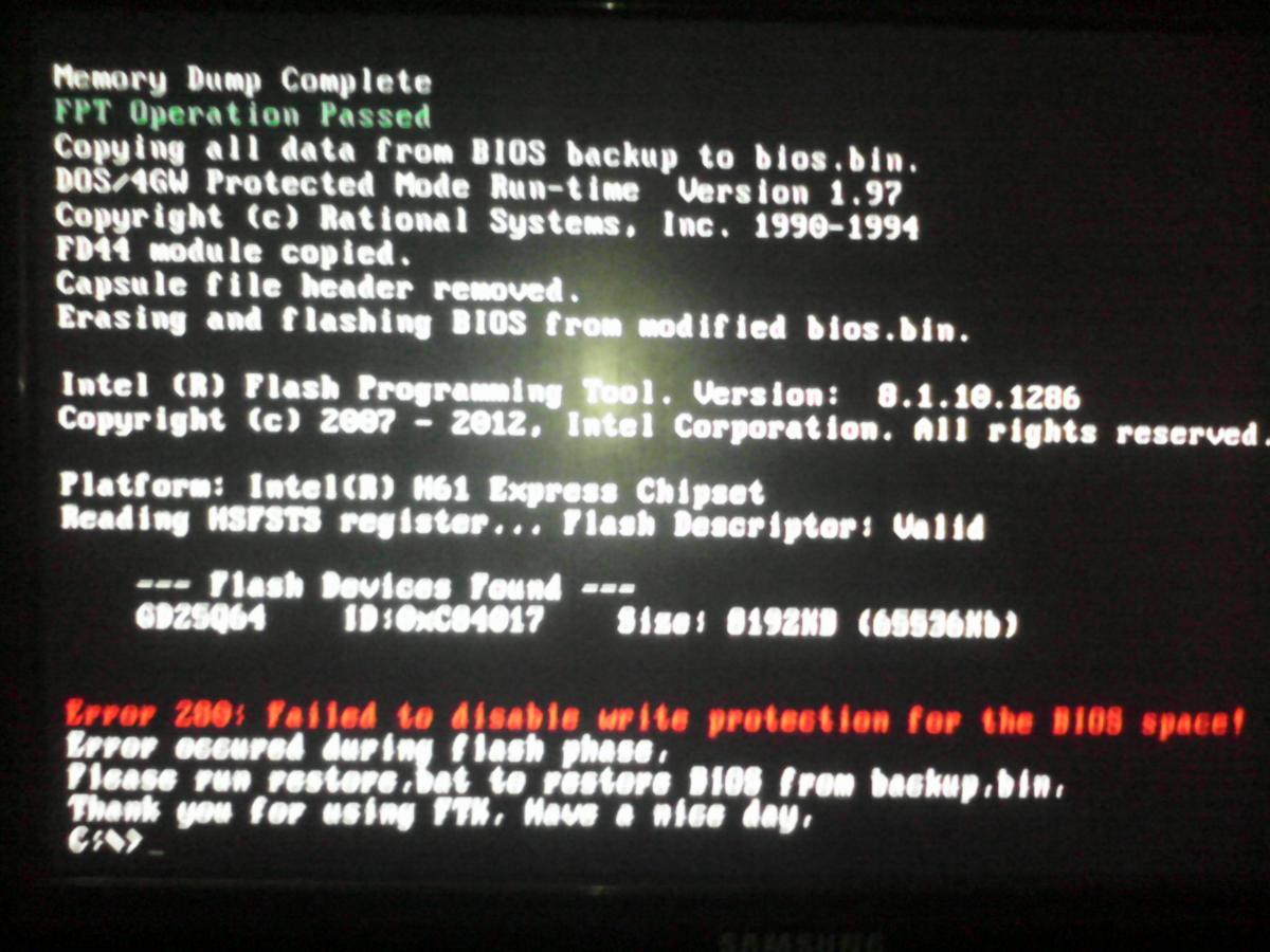

Please accept my appreciation for all of your projects. On your guide post, at http://www.insanelymac.com/forum/topic/285444-pmpatch-uefi-patching-utility/page-10?&&do=findComment&comment=1893689, you had said, ¨If you see any errors, make a photo from your screen and post it here, I will try to help.¨ Below is my photo, please help.
I´m attempting, for the very first time, to make a Hackintosh (Mavericks) on a desktop PC, with an Asus H61M-CS motherboard, Intel i3-3220 processor, Asus GeForce 210 graphics card, Seagate 500 GB hard disk, 8 GB (2 x 4) RAM. The BIOS version is ¨0503 x64¨, and ME version is 8.1.2.1310. The H61M-CS motherboard has no USB BIOS flashback button, so I downloaded the 0503 BIOS file (still the latest BIOS version) from the Asus website.
I downloaded UEFIPatch 0.3.5 for Windows from your github page, and successfully patched the BIOS file on a Windows 7 (32 bit) PC, then renamed it as bios.bin. I then downloaded FTK from your github page, and as suggested there, I downloaded from Fernando´s win-raid forum the following: FPT for DOS (from ME System Tools v8.1 r5), MEInfo (for ME 8 Firmware v8.1.56.1541) and FWUpdLcl (for ME 8 Firmware v8.1.40.1456). I then loaded all files on the root folder of a DOS bootable USB drive, created with Rufus.

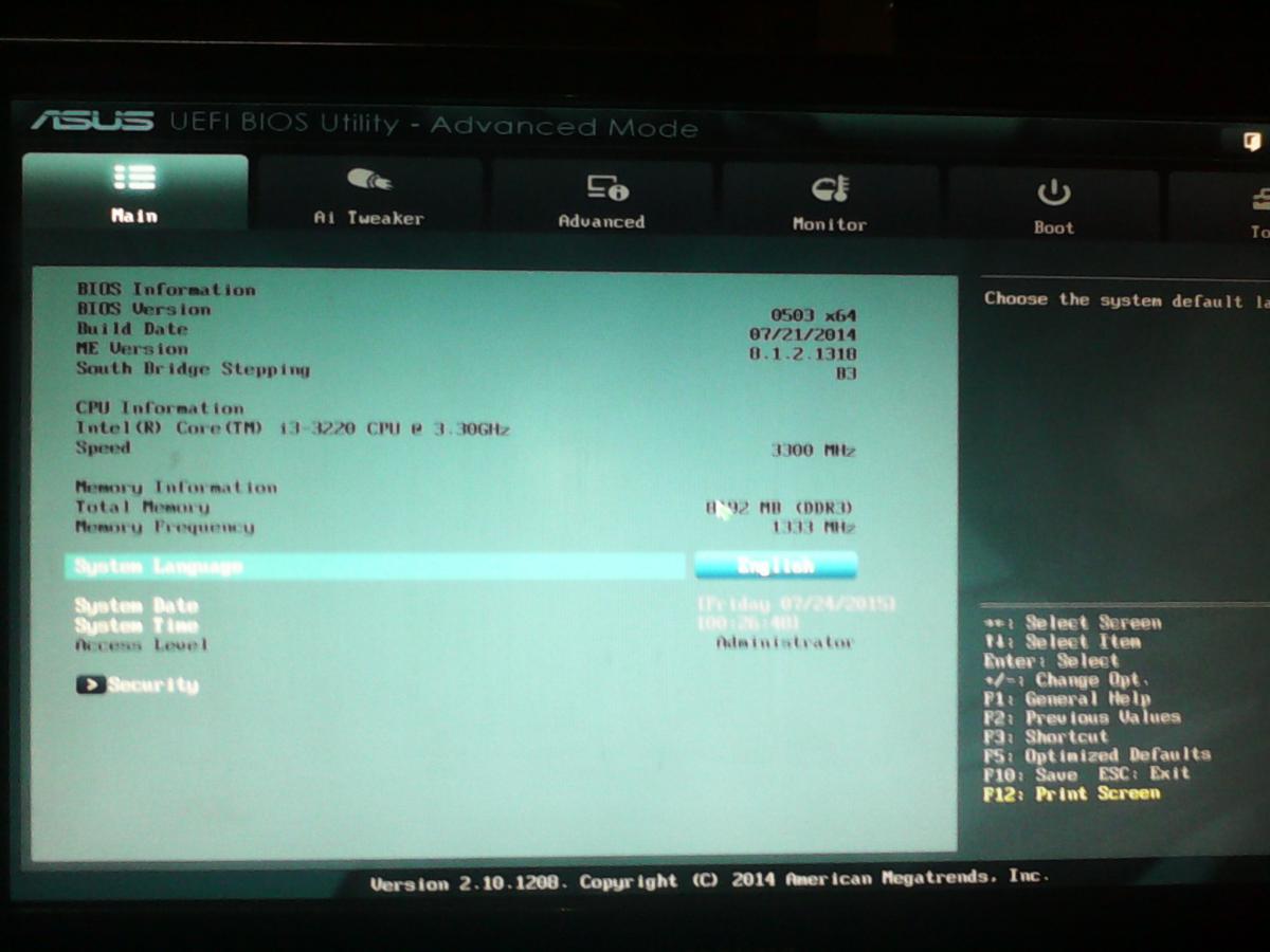

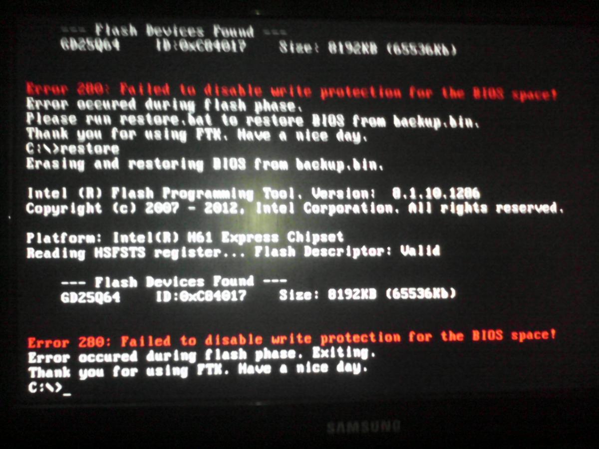

On the Hackintosh PC, I successfully booted into DOS from the USB drive (F8 > non-UEFI), typed ¨reflash¨ and hit enter. The FPT operation passed successfully, but Error 280 occurred during the flash phase: ¨Failed to disable write protection for the BIOS space!¨ (see Photo 1). As suggested, I typed ¨restore" and hit enter. Again I received Error 280, followed by ¨exiting¨ (see Photo 2). Fearing disaster, I ejected the USB drive, rebooted the PC and opened the BIOS screen, but BIOS version and ME version are unchanged (see Photo 3).
This same issue was raised on 02-03-2014 at http://www.tonymacx86.com/bios-uefi/43486-asus-1155-patched-bios-repository-109.html#post756294, but there was no solution. Is the risky approach that you described at http://www.insanelymac.com/forum/topic/285444-uefipatch-uefi-patching-utility/page-2?do=findComment&comment=1882367 the only way to solve Error 280? Please help. I hope I haven´t made some silly mistake somewhere, and wasted your valuable time. Thank you.
@pongal, all UEFI versions for this motherboard are having BIOS Lock enabled, so if you don't want a risky way, buy yourself a cheap CH341A-based SPI programmer (around $5 on Ebay) and forget about all that BIOS Lock stuff.
