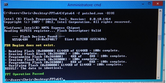

chriz74 Posted February 6, 2015 Share Posted February 6, 2015 I think I finally removed MSR lock from my x301a Asus laptop! I used FPTw64 to dump and reflash the bios! I followed this guide: http://www.overclock.net/t/1493245/asus-g75vx-unlock-system-bios-nvidia-gtx-670mx-custom-vbios-tutorial-how-to First I dumped the bios with the command fptw64 -d BIOS-Backup.rom -BIOS then I used uefipatch to patch the dumped rom and renamed it patched.rom then I reflashed the bios using this command fptw64 -f patched.rom -BIOS then I shut down the laptop, removed power chord and battery and pressed down the power button for 30 secs. Restarted the laptop and entered the bios to reload setup defaults. Now with read write everything I can see that the bit at 15 in 0xE2 is set to 0 ! So this means it's unlocked right?? --- update --- I tried to dump the bios again and to apply the patch with uefipatch and now the result is "nothing to patch"! So the lock is really gone!! GREAT!!! I attached picture of the flashing operation. 1 Link to comment Share on other sites More sharing options...

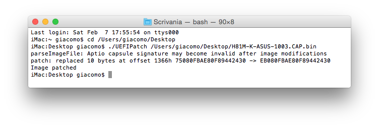

giacomoleopardo Posted February 7, 2015 Share Posted February 7, 2015 Dumb question for Coderush: I've noticed here you explained UEFIPatch Windows usage, here UEFITool Windows and OS X usage, but I wonder how to use UEFIPatch in OS X. I can't quite find some instruction. Thanks for your effort. Link to comment Share on other sites More sharing options...
CodeRush Posted February 7, 2015 Author Share Posted February 7, 2015 @giacomoleopardo, unpack, open terminal, got to the folder with UEFIPatch and patches.txt file and invoke ./UEFIPatch path/to/your/bios.bin @chriz74, cool. Link to comment Share on other sites More sharing options...

giacomoleopardo Posted February 7, 2015 Share Posted February 7, 2015 @giacomoleopardo, unpack, open terminal, got to the folder with UEFIPatch and patches.txt file and invoke ./UEFIPatch path/to/your/bios.bin Nice and easy. Thanks again Link to comment Share on other sites More sharing options...
