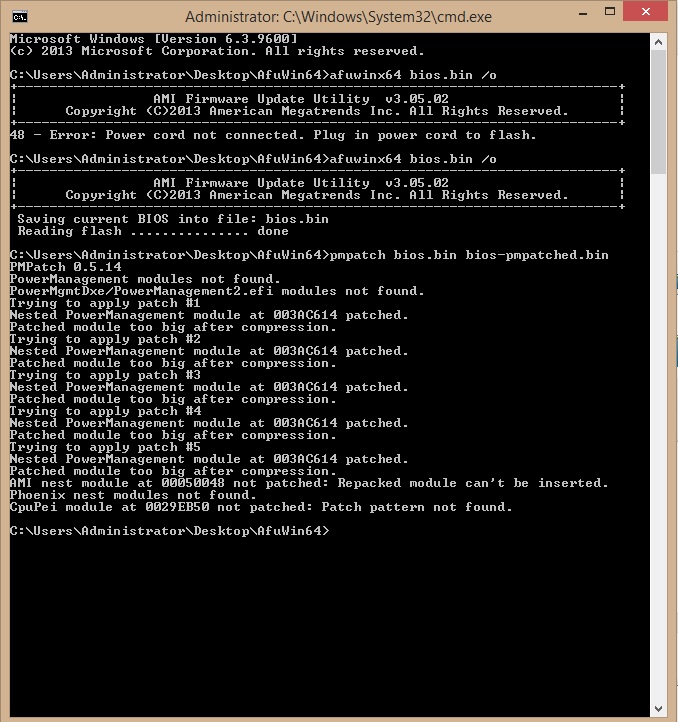

tried to patch my MSI GT60 0ND Bios but it says
PMPatch 0.5.14
PowerManagement modules not found.
PowerMgmtDxe/PowerManagement2.efi modules not found.
Trying to apply patch #1
Nested PowerManagement module at 0033986C patched.
Patched module too big after compression.
Trying to apply patch #2
Trying to apply patch #3
Trying to apply patch #4
Trying to apply patch #5
AMI nest module at 00520048 not patched: Repacked module can't be inserted.
Phoenix nest modules not found.
CpuPei module at 0079CC70 not patched: Patch pattern not found.
any tips?
btw. my biosfile is 8.192kb big
