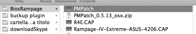

Hi Coderush i have try again with new bios 4206 (Asus Rampage 4 Extreme)
Look here please correct patched?
Of course now update with USB Flash Back
Last login: Sun Aug  4 21:42:52 on ttys000
carmine-pc:~ magnifico$ /Users/magnifico/Desktop/BiosRampage/PMPatch /Users/magnifico/Desktop/BiosRampage/Rampage-IV-Extreme-ASUS-4206.CAP /Users/magnifico/Desktop/BiosRampage/R4E.CAP
PMPatch 0.5.13
PowerManagement modules not found.
PowerMgmtDxe/PowerManagement2.efi modules not found.
AMI nest modules not found.
Phoenix nest modules not found.
CpuPei module at 0079EEC8 patched.
CpuPei module at 007DEEC8 patched.
Output file generated.
I wait..thanks Carmine
