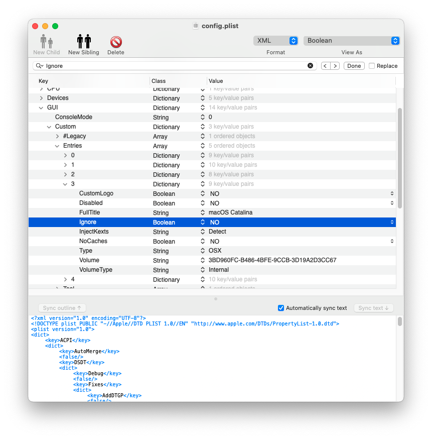

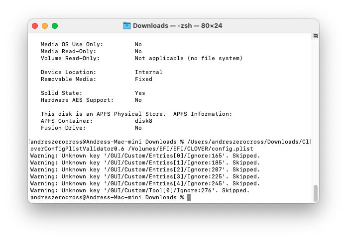

Hello Jief_Machak
i tried your app and this is the result
fabio@iMac-di-Fabio ~ % /Users/fabio/Desktop/CloverConfigPlistValidator0.6 /Users/fabio/Desktop/Clover/config.plist
Warning: Unknown key '/ACPI/DSDT/DropOEM_DSM:13'. Skipped.
Warning: Unknown key '/GUI/Custom/Entries[0]/Ignore:420'. Skipped.
Warning: Unknown key '/GUI/Custom/Entries[1]/Ignore:436'. Skipped.
Warning: Unknown key '/GUI/Custom/Entries[2]/Ignore:450'. Skipped.
Warning: Unknown key '/GUI/Mouse/DoubleClick:478'. Skipped.
Warning: Unknown key '/KernelAndKextPatches/KernelCpu:559'. Skipped.
Warning: Unknown key '/Quirks/DisableRtcChecksum:627'. Skipped.
1 hour ago, Alpha22 said:
Hello Jief_Machak
Yep, useless keys, if I'm not mistaken.

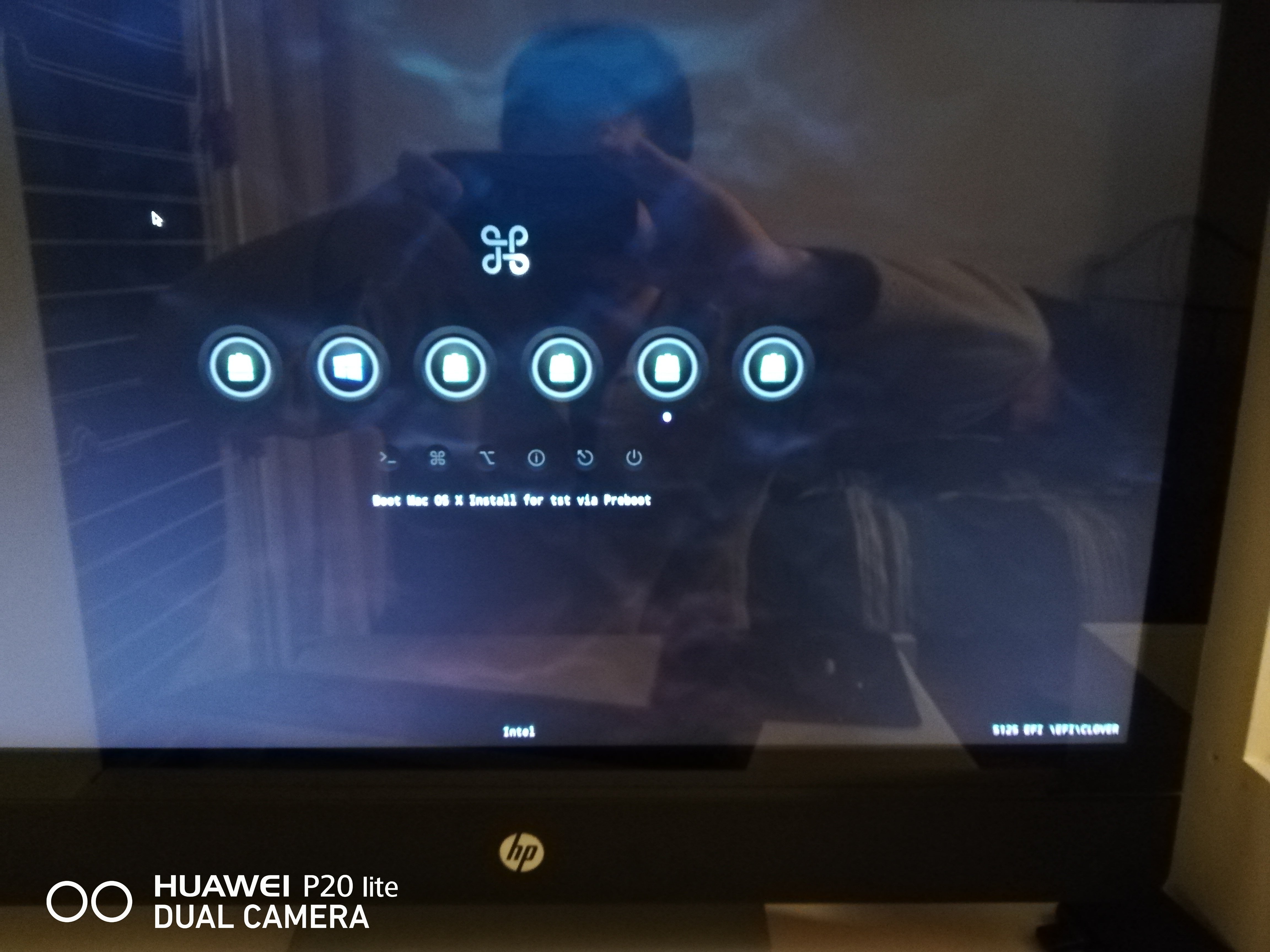

In HP notebook, only there "OS Boot Manager" as UEFI Entry boot, And i have single Disk with Windows and macOS.
I have copy CloverX64.efi to EFI/Microsoft/Boot and rename the original "bootmgfw.efi" to "bootmgfw-orig.efi" then rename "CLOVERX64.efi" to "bootmgfw.efi"
But, in 5125 (I don't test it in 5124, 5122 is still normal) it doesn't work anymore.
The config.plist is not recognized,, and i got default theme loaded by this method.
I revert back to 5122,, please @Jief_Machak give solution
Can you give us preboot.log to see what is the problem this way?
Clover is now getting all its files from where the efi is in. So if you put Clover in "EFI/Microsoft/Boot", you have to put config.plist, kexts dir etc. in that dir.
1 hour ago, kushwavez said:
bcdedit /set {bootmgr} path \EFI\CLOVER\CLOVERX64.efi
I didn't know that, but it's interesting.
That said, you have a much simpler solution that will also bring you new possibilities : BootLoaderChooser (https://github.com/jief666/BootloaderChooser/releases)
You put that BootX64.efi in EFI/Microsoft/Boot, rename it "bootmgfw.efi" if you need to. Next reboot, you'll have a text menu. Choose your Clover wherever is it. Next reboot you won't see that text menu unless you boot when a key kept pressed down.
This allows you to have multiple Clover folder AND multiple Clover efi file inside each Clover folder.

3 hours ago, Slice said:
No serious problem. It is working method.
Sorry, i have pressed F2 in GUI CLOVER, but when i checked to EFI/CLOVER/misc,, there is no Preboot.log.
And i try to use this method to my PC (Copy CLOVERX64.efi to Microsoft/Boot folder and rename it to bootmgfw.efi and change original bootmgfw.efi to bootmgfw-orig.efi) and got some problem.
Btw, F2 didn't give any output to EFI/CLOVEr/Misc
enable debug in boot tab
