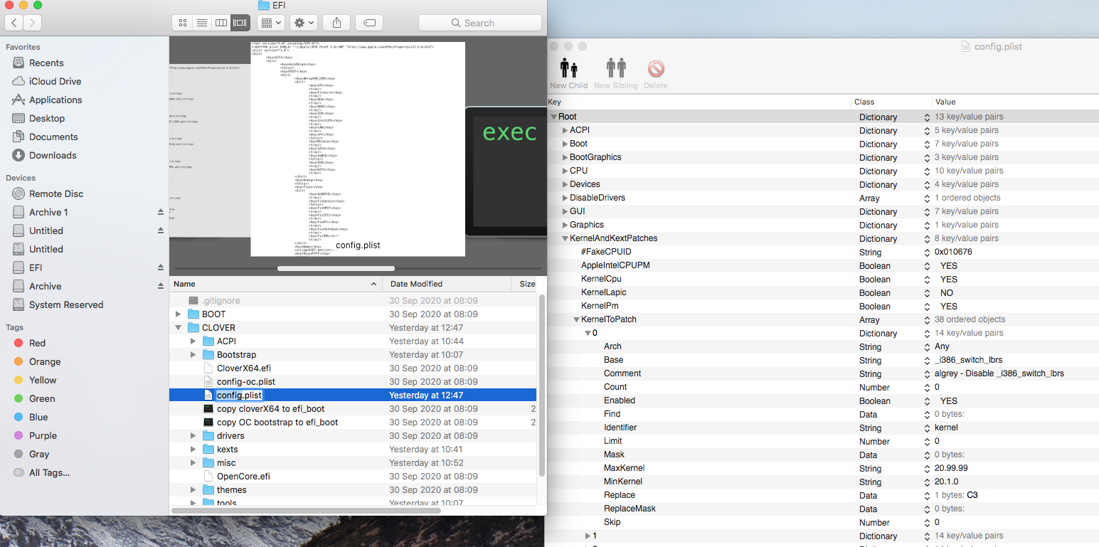

With Clover 5120 (OcQuirks.efi - Ocquirks.plist - OpenRuntime.efi) rev. 24, I was able to start catalina and high sierra my ryzen 3950x on MSI X570 Unify
Now with Clover 5122-ocint-3009.3 the way to inject kernel patches has remained the same as previous Clover or has taken oc's method of inserting such patches???
@iCanaroI have tested both (clover experimental patches and the same I am using with success in opencore)
I have not followed new clover boot loader progress but I think for my AMD platform problem is related to EFI drivers

First I need to modify my Clover config for AMD then adjust quirks then I’ll try adding in the kernel patches from OC and see how it goes on my build.

Can anyone share a config.plist for clover for AMD. I’m not sure where to place the kernel patches. My first attempt got stuck pretty soon after selecting boot drive.
I’ll also recheck my quirks.

if you try to modify and add to test one kernel patch you will understand how to add
and if you see in my log the patches are loaded for proper system..so that injection works ;)

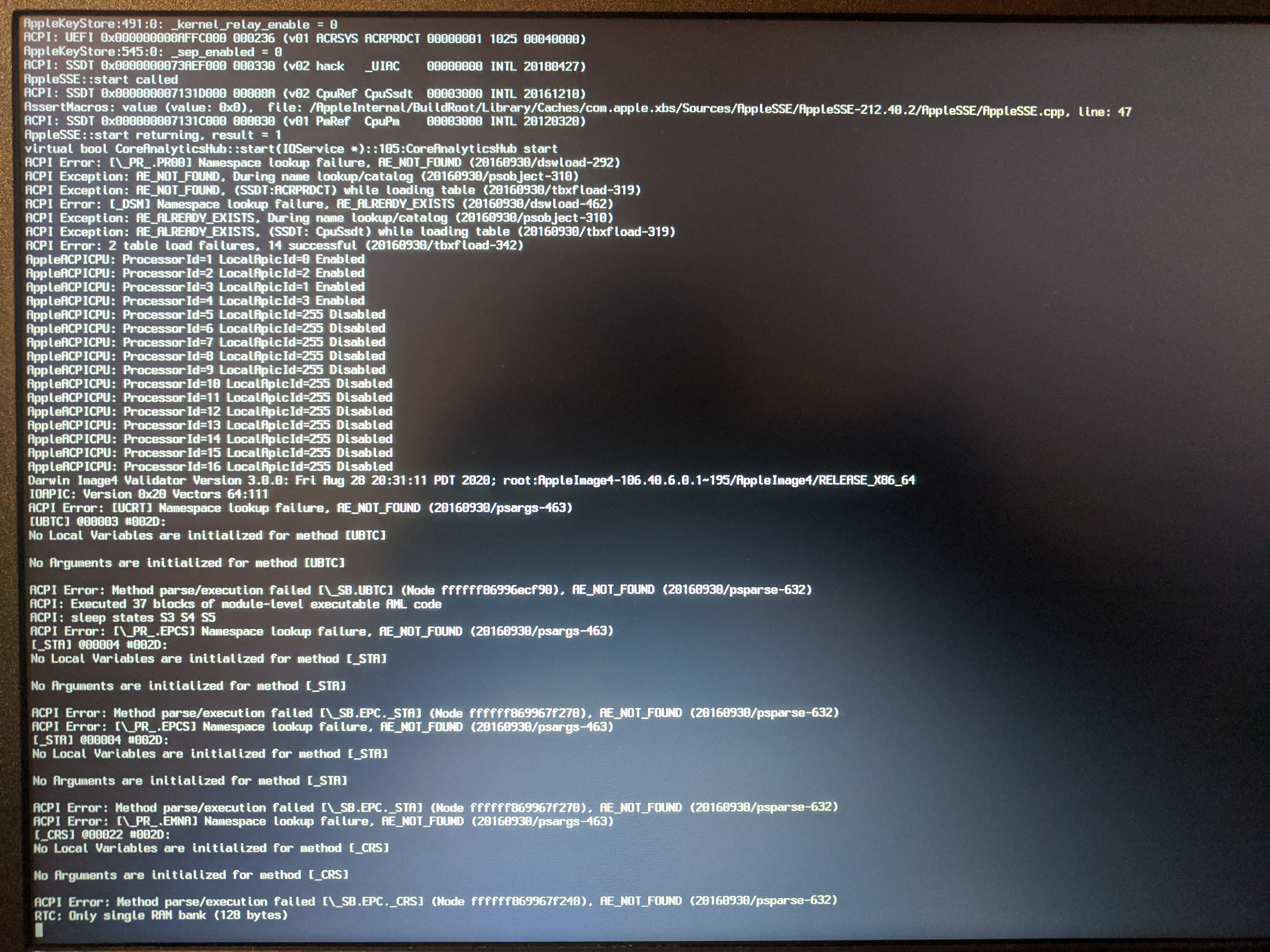

The release version, I have a freeze on startup (both with VirtualSMC and FakeSMC)
The debug version, starts normal, but my processor is not shown in the "system information"
  • Thanks 1

Release - Stuck on STARTBS
debug-release.log
Debug - Boots Big Sur and Catalina fine.
debug.log
