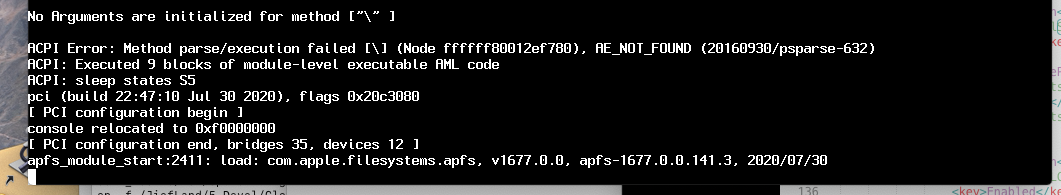

0:710  0:001  Hiding entries with string Preboot
next line should be
0:744  0:002  === [ LoadDrivers ] =============================
but absent.
Is this problem still there ?

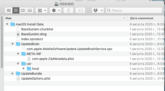

45 minutes ago, Jief_Machak said:
I read somewhere that the main problem is to boot Big Sur installer.
Which patch are needed to boot ?

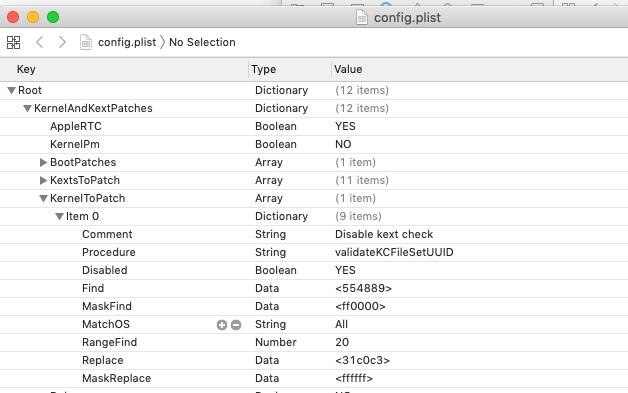

Attached kernel patches screenshot (22-08-2020) update for BS Beta 5
Spoiler
3 minutes ago, MICKHAEL said:
Thanks. Please attach plist. It's way better than screen
I know that, you're right. This screenshot came from Hackintosher-forum.de :) I've to create a plist file ASP
This time, attached plist file from kernel patches screenshot (22-08-2020) update for BS Beta 5
It seems to be the same that @MICKHAEL except 11.0 instead of 10.16
config_KernelAndKextPatchesONLY.plist
Edited by Matgen84
