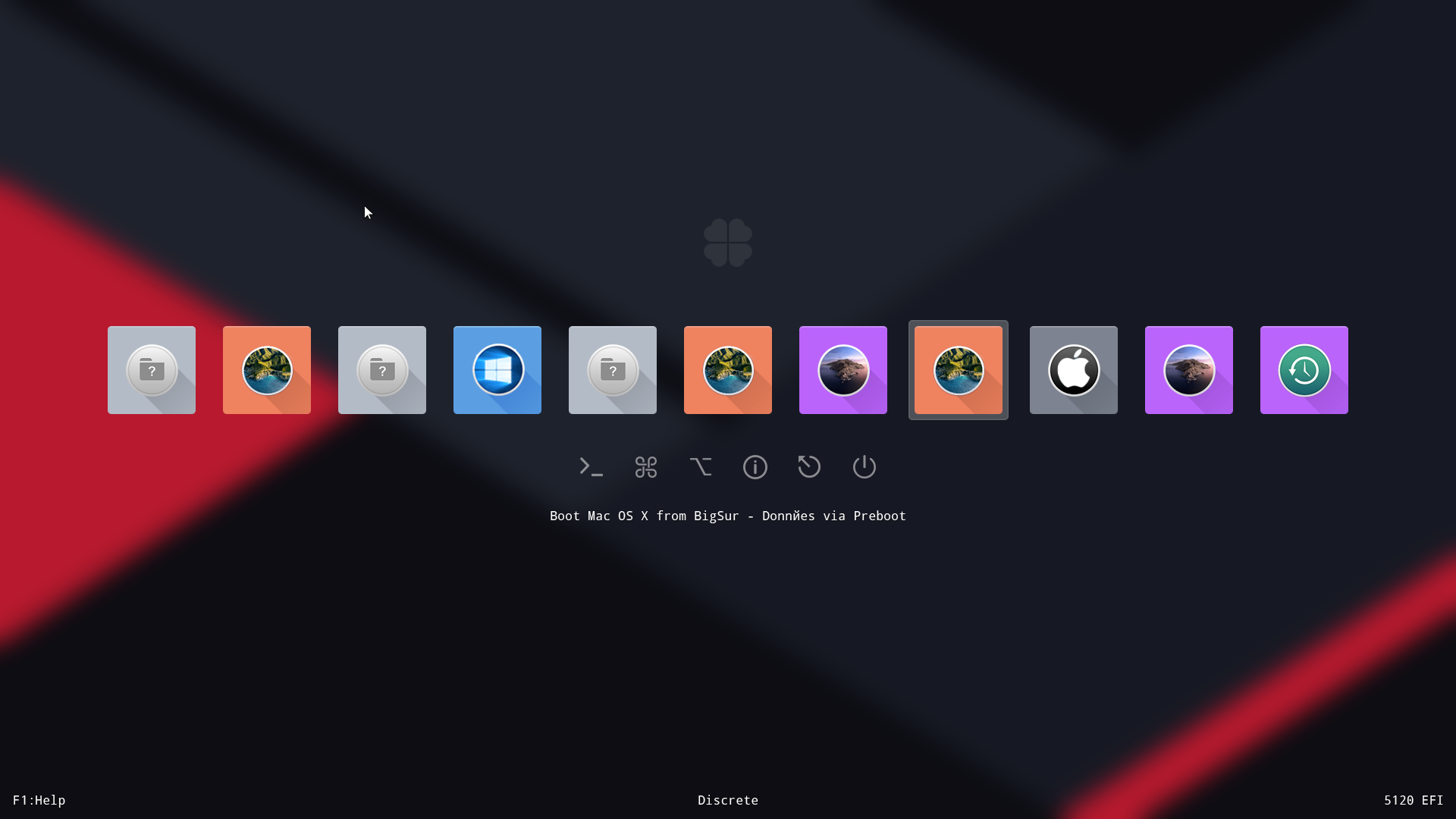

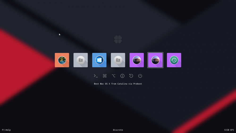

In the last few days, I did some rework about APFS bootable volume detection. I'd like to share so if there is a regression, you know where it may come from.
Before there was an "APFSUUIDBank" where all folder from Preboot and Recovery were stored. Problem with that was wrong version information, wrong icon, if, for example, your Preboot contains 3 different macOs version to boot. Title weren't great as it was something like "Boot Mac OS X from Preboot".
Now, APFS detection is made at ScanVolume. APFS Preboot and recovery can contains folders whose name are an UUID. I called this UUID a "APFS target UUID". Booting through one of these folder end up having the volume with this "target UUID" as root volume. These target UUID are stored in ApfsTargetUUIDArray in REFIT_VOLUME structure.
In ScanLoader(), a loader entry is created for each target UUID from ApfsTargetUUIDArray.
Let me know if something is wrong.
  • Like 8
Covid-19 are dead, but I'm still connected to an oxygen machine. I have to rest after having gone to the toilet, because my lungs are not able to replace the oxygen that I used to stand up for 3 minutes ! Seems that it's because my lungs are surrounded by dead cells (covid and anti-bodies), which means it's supposed to clear with time.
So yes, ware is over, but recovering will take time.
Good news is : I can sit in front of my computer :)
On my last commit, I removed the hard coded Preboot and Recovery partition names. So now, you can rename these partition. New name will appear at Clover menu. For example : Boot Mac OS X from [target partition] via [preboot partition name].
  • Like 6
