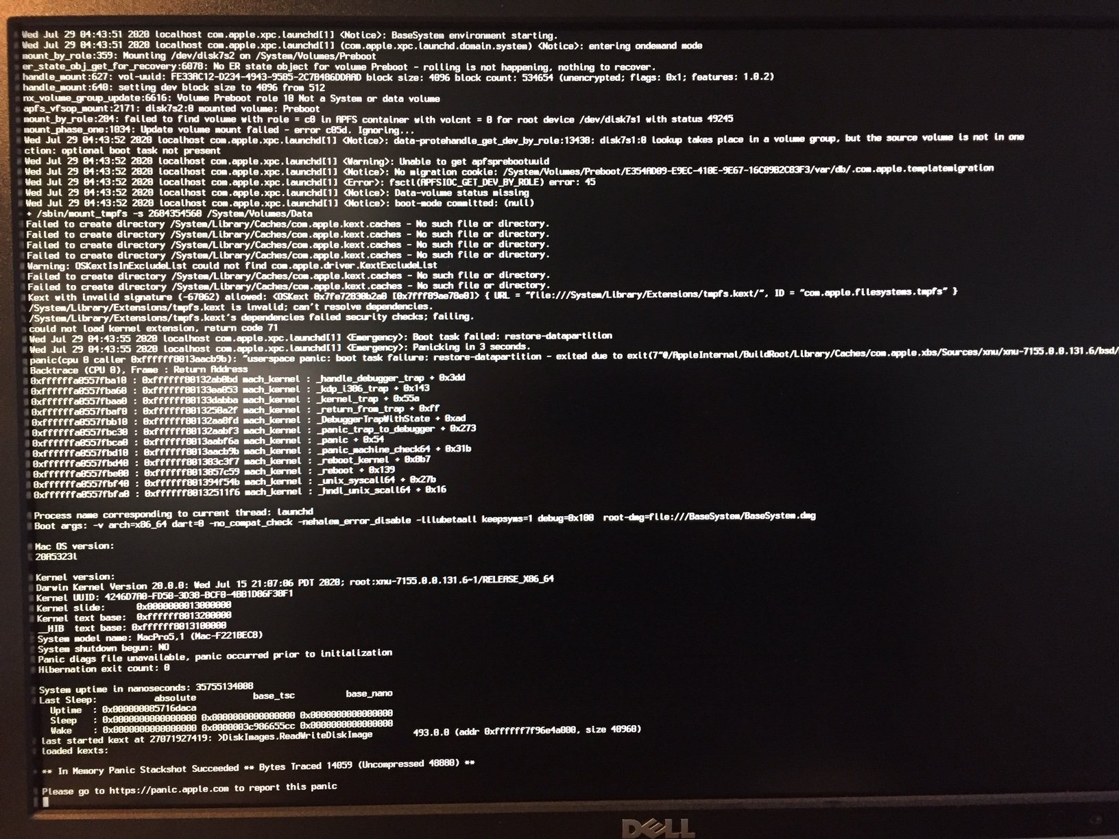

Hi @Slice
I build latest commit c87aabd: it's better I think. Thanks.
  • Can't boot on Big Sur Installer and Installed Big Sur: stuck this time at apfs_module
I see "couldn't load" kexts and "couldn't alloc"

Hi @Slice
I build latest commit fab169d: exactly same issue :cry:

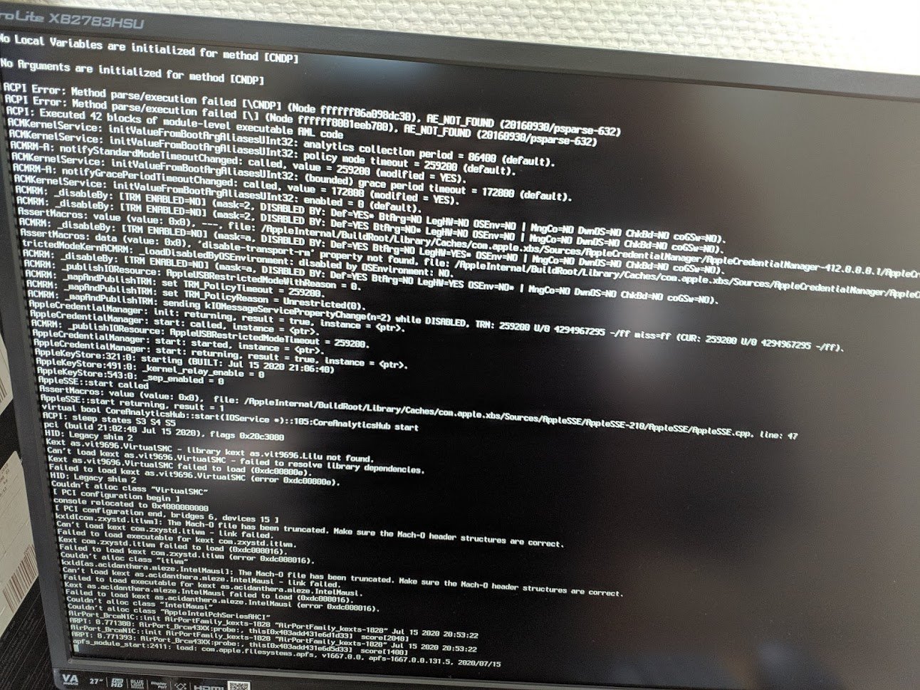

Hi @Slice
I  build latest commit 32eba04: it's better I think. Thanks.
I see "couldn't load" kexts and "couldn't alloc" messages
debug.log

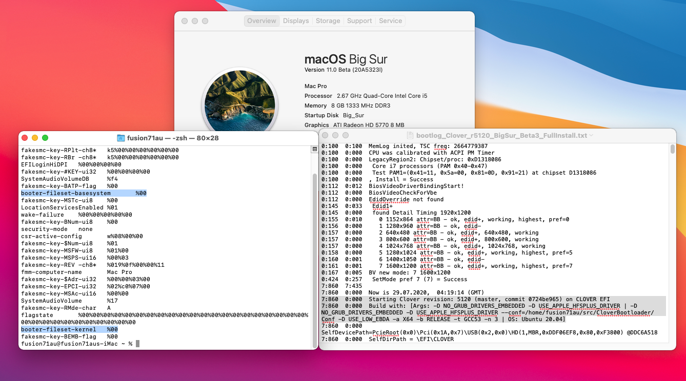

In my Z77 hackintosh only previous modified 5119 can boot Big Sur beta2 & beta3 as well as Catalina, but failed for BS installer. That means old OcQuirks.efi (59KB) worked, but new one (43KB) failed !
Edited by jsl2000
@jsl2000 You're using mod Clover r5119  to boot BS Beta 2 or Beta 3. With official Clover, I don't believe that the size of OcQuirks matters: in both cases, impossible to boot from USB Installer or external Hard disk, or internal hard disk on my Z390 system. At this time, of course.

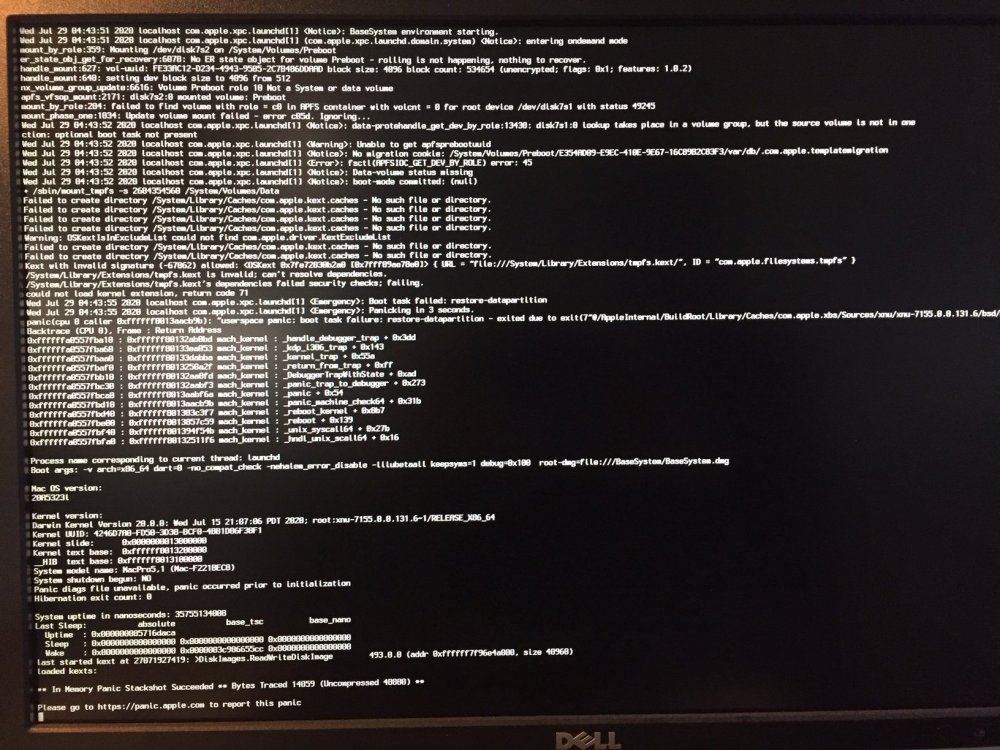

Hi @Slice thanks for your efforts.
I  build latest commit 15b65bd95 on Z390 system
Can't boot on Big Sur Installer and Installed Big Sur: stuck this time at apfs_module:2411
Before, I see "couldn't load" kexts and "couldn't alloc" messages
@Slice
Same issue here, Clover commit 15b65bd, 7/26, FYI.
  • Sad 1

Hi @Slice
Maybe I made a mistake somewhere
I can't boot r5120 commit 0724be9 on Big Sur (works fine for Catalina)
  • Can't boot on Big Sur Installer and Installed Big Sur: stuck this time at apfs_module:2411
  • Before, I see "couldn't load" kexts and "couldn't alloc" messages

47 minutes ago, Matgen84 said:
Hi @Slice
  Hide contents
debug.log
Delete your debug.log from misc folder. Else it grown unrestricted.
And I see no debug messages in your log.
See kernel_patcher.cpp line 26.
There should be
#define KERNEL_DEBUG 1
if you want to help me to see your problems.
  • Thanks 1

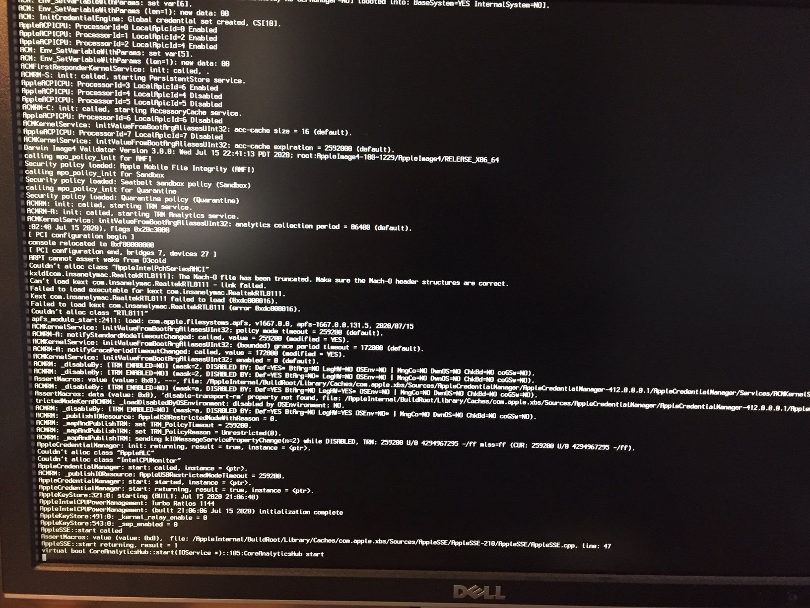

I have little progress after Lilu, WEG, AppleALC kexts removal and re-cleaning NVRAM.
Now no stop on apfs_module_start:2411 but boot process has progressed very little.
Clover - yesterday's
Edited by yapan4
  • Confused 1
Hi @yapan4 What do you mean by "after Lilu, WEG, AppleALC kexts removal"
As @Slice say, now Clover can inject kexts but can't load acidanthera kexts. So I delete all this kexts from /EFI/Clover/kexts/Others and try boot with FakeSMC only.
Now I have stop on 'still waiting for root device'
debug.log
Edited by yapan4
