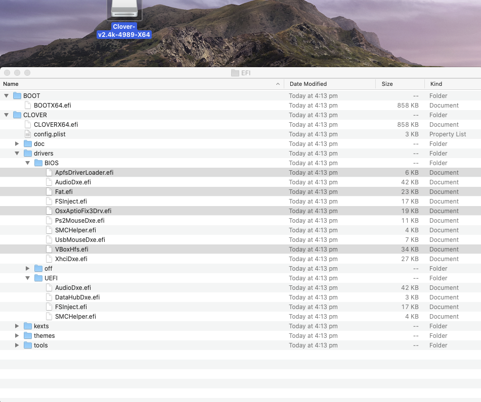

Attached you have the iso I used for this.
Clover-v2.4k-4986-X64.iso

25 minutes ago, arsradu said:
@Slice
So, short answer for booting from iso under UEFI: nope.
Long answer: noooope. :))
Details:
The DVD boot option is only visible if booting with CSM enabled. Otherwise, no way of choosing that in boot menu. And indeed, it's using cdboot.
And apparently, even if I try to boot like that, it ends up in an error. Not sure if that part is intended.
"Not found" is a typical Clover message. So it is started!

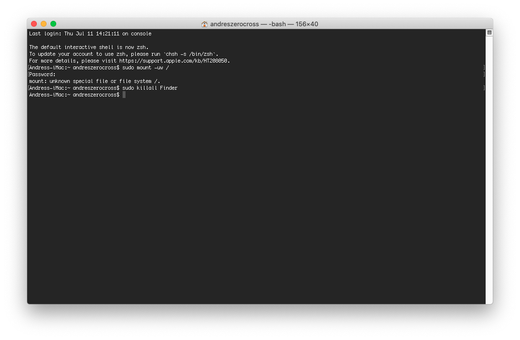

6 hours ago, Sherlocks said:
can you check sudo mount -uw in package?
still not working.. we need to type command in terminal
it is already there. Can you try to install only things that goes in the ESP, without installing the clover prefpane, rc script etc. and let me know?

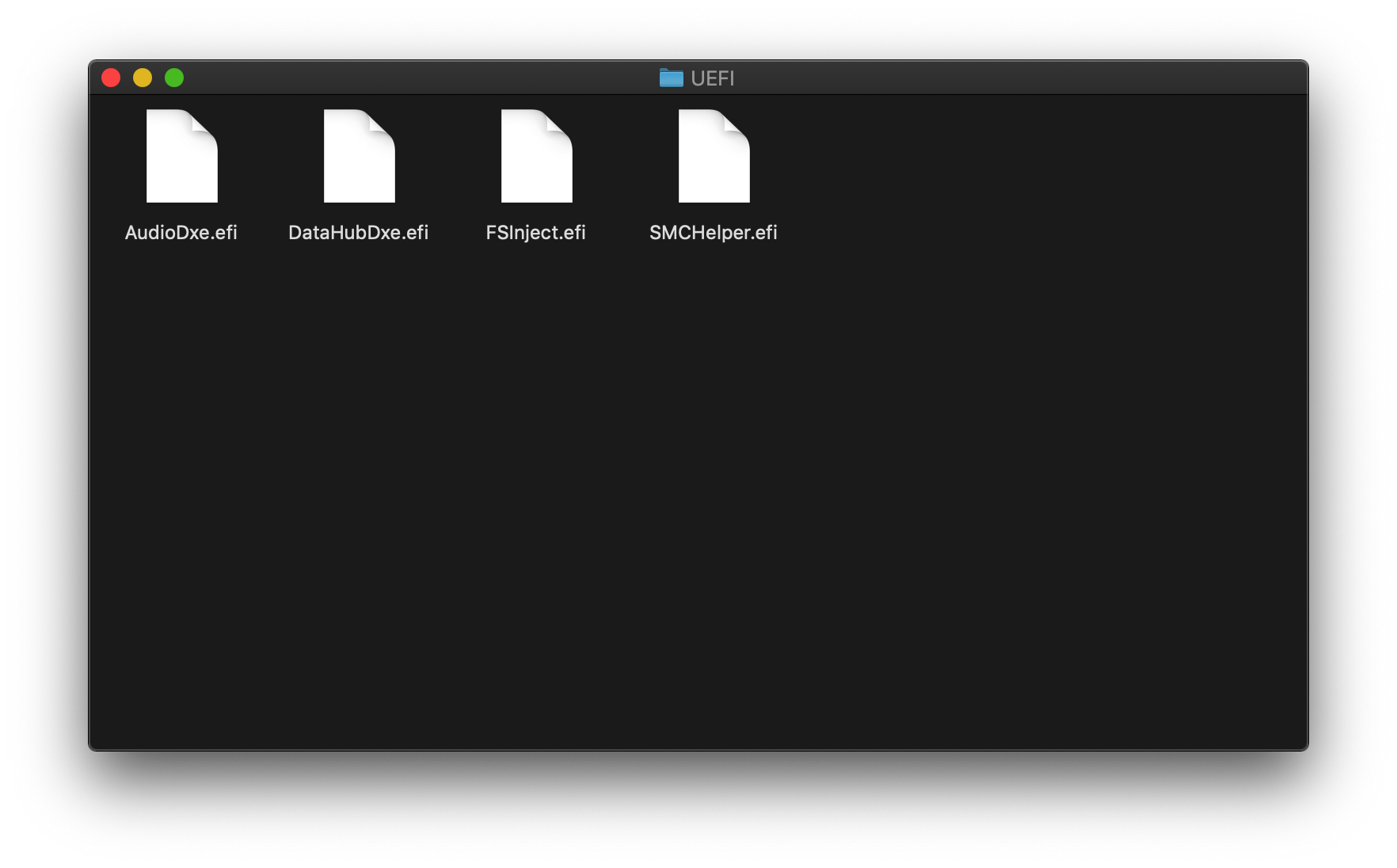

i think, the following folder could be deleted now from the repo: "CLOVER/CloverPackage/CloverV2/drivers-Off", cause since latest rev4986 it will no longer be filled with *.efi files while building CLOVER Installer.
Also in "ebuild.sh" line 843 "rm -rf "$CLOVER_PKG_DIR"/CloverV2/drivers-Off" could be deleted, which now seems to be useless
Is there to clean old stuff. Is the path wrong?
no, it is correct, but will allways recreate that folder, even it is no longer needed since latest rev4986. But i see your request to let it stay for users, which are not allways on latest rev.
still needed for users which are on revs <4986. Maybe "if...than...else"declaration could help: if current rev < 4986 create this folder, else delete it if present
Edited by Mork vom Ork

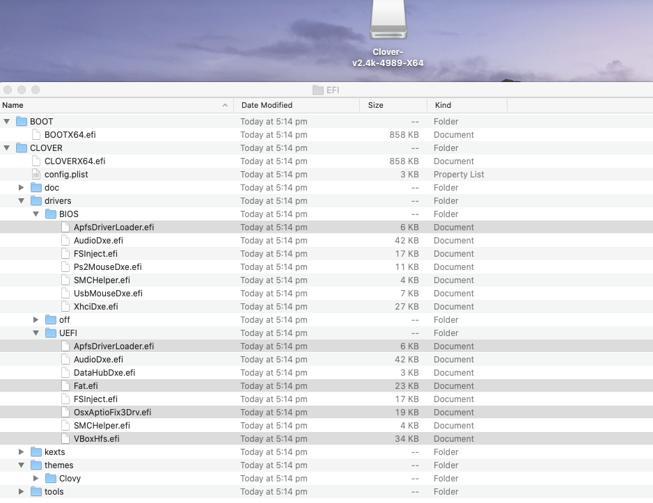

1983005483_Bildschirmfoto2019-07-10um20_52_46.png.7aea38c8e974f21a0c85c6e70571187d.png

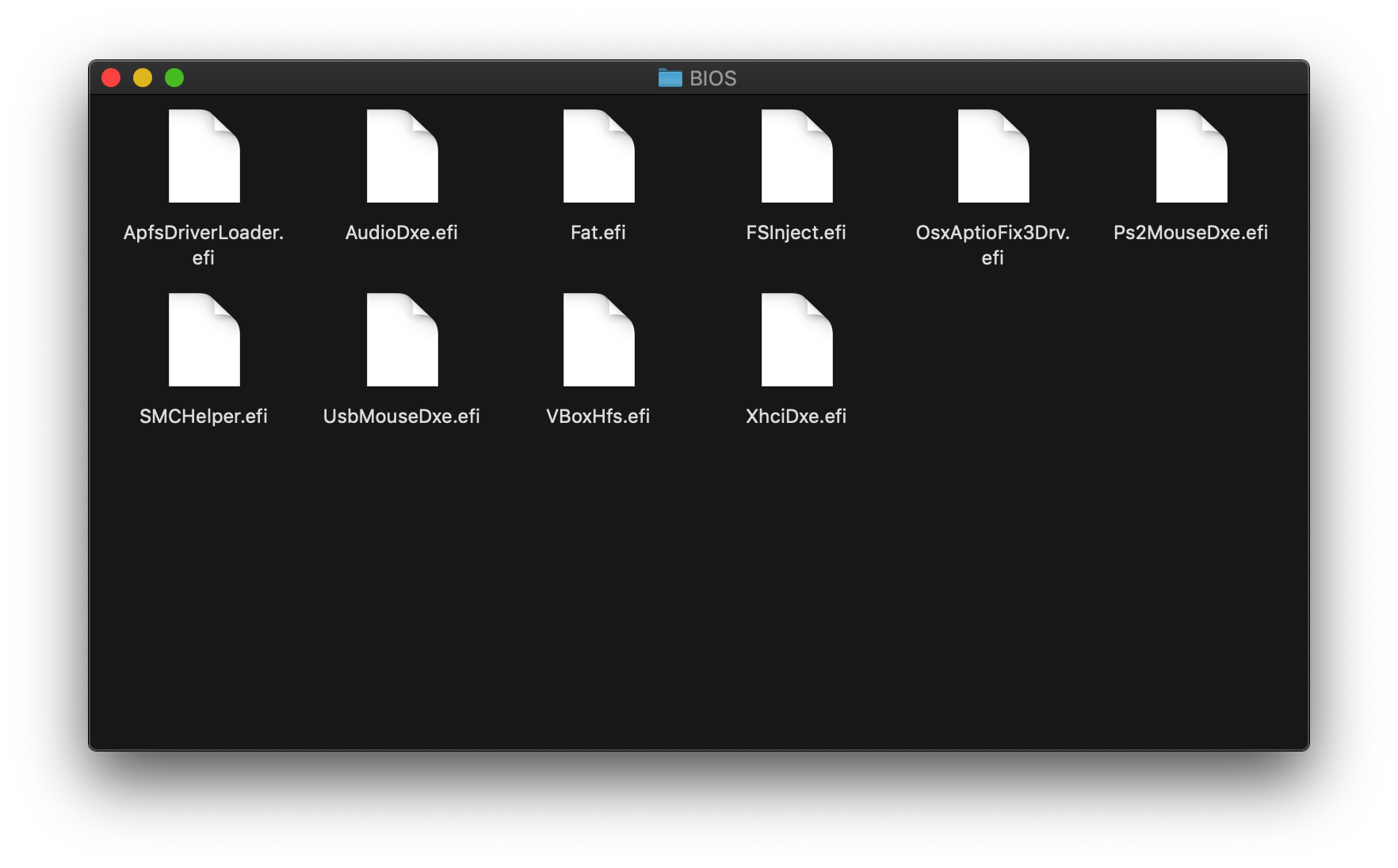

On 7/8/2019 at 3:57 PM, vector sigma said:
GPT don't have an ESP if the disk is  <=2 GB. It's also written to your log:
/dev/disk4 (external, physical):
   #:                       TYPE NAME                    SIZE       IDENTIFIER
   0:      GUID_partition_scheme                        *2.0 GB     disk4
   1:                  Apple_HFS Boot                    1.9 GB     disk4s1
...that disk4 doesn't have it. Take a 4 GB stick at least ;)

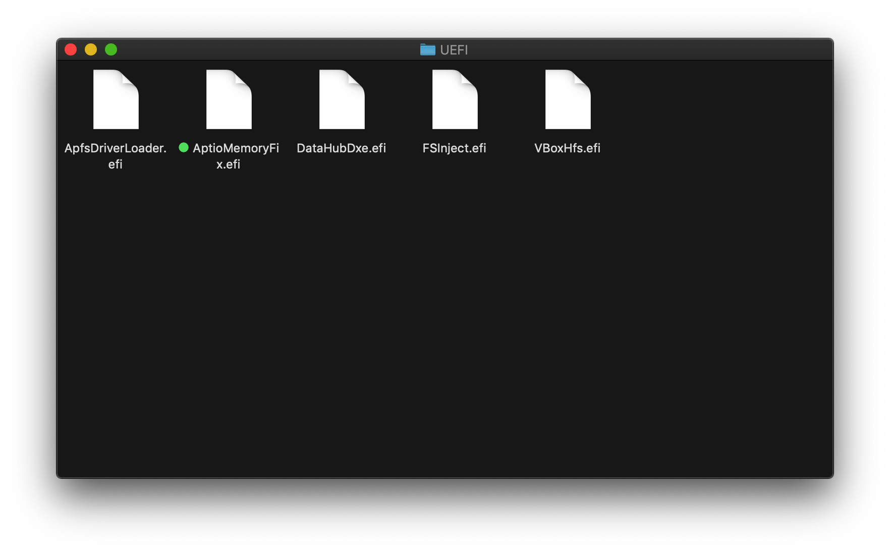

@arsradu,
Your compiled Clover ISO is missing apfs, HFS and AptioFix drivers, therefore the "Not found" error I assume...
Spoiler
You can try this one Clover-v2.4k-4986-X64.iso.zip with ApfsDriverLoader, VBoxHfs and AptioMemoryFix in /Drivers/UEFI included.  Note I have not changed the default config.plist provided by the Clover repo ---> may have to tweak settings to boot your system from the Clover GUI.
The Clover ISO at least is able to EFI boot into macOS Catalina with VMware EFI firmware ;)...

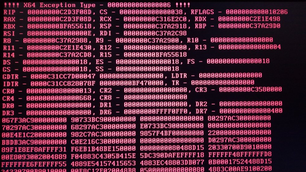

Yeah, I've noticed that, too! But since I've never used the iso before, I thought maybe that's just how it's supposed to be. Maybe it takes them from somewhere else.
Anyway, even with your ISO, I've got the exact same result:
1. DVD drive only visible if UEFI booting disabled (CSM enabled) which I guess it makes sense..if it's supposed to be for legacy booting only?
2. booting with that, I get stuck at exactly the same error "Not Found". If that's intended, well, I guess test passed....? But I can't get any further than that.
Also, if I press Enter on that error screen, I get this.

Also, speaking of drivers, in your iso, I can see this.
2045109834_Screenshot2019-07-11at09_33_28.thumb.png.da9fb4653fb481b134193165abf9057d.png
I tried to make a clean build of Clover iso, and while this time I got some drivers, the important ones seem to be all under drivers/BIOS, and not so much under drivers/UEFI. Is that intended...?
1596258691_Screenshot2019-07-11at09_35_25.thumb.png.822fb2ea38b50b8651baf14bb607715a.png
357843094_Screenshot2019-07-11at09_20_40.thumb.png.ce0873ed25b94dc421665c384f1b07c0.png

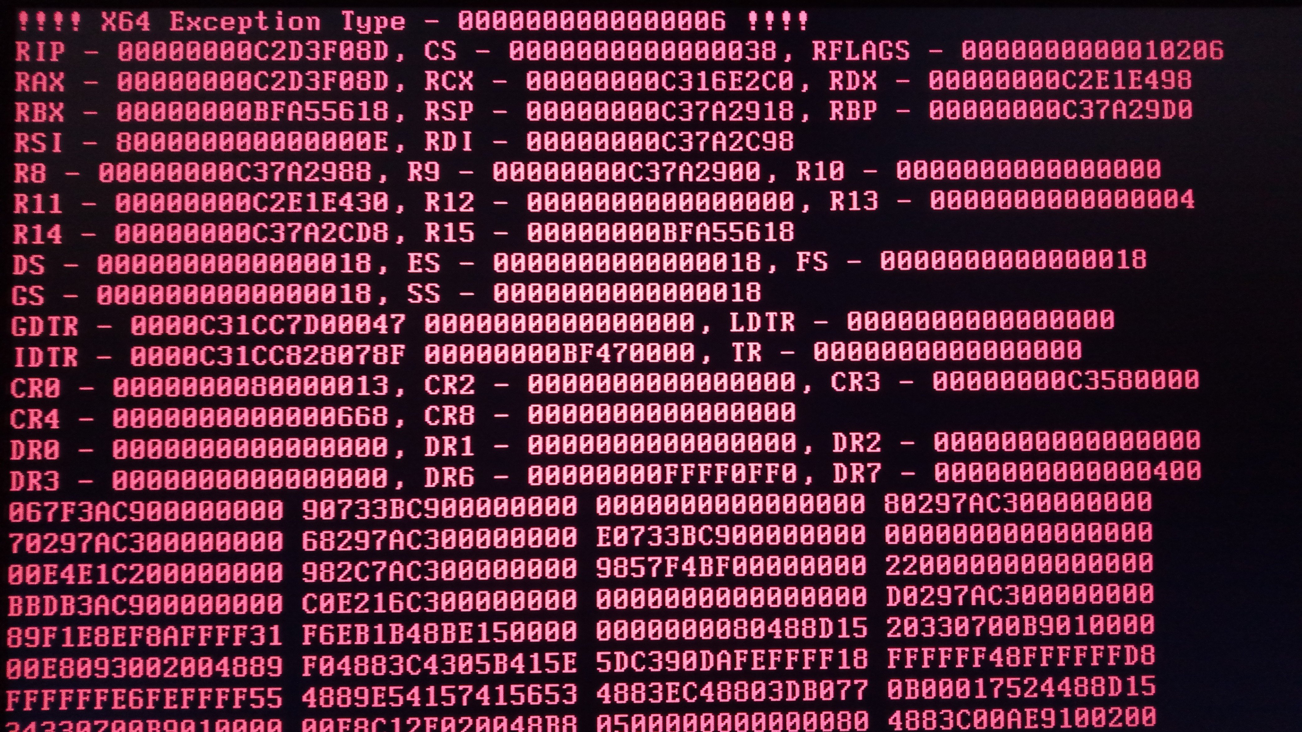

Also, checking the default config, I'm not sure if my system can boot with that.
I need KernelPM enabled in Kernel and Kext Patches.
Also, can you even boot with absolutely nothing in SMBIOS?
Also, I guess the iso is only for people who can boot with the default configuration? Meaning without changing anything on that iso. Cause otherwise, how would you even edit that iso AFTER it got compiled? Isn't that read-only? What can you use on MacOS to edit an ISO? Doesn't seem to work by default.
And even with hdiutil mount -readwrite /path-to-iso.iso doesn't seem to work... Or I'm doing it wrong.
Says:
hdiutil: mount failed - Function not implemented
This should be corrected.
BIOS drivers will not include Fat, HFS, AptioFix, UsbMouse and Ps2Mouse. They are already in cdboot file.
UEFI drivers not needed here as UEFI boot is not possible.
Default config can be corrected in Clover GUI. Press letter "o" and see new menu.
About "Not found". It is the message from DeleteFromBootOrder() procedure. I have to remember what is mean and why it can not work and why KP after it.
Says:

Hi @arsradu and @vector sigma,
@vector sigma,
There is a mistake in the makeiso script (introduced in commit for r4987), so that all the intended extra efi drivers for /drivers/UEFI ended up in /drivers/BIOS instead...
916848555_Cloverr4989ISOwrongfolderforUEFIdrivers.thumb.png.82963f2e74a91adec0276ef0ef34c3a8.png
I have fixed the script makeiso_fixed.zip so it now places the drivers in the UEFI folder (and also copies the needed ApfsDriverLoader.efi to /drivers/BIOS).
Spoiler
1845656739_Cloverr4989ISOUEFIdriversfolderfixed.png.d6c03e35d332cf216cc740b8b0ab68bf.png
For @arsradu,
To make a custom Clover ISO with your desired config.plist, assuming you have just built the standard Clover r4989 with eg Build_Clover.command...
1.  Rename ~/src/edk2/Clover/CloverPackage/makeiso to say makeiso_orig.  In its place, copy my fixed file above.
2.  Delete ~/src/edk2/Clover/CloverPackage/CloverV2/EFI/CLOVER/config-sample.plist.  Copy your desired config.plist (which you know boots your system) to the same folder, giving it the name config-sample.plist
3.  Copy all the kexts you normally need to inject with Clover to ~/src/edk2/Clover/CloverPackage/CloverV2/ThirdParty/kexts/Other
4.  Run my new makeiso script in terminal...
cd ~/src/edk2/Clover/CloverPackage
chmod +x makeiso
./makeiso
The custom ISO will be created in the ~/src/edk2/Clover/CloverPackage/sym folder.
The red screen error and your inability to boot in UEFI only mode maybe some firmware incompatibility or even the default Clovy svg theme (I have a red screen error on my legacy BIOS machines if I use Clovy theme instead of my normal BGM).  As I showed in the above post, at least theoretically, the Clover ISO is able to boot in UEFI mode successfully as a virtual CD/DVD-ROM attached to a VMware Workstation 12 VM.

I see....
Thing is..., I do not reach Clover GUI, at all. So...can't change anything on-the-fly. I just select the DVD from boot menu, a few lines appear (not enough time to actually read it), then blinking cursor in the top-left corner (I think that's normal for Legacy booting) aand then it gets stuck on that "not found" message. And if I press Enter on that screen, it goes to that red text screen I posted above.
So, I never get to actually tweak the config in any way, since I never reach Clover GUI.
