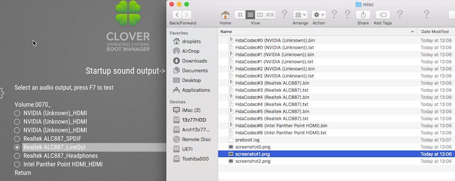

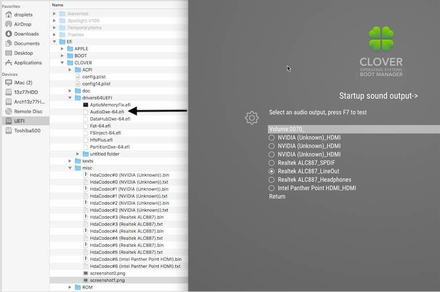

Badruzeus Posted February 26, 2019 Share Posted February 26, 2019 (edited) @Slice sorry, I got building issue after r4886 commit. Thanks. Edited February 26, 2019 by Badruzeus 1 1 Link to comment Share on other sites More sharing options...
Zenith432 Posted February 26, 2019 Share Posted February 26, 2019 @Badruzeus: I think it's a typo. Remove the offending line diff a/rEFIt_UEFI/Platform/HdaCodecDump.c b/rEFIt_UEFI/Platform/HdaCodecDump.c --- a/rEFIt_UEFI/Platform/HdaCodecDump.c +++ b/rEFIt_UEFI/Platform/HdaCodecDump.c @@ -404,7 +404,6 @@ EFI_STATUS SaveHdaDumpBin() { } } - CodecAddress; Status = HdaIo->GetAddress(HdaIo, &CodecAddress); CopyMem(HdaCodec.Header, hdcID, 4); 1 2 Link to comment Share on other sites More sharing options...
Badruzeus Posted February 26, 2019 Share Posted February 26, 2019 55 minutes ago, Zenith432 said: @Badruzeus: I think it's a typo. Remove the offending line diff a/rEFIt_UEFI/Platform/HdaCodecDump.c b/rEFIt_UEFI/Platform/HdaCodecDump.c --- a/rEFIt_UEFI/Platform/HdaCodecDump.c +++ b/rEFIt_UEFI/Platform/HdaCodecDump.c @@ -404,7 +404,6 @@ EFI_STATUS SaveHdaDumpBin() { } } - CodecAddress; Status = HdaIo->GetAddress(HdaIo, &CodecAddress); CopyMem(HdaCodec.Header, hdcID, 4); It works, many thanks. Codec Dump'ed successfully either using "F8" > \efi\clover\misc. EFI-r4886.zip misc_r4886_preboot_CodecDump.zip 1 Link to comment Share on other sites More sharing options...
droples Posted February 26, 2019 Share Posted February 26, 2019 Thanks! Clover4886+Patch @Zenith432 1 Link to comment Share on other sites More sharing options...
Slice Posted February 26, 2019 Share Posted February 26, 2019 2 hours ago, Zenith432 said: @Badruzeus: I think it's a typo. Remove the offending line diff a/rEFIt_UEFI/Platform/HdaCodecDump.c b/rEFIt_UEFI/Platform/HdaCodecDump.c --- a/rEFIt_UEFI/Platform/HdaCodecDump.c +++ b/rEFIt_UEFI/Platform/HdaCodecDump.c @@ -404,7 +404,6 @@ EFI_STATUS SaveHdaDumpBin() { } } - CodecAddress; Status = HdaIo->GetAddress(HdaIo, &CodecAddress); CopyMem(HdaCodec.Header, hdcID, 4); Really! Before the commit I tested with VS2013 compilation and fix some warnings. This one is not a warning for VS! 1 Link to comment Share on other sites More sharing options...
arsradu Posted February 26, 2019 Share Posted February 26, 2019 Thanks @Slice for the fix on commit 4887. All good now building Clover. Also, implementing that functionality right inside Clover was an awesome idea! Well done! 1 Link to comment Share on other sites More sharing options...
Slice Posted February 26, 2019 Share Posted February 26, 2019 5 minutes ago, arsradu said: Thanks @Slice for the fix on commit 4887. All good now building Clover. Also, implementing that functionality right inside Clover was an awesome idea! Well done! Credits to headkaze as well as explanations from him. 3 Link to comment Share on other sites More sharing options...
arsradu Posted February 26, 2019 Share Posted February 26, 2019 Just now, Slice said: Credits to headkaze as well as explanations from him. Thank you both! And @headkaze, that was a brilliant idea. Thank you very much! 1 Link to comment Share on other sites More sharing options...

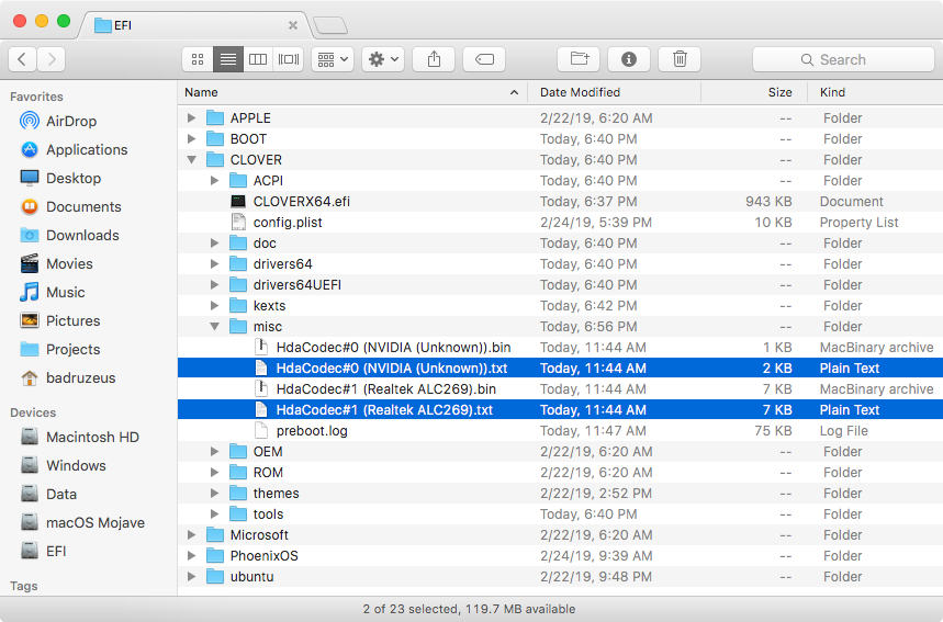

Badruzeus Posted February 26, 2019 Share Posted February 26, 2019 (edited) About my GT 520 HDMI "HdaCodec#0 (NVIDIA (Unknown))" is it because 0x10DE001C already taken by GT610? Can a same Device ID used by 2 different Audio models? Thanks. Edited February 26, 2019 by Badruzeus Link to comment Share on other sites More sharing options...
