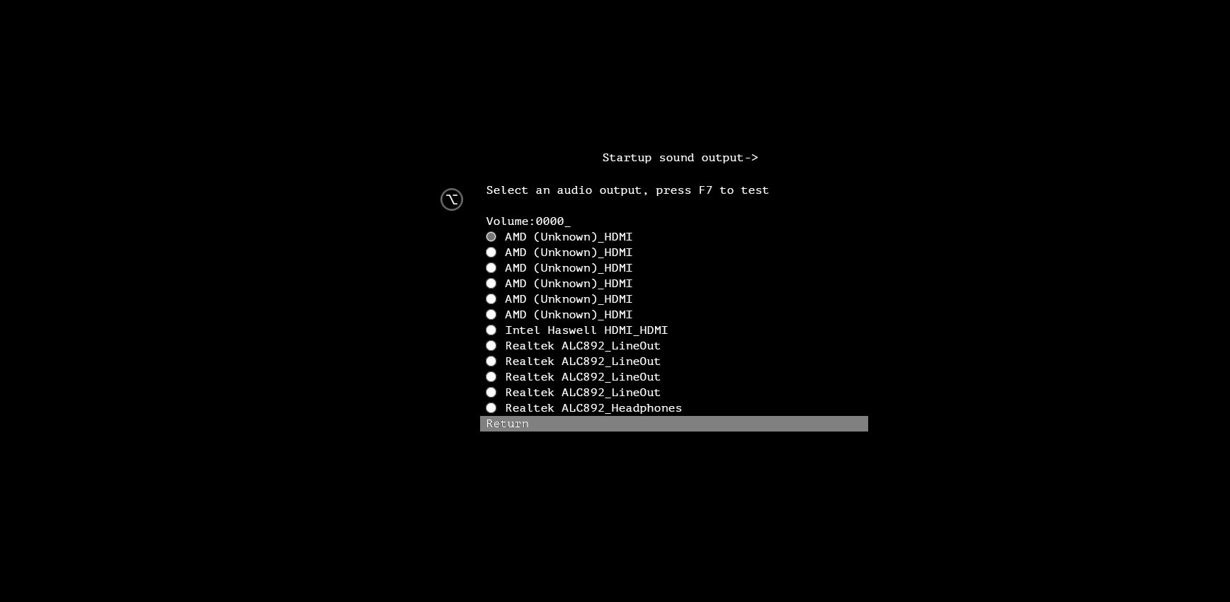

arsradu Posted January 19, 2019 Share Posted January 19, 2019 (edited) @cecekpawon I tried that, too. On startup, it says: "No device outputs were found. Ensure AudioDxe is loaded." Well...boot log says AudioDxe is loaded... 0:152 0:000 Loading AudioDxe-64.efi status=Success 0:153 0:001 - driver needs connecting Any idea? Edited January 19, 2019 by arsradu Link to comment Share on other sites More sharing options...

MakAsus Posted January 19, 2019 Share Posted January 19, 2019 15 minutes ago, arsradu said: @cecekpawon I tried that, too. On startup, it says: "No device outputs were found. Ensure AudioDxe is loaded." Well...it is present in drivers64UEFI...not sure if it's loaded though. Any idea? Try to clear the previous settings. To do this, choose option x, then s and v it also makes sense to check if the latest AudioDxe-64.efi or AudioDxe.efi is present in the drivers64UEFI folder. Link to comment Share on other sites More sharing options...

cecekpawon Posted January 19, 2019 Share Posted January 19, 2019 @arsradu from your log it sure enough that driver were successfully loaded. If you are already start BootChimeCfg from GUI, I have nothing to says more. Not sure AudioDxe (Clover vs Official) version is really matter here _/|\_ 1 Link to comment Share on other sites More sharing options...
arsradu Posted January 19, 2019 Share Posted January 19, 2019 (edited) 1 hour ago, cecekpawon said: @arsradu from your log it sure enough that driver were successfully loaded. If you are already start BootChimeCfg from GUI, I have nothing to says more. Not sure AudioDxe (Clover vs Official) version is really matter here _/|\_ Yeah, I am able to configure, test and set the wav sound I put in my selected theme (Minimalism). It respects the file name (sound.wav), the sample rate (44.1KHz) and the bits per sample (16bps). So... I would say the file is ok, the locations are ok (otherwise I think I wouldn't have been able to test and configure boot sound in the first place), still, upon startup, it says the output device is not found, and ensure AudioDxe is loaded... So...not sure what to say. :)) All seems to be working properly. Still, it doesn't. :)) And I'm using Clover 4851 (with the built-in AudioDxe) which in this exact commit it says: "update AudioDxe driver to sync with origin". So...I guess there shouldn't be a difference anymore, should it? If you have another version of AudioDxe, I would love to give it a try. Update: nevermind. IT WORKS! :)) It just works AFTER selecting the boot drive, not before, as it probably should, and as Clover's AudioDxe is probably trying to achieve. I guess Clover's AudioDxe is not (yet) compatible with the prebuilt BootChimeCfg.efi? Ooor...there's something missing somewhere. Bottom line, what did I do is: I got Goldfish's sources, compiled everything on my machine, used AudioDxe.efi, BootChimeDxe.efi in /drivers64UEFI and BootChimeCfg.efi and HdaCodecDump.efi in /tools and it works. Also, one thing to note is that I had to shut down my computer, and then restart. Simple restart didn't do it for me. Don't know why. Also, there was no error anymore. So I guess they're not compatible yet. So the config file doesn't see the AudioDxe file from Clover. But if it's built with it...it does. There are also other files, such as BootChimeDxe and HdaCodecDump which are missing from the Clover's instructions. They might not be needed. I just took everything as it was from the compiled sources. Just to have all the possible chances of this to work. And, what do you know? It does. :)) I'll test a few more things now and let you know if I find anything interesting. Edited January 19, 2019 by arsradu Link to comment Share on other sites More sharing options...
MakAsus Posted January 19, 2019 Share Posted January 19, 2019 18 minutes ago, arsradu said: Yeah, I am able to configure, test and set the wav sound I put in my selected theme (Minimalism). It respects the file name (sound.wav), the bitrate (44.1KHz) and the bps (16bps). So... I would say the file is ok, the locations are ok (otherwise I think I wouldn't have been able to test and configure boot sound in the first place), still, upon startup, it says the output device is not found, and ensure AudioDxe is loaded... So...not sure what to say. :)) All seems to be working properly. Still, it doesn't. :)) And I'm using Clover 4851 (with the built-in AudioDxe) which in this exact commit it says: "update AudioDxe driver to sync with origin". So...I guess there shouldn't be a difference anymore, should it? If you have another version of AudioDxe, I would love to give it a try. I am using a driver (official Goldfish64 build). The built in clover 4851 doesn't work properly for me. In the driver folder, I have BootChimeDxe.efi, which contains the ta-da sound. When I try to use the built-in (AudioDxe-64.efi) driver, I have no sound, and if I try to configure its parameters from the Clover menu, everything hangs and the previous settings are erased from the nvram. I am attaching the complete package I have just build in the archive. I apologize for my bad english. I'm from Russia. AudioPkg-R1-RELEASE.zip 1 Link to comment Share on other sites More sharing options...
arsradu Posted January 19, 2019 Share Posted January 19, 2019 (edited) 47 minutes ago, MakAsus said: I am using a driver (official Goldfish64 build). The built in clover 4851 doesn't work properly for me. In the driver folder, I have BootChimeDxe.efi, which contains the ta-da sound. When I try to use the built-in (AudioDxe-64.efi) driver, I have no sound, and if I try to configure its parameters from the Clover menu, everything hangs and the previous settings are erased from the nvram. I am attaching the complete package I have just build in the archive. I apologize for my bad english. I'm from Russia. AudioPkg-R1-RELEASE.zip Thanks, man. Yeah, if you read the update on my previous post, you'll see I did the exact same thing. :)) And it does work. As I said, it works in a different way though. Meaning the sound is played back after selecting the boot drive, not before, as I saw in one of the earlier posts, and as I think Clover is trying to achieve with its AudioDxe driver (when loading the theme). But it does work, if you're using all the files from the same source and you have them correctly placed in their locations. By the way, your English is quite good actually. :)) And I'm pretty sure very few people on this forum are actually native speakers. So don't worry about it. Edited January 19, 2019 by arsradu 1 Link to comment Share on other sites More sharing options...

cecekpawon Posted January 19, 2019 Share Posted January 19, 2019 @arsradu @MakAsus The sound on after selecting boot device must be come from BootChimeDxe. While on before Clover GUI / theme changes / within GUI are from Clover internal player. Agreed, AudioDxe will took sometimes to load, you may check it with BUILD_TARGETS=DEBUG while compiling. 2 Link to comment Share on other sites More sharing options...
arsradu Posted January 19, 2019 Share Posted January 19, 2019 32 minutes ago, cecekpawon said: @arsradu @MakAsus The sound on after selecting boot device must be come from BootChimeDxe. While on before Clover GUI / theme changes / within GUI are from Clover internal player. Agreed, AudioDxe will took sometimes to load, you may check it with BUILD_TARGETS=DEBUG while compiling. You are correct. That's indeed the source of the sound, just like MakAsus mentioned above. Removing that will also remove the sound after selecting the boot drive. I'm sure things will improve over time. And whatever is causing it not to work right now, I'm sure will be fixed. To be honest, I never thought I'd see the day a hackintosh will play that legendary Mac chime. :)) This is amazing, in my opinion. And I'd like to congratulate everyone involved in this little project for their amazing work. 2 Link to comment Share on other sites More sharing options...
chris1111 Posted January 19, 2019 Share Posted January 19, 2019 (edited) 3 hours ago, arsradu said: You are correct. That's indeed the source of the sound, just like MakAsus mentioned above. Removing that will also remove the sound after selecting the boot drive. I'm sure things will improve over time. And whatever is causing it not to work right now, I'm sure will be fixed. To be honest, I never thought I'd see the day a hackintosh will play that legendary Mac chime. :)) This is amazing, in my opinion. And I'd like to congratulate everyone involved in this little project for their amazing work. compile ➢ the source your self and its work Works for EFI and Lagacy Edited January 19, 2019 by chris1111 1 Link to comment Share on other sites More sharing options...
arsradu Posted January 19, 2019 Share Posted January 19, 2019 14 minutes ago, chris1111 said: compile ➢ the source your self and its work Works for EFI and Lagacy Thanks. I already did that. And it does work, indeed. But I was talking about Clover's attempt on this, with the sound included in the theme folder. That one doesn't work yet, at least for me. 1 Link to comment Share on other sites More sharing options...

MakAsus Posted January 19, 2019 Share Posted January 19, 2019 9 hours ago, arsradu said: Thanks, man. Yeah, if you read the update on my previous post, you'll see I did the exact same thing. :)) And it does work. As I said, it works in a different way though. Meaning the sound is played back after selecting the boot drive, not before, as I saw in one of the earlier posts, and as I think Clover is trying to achieve with its AudioDxe driver (when loading the theme). But it does work, if you're using all the files from the same source and you have them correctly placed in their locations. By the way, your English is quite good actually. :)) And I'm pretty sure very few people on this forum are actually native speakers. So don't worry about it. Thanks! You are right that "Clover tries to do this with the AudioDxe driver (when loading a theme)." This worked in revisions up to 4850 (revision 4850 caused in my case a frequent panic). Edition 4850 caused a frequent panic, and in revision 4851, the sound with the built-in AudioDxe stopped working, even if all the files are from the same source, even if they are located in their places. it just hangs if I press the F7 key, or it doesn’t play back anything either before loading the theme or when the progress bar appears. Although the outputs and level are selected correctly. 1 Link to comment Share on other sites More sharing options...
arsradu Posted January 19, 2019 Share Posted January 19, 2019 (edited) 42 minutes ago, MakAsus said: Thanks! You are right that "Clover tries to do this with the AudioDxe driver (when loading a theme)." This worked in revisions up to 4850 (revision 4850 caused in my case a frequent panic). Edition 4850 caused a frequent panic, and in revision 4851, the sound with the built-in AudioDxe stopped working, even if all the files are from the same source, even if they are located in their places. it just hangs if I press the F7 key, or it doesn’t play back anything either before loading the theme or when the progress bar appears. Although the outputs and level are selected correctly. Yep, I think I also mentioned in my previous posts that F7 freezes the UI in 4851. Looks like I'm not the only one. I'll try some of the older builds, before 4851 but after the official 4844. See how they perform... Update: Well, what do you know? Version 4848 works perfectly fine, with the same files in the same places. Well, the AudioDxe driver was actually the one built into version 4848, so most likely different from the one in version 4851. But yeah, it works. The UI in Options -> Startup Sound still needs some tweaking. But I was able to configure everything from Shell. Edited January 19, 2019 by arsradu 1 Link to comment Share on other sites More sharing options...
MakAsus Posted January 19, 2019 Share Posted January 19, 2019 57 minutes ago, arsradu said: Yep, I think I also mentioned in my previous posts that F7 freezes the UI in 4851. Looks like I'm not the only one. I'll try some of the older builds, before 4851 but after the official 4844. See how they perform... Update: Well, what do you know? Version 4848 works perfectly fine, with the same files in the same places. Well, the AudioDxe driver was actually the one built into version 4848, so most likely different from the one in version 4851. But yeah, it works. The UI in Options -> Startup Sound still needs some tweaking. But I was able to configure everything from Shell. For me, version 4848 works fine with files from version 4851. Most of the changes were in the StartupSound.c file. Unfortunately, I am not a good programmer. I would fix the problem, but I do not know how! 1 Link to comment Share on other sites More sharing options...
