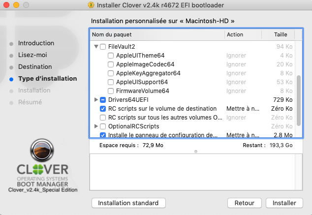

Can I please get a list of drivers to remove from drivers64uefi if I’m not using FileVault.
I don't use FileVault and I only use the following drivers:
ApfsDriverLoader-64.efi
AppleImageLoader-64.efi
AptioMemoryFix-64.efi
VBoxHfs-64.efi - For booting from HFS volumes like USB installers and older HFS bootable volumes
Edited by Cyberdevs
On 8/24/2018 at 2:51 PM, Slice said:
If not using FV2 then you can safely remove
AppleKeyAggregator
AppleUITheme
FirmwareVolume
HashServiceFix
As well OsxFatBinaryDrv needed only for 10.8 and older.
SMCHelper needed for FV2 and for Hibernation.
AppleImageLoader may check digital sign of loaded module but you can live without it.
After removing those drivers i'm still left with:
AppleImageCodec-64.efi
AppleKeyFeeder-64.efi
FirmwareVolume-64.efi
FSInject-64.efi
Are the above needed for NON FV boot?

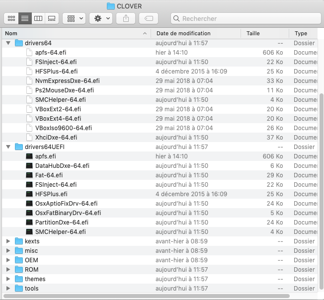

On 8/30/2018 at 10:26 PM, viktr said:
Hi,
Found strange problem. ApfsDriverLoader.efi and DumpUefiCalls.efi together make clover boot menu empty - clover do not see any bootable apfs partitions. Is it supposed to be so?
I have an even stranger one. I was using ApfsDriverLoader successfully for a while until today where after a reboot the boot menu is empty. I don't have DumpeUefiCalls.efi
ApfsDriverLoader-64.efi        DataHubDxe-64.efi
AppleImageCodec-64.efi        FSInject-64.efi
AppleKeyAggregator-64.efi    FirmwareVolume-64.efi
AppleUITheme-64.efi        SMCHelper-64.efi
AptioInputFix-64.efi        VBoxHfs-64.efi
Tried the latest ApfsDriverLoader (which has dropped the -64) and same problem. My backup USB that uses the old way of apfs.efi is working fine.

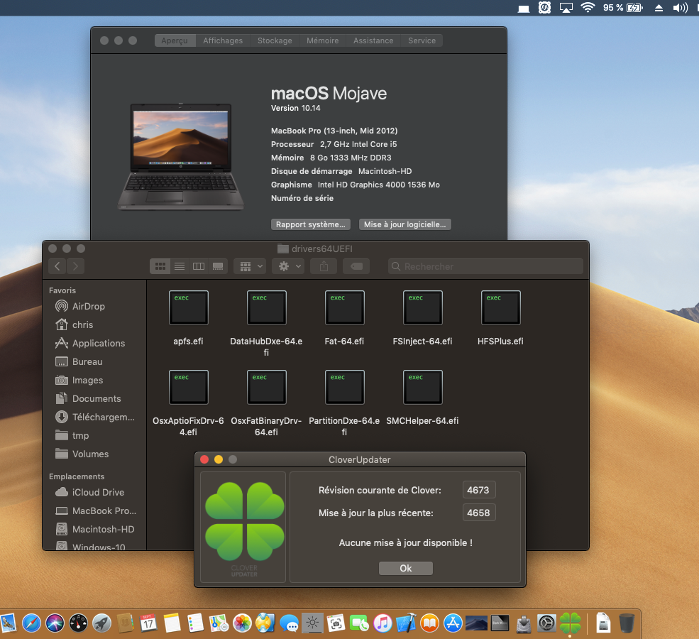

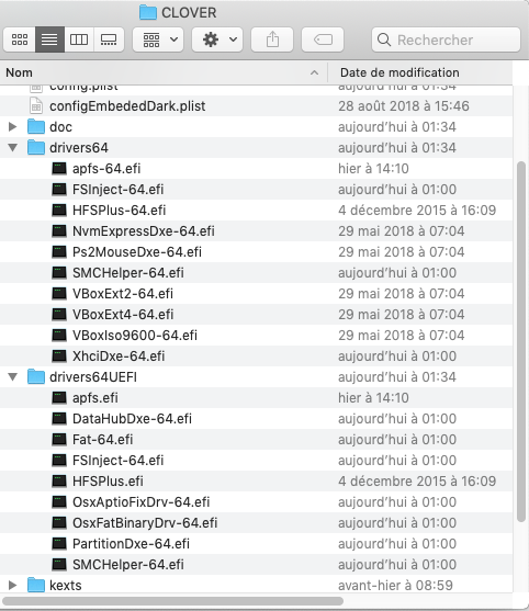

I don't find AppleKeyMapAggregator-64.efi in clover build package. For AptioInputFix-64, the description indicate: "Driver to fix input problems on UEFI firmware such as AMI Aptio." I don't understand why is only for FV2
29 minutes ago, Matgen84 said:
Thanks :)
I didn't see any input problems other than FV2 password input.
AppleKeyMapAggregator as well as AppleEvent can be found elsewhere mostly for oz users.

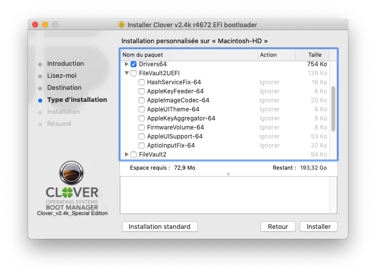

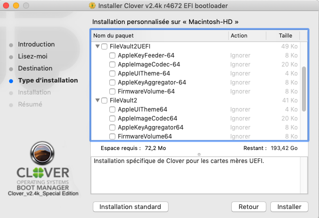

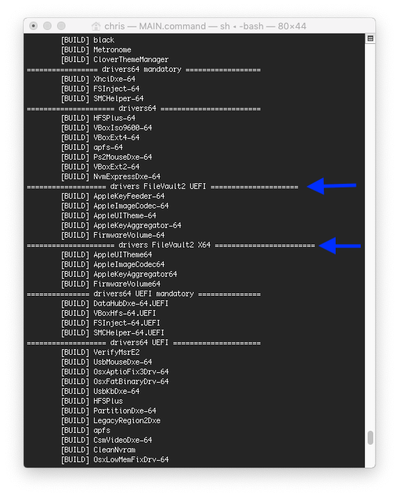

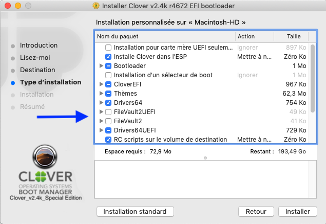

I apologize friends, but this discussion of what drivers are needed for this or that, has already made me delete some, come back again and I do not use FV2.
Why not separate into the Clover installation options? Type: "UEFI Drivers without FV2" and "UEFI Drivers with FV2"
Thanks
  • Like 5
  • Thanks 1
Thanks
Good idea :) But I think, there is a risk of duplication. Some drivers are necessary for FV2 user or not. Drivers descriptions with the mention FV2 seem to me the simplest
