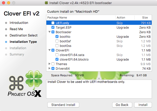

Badruzeus Posted June 7, 2018 Share Posted June 7, 2018 Is this Clover bug or just my compilation problem with xcode8? r452x install menu (right one) is not comfortable to read and missed the descriptions. Thanks. Link to comment Share on other sites More sharing options...
Matgen84 Posted June 7, 2018 Share Posted June 7, 2018 2 hours ago, Badruzeus said: Is this Clover bug or just my compilation problem with xcode8? r452x install menu (right one) is not comfortable to read and missed the descriptions. Thanks. Same here with Xcode 9.4 compilation. Link to comment Share on other sites More sharing options...

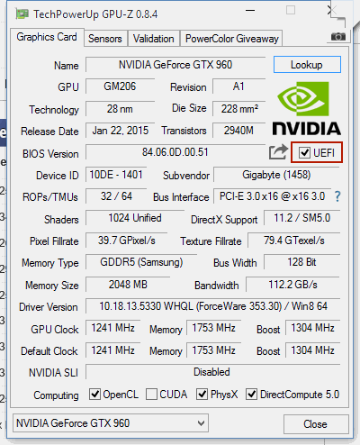

arsradu Posted June 8, 2018 Share Posted June 8, 2018 50 minutes ago, SavageAUS said: How do I enable 2560x1440 res in clover gui? I tried setting in config.plist but it didn't work. You might need CSM disabled in BIOS, no CSMvideo driver in Clover, and an UEFI supported graphics card (WITH the UEFI firmware installed). That's usually the recipe for native resolution in preboot. I'm also using a 2560x1440 monitor, and I have no issues. So I'm sure it is possible. Link to comment Share on other sites More sharing options...
SavageAUS Posted June 8, 2018 Share Posted June 8, 2018 4 minutes ago, arsradu said: You might need CSM disabled in BIOS, no CSMvideo driver in Clover, and an UEFI supported graphics card (WITH the UEFI firmware installed). That's usually the recipe for native resolution in preboot. I'm also using a 2560x1440 monitor, and I have no issues. So I'm sure it is possible. Thanks ill check the bios settings. I will assume my GTX960 has uefi firmware. Link to comment Share on other sites More sharing options...
arsradu Posted June 8, 2018 Share Posted June 8, 2018 (edited) 7 minutes ago, SavageAUS said: Thanks ill check the bios settings. I will assume my GTX960 has uefi firmware. Well, if disabling CSM in Bios doesn't do the trick, I would also double check the graphics card firmware, as well. Just in case. It most likely does have the UEFI firmware installed. But it's worth double checking this, since this is an important part of the whole process (if not the most important part). Otherwise, it won't work. Sadly, the only way I know to check that information is...from Windows, using GPU-Z. When everything is ok, it should look something like this. Edited June 8, 2018 by arsradu Link to comment Share on other sites More sharing options...
SavageAUS Posted June 8, 2018 Share Posted June 8, 2018 4 minutes ago, arsradu said: Well, if disabling CSM in Bios doesn't do the trick, I would also double check the graphics card firmware, as well. Just in case. It most likely does have the UEFI firmware installed. But it's worth double checking this, since this is an important part of the whole process (if not the most important part). Otherwise, it won't work. Sadly, the only way I know to check that information is...from Windows, using GPU-Z. When everything is ok, it should look something like this. Yeah it's all good. My uefi firmware has option for other os or Windows, when I switched to Windows option I could disable csm which gave me native resolution. (New monitor today) 2 Link to comment Share on other sites More sharing options...
