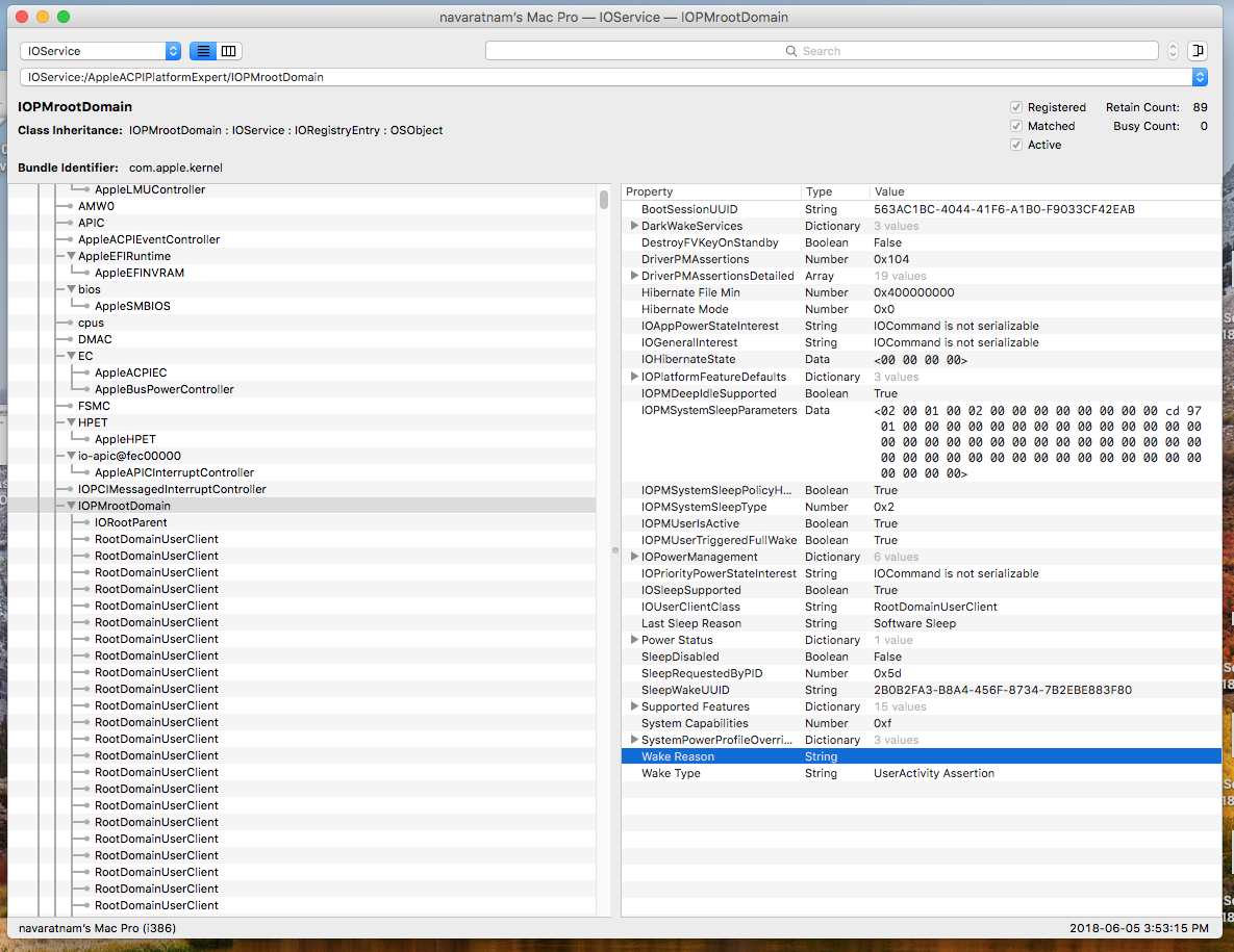

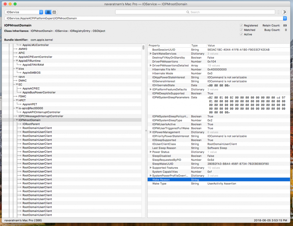

nmano Posted June 2, 2018 Share Posted June 2, 2018 (edited) Hi All Wake up my system after install thunderbolt card. If I press sleep button went to sleep after 2 second wake up agan. Please help for fix this. Please check my files. I install HibernationFixup.kext too. 35 2 0xffffff7f84179000 0x6d000 0x6d000 as.vit9696.Lilu (1.2.3) DC607E11-9271-3E76-B07D-6B552EEF0158 <7 5 4 3 2 1> 36 0 0xffffff7f841e6000 0x5000 0x5000 as.lvs1974.HibernationFixup (1.2.1) FC2AF3B6-0824-330F-B1B5-EB7D16B93FF8 <35 7 5 4 3 2 1> My PM settings System-wide power settings: Currently in use: autorestart 0 Sleep On Power Button 1 halfdim 1 hibernatefile /var/vm/sleepimage powernap 1 networkoversleep 0 disksleep 10 sleep 0 (sleep prevented by coreaudiod) hibernatemode 0 ttyskeepawake 1 displaysleep 23 (display sleep prevented by coreaudiod, com.apple.WebKit.WebContent) womp wake reason unknown? Please help fix this issue. Thank you. navaratnam’s Mac Pro-wake.ioreg Edited June 5, 2018 by nmano Link to comment Share on other sites More sharing options...

nmano Posted June 5, 2018 Share Posted June 5, 2018 (edited) Hi Sir My system wakeup if I press sleep button went to sleep after 2 second wake up. I notice After I install Alpine Ridge Thunderbolt 3 card sleep not work . Please help to fix this. Thank you. BootLog_Firmware.zip BootLog_Kernel.zip navaratnam’s Mac Pro.zip Power.zip RTC.zip SSDT-X99-TB3-iMacPro-mano.aml.zip Edited June 5, 2018 by nmano Link to comment Share on other sites More sharing options...
