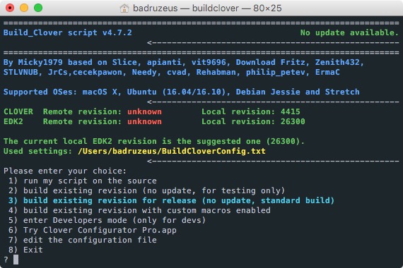

LockDown Posted February 14, 2018 Share Posted February 14, 2018 building clover prompts me that i need Java. Should i install it? Link to comment Share on other sites More sharing options...
Slice Posted February 14, 2018 Share Posted February 14, 2018 building clover prompts me that i need Java. Should i install it? This should not happen. Meanwhile I have java. Link to comment Share on other sites More sharing options...

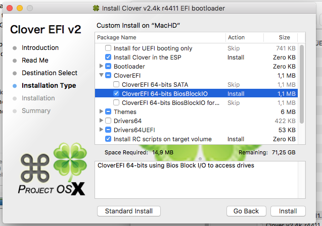

TheBloke Posted February 15, 2018 Share Posted February 15, 2018 Hi all Is it at all possible to boot Clover and macOS from an LSI SAS/SATA adapter, on a system without UEFI (using Legacy Boot)? I'm running 10.13.3 with latest Clover (4411). I'm installed on an SSD so I am using APFS. My motherboard is Gigabyte GA-X58A-UD3R, which does not have UEFI. My LSI card is an LSI 9201-8i, which uses the 2008 controller chip and has latest firmware (v20). I have this working in my macOS 10.13.3 installation using Astek drivers installed in EFI/CLOVER/kexts/Other. Once booted, I can see and use drives attached to this controller. But if possible I would like to move my main SSD to this controller and boot from it, so that I'm not using onboard SATA at all. I've tried two things: 1. I attached my macOS/Clover SSD to the LSI and set it first in the boot order. Clover started to load (I saw the cursor at top left, and then the number 6 briefly appears), but it then went to the "BIOS-like" interface where Continue is the first option, which the Clover Wiki describes as "This means that the boot file was successfully loaded and is working but it cannot find the file CloverX64.efi." 2. I also tried a new Clover install onto a USB drive. This loads Clover OK, but drives installed on the LSI don't appear in the selection. I suppose this is probably predictable - Clover can't read from the LSI controller without drivers, which don't exist. However, I know other people are booting from RAID arrays on LSI MegaRAID cards. But perhaps they can only do that if they have EFI support? (Although the posts I've seen mentioning RAID boot are a year or two old, back on 10.11 and 10.12 and before APFS, and maybe that's changing something.) Also I am able to boot other OS' direct from the LSI - Windows, Linux, etc. Windows I have confirmed I can fully boot to from the LSI, even though I originally installed it on the onboard SATA. But I suppose Clover and macOS must be a bit different, perhaps because of the need to fake EFI. I'm sorry that I don't really understand the technical details of these boot loaders yet, though I am trying to learn more. But I can imagine the Clover bootloader must be more complex than the basic one used to launch Windows, or Grub in Linux etc. Is there any way to get this to work? I suppose worst case I could have the main OS installed on a small SSD on my onboard SATA, then move /Users to the main SSD on the LSI. But it'd be nice if I could just use the LSI controller and not need to split my macOS install over two SSDs. Thanks in advance. PS. in case it's of any importance, I've noticed that since I installed the LSI controller, I always see the number '6' in the top left of the screen just before the Clover GUI appears. I saw in the FAQ that a '7' means problems, but I don't know what '6' means. This happens regardless of how I boot Clover - from onboard SATA; from USB; and from a (failed) attempt to boot direct from the LSI. Link to comment Share on other sites More sharing options...
Slice Posted February 15, 2018 Share Posted February 15, 2018 @TheBloke Installing Clover you may choose SATA driver or BiosBlockIO. In the first case you will see 6 on the screen. In the second case 7. I may propose that for LSI controller you need 7. 1 Link to comment Share on other sites More sharing options...
