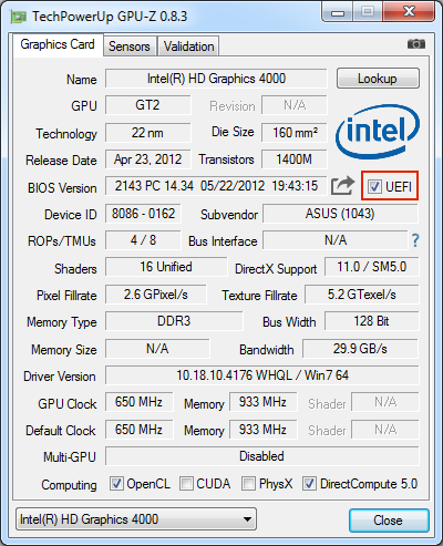

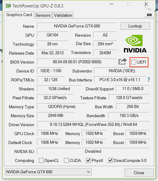

Wppley2 Posted July 24, 2017 Share Posted July 24, 2017 Hi Philip Petev! How I can know if my video card is UEFI capable? Thanks! Link to comment Share on other sites More sharing options...
Slice Posted July 24, 2017 Share Posted July 24, 2017 Hi Philip Petev! How I can know if my video card is UEFI capable? Thanks! See this post 1 Link to comment Share on other sites More sharing options...
cecekpawon Posted July 24, 2017 Share Posted July 24, 2017 That's because the legacy layer (CSM) is limited to few 4:3 resolutions (may vary for the different boards). The UEFI native mode has no such limitations. The only requirement is the Video BIOS to be UEFI - compatible as well (mostly for all external video cards). Maybe it sounds strange. My CSM always disabled & looks differ when I boot to Windows with Clover vs Ozmosis / direct from boot menu. Link to comment Share on other sites More sharing options...
Slice Posted July 24, 2017 Share Posted July 24, 2017 Hi Philip Petev! How I can know if my video card is UEFI capable? Thanks! One trick. See ACPI tables list in Clover GUI. If you find a table with name VFCT then your videocard has UEFI VBIOS. 2 Link to comment Share on other sites More sharing options...

Wppley2 Posted July 24, 2017 Share Posted July 24, 2017 Just use GOPupd: http://www.win-raid.com/t892f16-AMD-and-Nvidia-GOP-update-No-requests-DIY.html I've used it on many GPUs, never had problems with it. The VFCT ACPI table is only found when the AMD GOP driver is loaded. NVIDIA GPUs do not create such an ACPI table. Oh TheRacerMaster! Thats the point! Im searching for UEFI for my GTX 750 Ti. What I need to do? The link is broken. Thanks. May be. Asus EAH6450 Video BIOS UEFI GOP Upgrade (And GOP UEFI binary in .efi for many ATI cards) But what did you expected to have? I propose nothing. Thanks Slice, but is for my GTX 750 Ti. What im looking for is to boot with boot rom priority = efi rom. Link to comment Share on other sites More sharing options...
Philip Petev Posted July 24, 2017 Share Posted July 24, 2017 @Wppley2 Better contact your video card vendor and ask him for UEFI upgrade for your card. That's what I did in order to upgrade mine EVGA GTX 650 SC. 1 Link to comment Share on other sites More sharing options...
Wppley2 Posted July 24, 2017 Share Posted July 24, 2017 @Wppley2 Better contact your video card vendor and ask him for UEFI upgrade for your card. That's what I did in order to upgrade mine EVGA GTX 650 SC. Hey Philip Petev! Thank you for the response! I'm reading in Win Raid and discover one bug of my mobo bios with PCI Rom priority. Is a bug with various Asus mobos. 1 Link to comment Share on other sites More sharing options...
TheRacerMaster Posted July 24, 2017 Share Posted July 24, 2017 Oh TheRacerMaster! Thats the point! Im searching for UEFI for my GTX 750 Ti. What I need to do? The link is broken. Thanks. Thanks Slice, but is for my GTX 750 Ti. What im looking for is to boot with boot rom priority = efi rom. Hmm, seems like some referral check? Just search for GOPupd on Win-Raid. 1 Link to comment Share on other sites More sharing options...

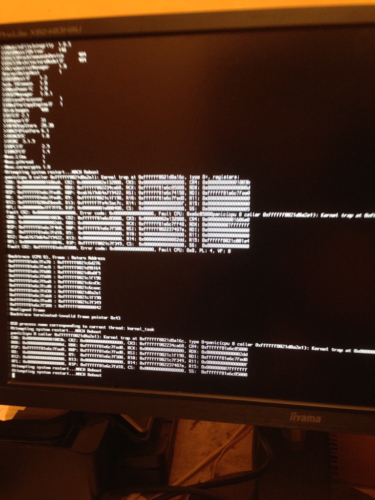

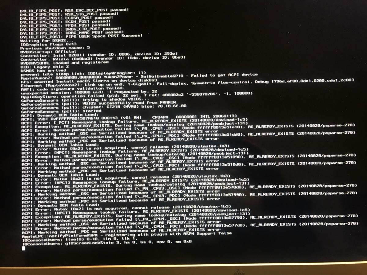

Matgen84 Posted July 25, 2017 Share Posted July 25, 2017 Hi I want to try different config.plist on my hack under EFI/Clover with same kexts. For example, config-1.plist with Imac13,2 SMBIOS and config-2.plist for macpro6,1 SMBIOS. When I select config-2.plist in Clover/Options, I've kernel panic and empty boot args. However, config-2.plist is fully functional on my external drive Any ideas? Link to comment Share on other sites More sharing options...
Slice Posted July 25, 2017 Share Posted July 25, 2017 Hi I want to try different config.plist on my hack under EFI/Clover with same kexts. For example, config-1.plist with Imac13,2 SMBIOS and config-2.plist for macpro6,1 SMBIOS. When I select config-2.plist in Clover/Options, I've kernel panic and empty boot args. However, config-2.plist is fully functional on my external drive Any ideas? Set Boot->Debug=YES and catch the moment of panic. 1 Link to comment Share on other sites More sharing options...

Matgen84 Posted July 25, 2017 Share Posted July 25, 2017 @Slice Screen catches attached : below I don't understand: config-2.plist work alone on USB disk and don't work on HDD. How to use Clover/options/Config? Thanks Link to comment Share on other sites More sharing options...
Slice Posted July 25, 2017 Share Posted July 25, 2017 is there a possibility to have "Save clover options as default" from GUI? like when changing bios features but for clover GUI. so we can make permanent changes from Clover boot GUI. it already saves other tables and dumps. Not new question again. This was discussed several years. This is very hard to do because config.plist is not complete set of settings. CloverConfigurator is wrong because it forced users to make full config. No, don't do this! In most cases config must be very reduced. Clover will calculate most values depending on current hardware state. And then there is a problem for Clover programmers where to catch all settings. They came from config.plist. User can change the config and then values will be changed. User can enter GUI and change setting here. Some settings will be calculated, some recalculated. Some setting are stored in gSetting, some in GlobalConfig, some in internal arrays (patches for example), some in nvram.plist which will be updated next time. This inconvenience appears because of history of Clover development. As is. Did you know an appointment of utility clover-genconfig? When you can't boot you enter GUI and change something. After this change you are trying to boot and after some attempts the victory! You enter the system! At this point you may start clover-genconfig and got almost all setting that you changed last time booting. You can copy them into your config.plist finally. @Slice Screen catches attached : below I don't understand: config-2.plist work alone on USB disk and don't work on HDD. How to use Clover/options/Config? Thanks Looks like you missed something. Take into account that Kernel and Kext patches will not replaced in config.plist changes. 2 Link to comment Share on other sites More sharing options...
Cyberdevs Posted July 25, 2017 Share Posted July 25, 2017 Screen catches attached : below I don't understand: config-2.plist work alone on USB disk and don't work on HDD. How to use Clover/options/Config? Thanks The same thing happened to me you I edited my BIOS and enabled all the CPU power management configurations. 1 Link to comment Share on other sites More sharing options...
