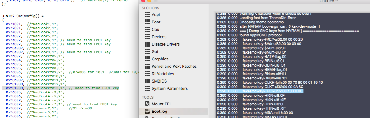

hello @Slice
i added macbook, macbookpro, macbookair, macmini about missing info in platformdata.c
complete list
AppleFirmwareVersion
AppleBoardID
AppleReleaseDate
AppleProductName
AppleFamilies
AppleSystemVersion
AppleSerialNumber
AppleChassisAsset
SmcRevision
not complete list
SmcPlatform
SmcConfig
- i dont know exactly value. especially SmcRevision, SmcConfig
- i dont know SetDMISettingsForModel’s code properly works each models
i made data from google search, everymac, ebay, geekbench browser
thanks in advance
platformdata.c.zip

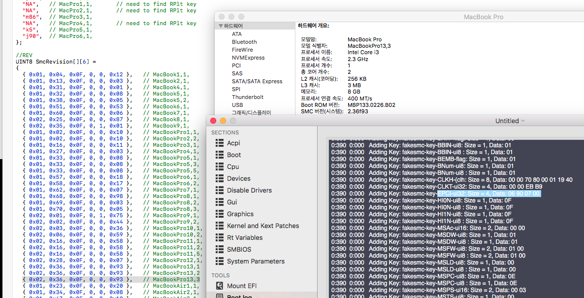

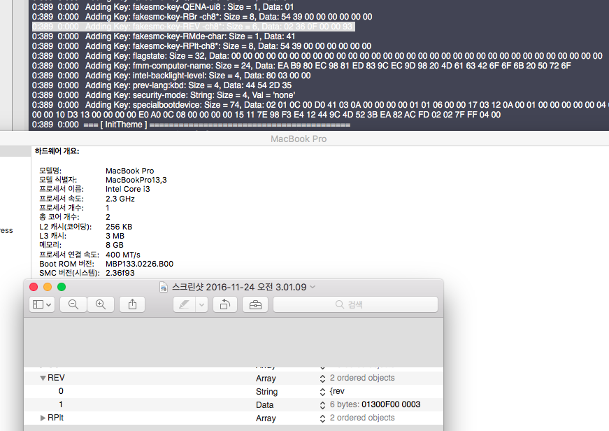

completed SmcRevision
UINT8 SmcRevision[][6] =
  { 0x01, 0x04, 0x0F, 0, 0, 0x12 },   // MacBook1,1,
  { 0x01, 0x13, 0x0F, 0, 0, 0x03 },   // MacBook2,1,
  { 0x01, 0x31, 0x0F, 0, 0, 0x01 },   // MacBook4,1,
  { 0x01, 0x32, 0x0F, 0, 0, 0x08 },   // MacBook5,2,
  { 0x01, 0x51, 0x0F, 0, 0, 0x53 },   // MacBook6,1,
  { 0x01, 0x60, 0x0F, 0, 0, 0x06 },   // MacBook7,1,
  { 0x02, 0x25, 0x0F, 0, 0, 0x87 },   // MacBook8,1,
  { 0x02, 0x35, 0x0F, 0, 1, 0x01 },   // MacBook9,1,
  { 0x01, 0x33, 0x0F, 0, 0, 0x08 },   // MacBookPro5,1,
  { 0x01, 0x58, 0x0F, 0, 0, 0x17 },   // MacBookPro6,2,
  { 0x01, 0x68, 0x0F, 0, 0, 0x99 },   // MacBookPro8,1,
  { 0x01, 0x70, 0x0F, 0, 0, 0x05 },   // MacBookPro8,3,
  { 0x02, 0x02, 0x0F, 0, 0, 0x44 },   // MacBookPro9,2,  2.03f36 for 10,1
  { 0x02, 0x03, 0x0F, 0, 0, 0x36 },   // MacBookPro10,1,
  { 0x02, 0x16, 0x0F, 0, 0, 0x58 },   // MacBookPro11,1,
  { 0x02, 0x28, 0x0F, 0, 0, 0x07 },   // MacBookPro12,1,
  { 0x02, 0x36, 0x0F, 0, 0, 0x93 },   // MacBookPro13,1
  { 0x01, 0x67, 0x0F, 0, 0, 0x10 },   // MacBookAir3,1,
  { 0x02, 0x05, 0x0F, 0, 0, 0x09 },   // MacBookAir5,2,
  { 0x02, 0x13, 0x0F, 0, 0, 0x09 },   // MacBookAir6,2,
  { 0x02, 0x27, 0x0F, 0, 0, 0x02 },   // MacBookAir7,1,
  { 0x01, 0x19, 0x0F, 0, 0, 0x02 },   // Macmini2,1,
  { 0x01, 0x30, 0x0F, 0, 0, 0x03 },   // Macmini5,1,
  { 0x02, 0x08, 0x0F, 0, 0, 0x00 },   // Macmini6,2,
  { 0x02, 0x24, 0x0F, 0, 0, 0x32 },   // Macmini7,1,
  { 0x01, 0x30, 0x0F, 0, 0, 0x01 },   // iMac8,1,
  { 0x01, 0x53, 0x0F, 0, 0, 0x13 },   // iMac10,1,
  { 0x01, 0x54, 0x0F, 0, 0, 0x36 },   // iMac11,1,
  { 0x01, 0x64, 0x0F, 0, 0, 0x05 },   // iMac11,2,
  { 0x01, 0x59, 0x0F, 0, 0, 0x02 },   // iMac11,3,
  { 0x01, 0x71, 0x0F, 0, 0, 0x22 },   // iMac12,1,
  { 0x01, 0x72, 0x0F, 0, 0, 0x02 },   // iMac12,2,
  { 0x02, 0x11, 0x0F, 0, 0, 0x14 },   // iMac13,1,
  { 0x02, 0x11, 0x0F, 0, 0, 0x14 },   // iMac13,2
  { 0x02, 0x14, 0x0F, 0, 0, 0x19 },   // iMac14,1
  { 0x02, 0x15, 0x0F, 0, 0, 0x07 },   // iMac14,2
  { 0x02, 0x22, 0x0F, 0, 0, 0x16 },   // iMac15,1
  { 0x02, 0x33, 0x0F, 0, 0, 0x10 },   // iMac17,1
  { 0x01, 0x30, 0x0F, 0, 0, 0x03 },   // MacPro3,1,
  { 0x01, 0x39, 0x0F, 0, 0, 0x05 },   // MacPro4,1,
  { 0x01, 0x39, 0x0F, 0, 0, 0x11 },   // MacPro5,1
  { 0x02, 0x20, 0x0F, 0, 0, 0x18 },   // MacPro6,1 :2.20f18
MacBook9,1 shown 2.35f101
i'm not sure this "  { 0x02, 0x35, 0x0F, 0, 1, 0x01 },   // MacBook9,1,"
not complete list
SmcPlatform
SmcConfig
@Slice, where can i find smcplatform data and smcconfig? if you give me tips, i will try
thanks
SmcConfig is EPCI key in reverse order (LittleEndian)
EPCI  [ui32]  0 (bytes 04 f0 07 00)  => 0x7f004
SmcPlatform is RPlt key in string from
RPlt  [ch8*]  (bytes 6b 37 34 00 00 00 00 00)   => "k74"
really thanks :)
here is final platformdata.c. i did clean up and i express value that i can't get EPCI and RPlt. if i get it in the future, i will report you
thanks in advance. have a nice day
platformdata-Final.zip

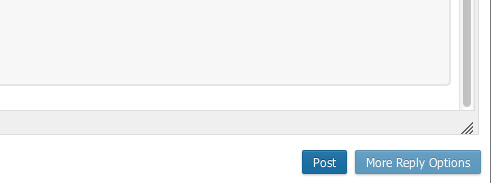

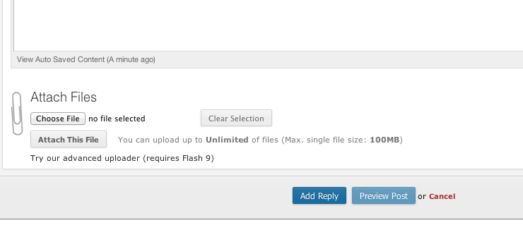

BTW, I'm new here and how to upload attachments? Thanks in advance. :-)
PMheart
First "More reply options"
Then "Choose file", "Attach", "Add to post"

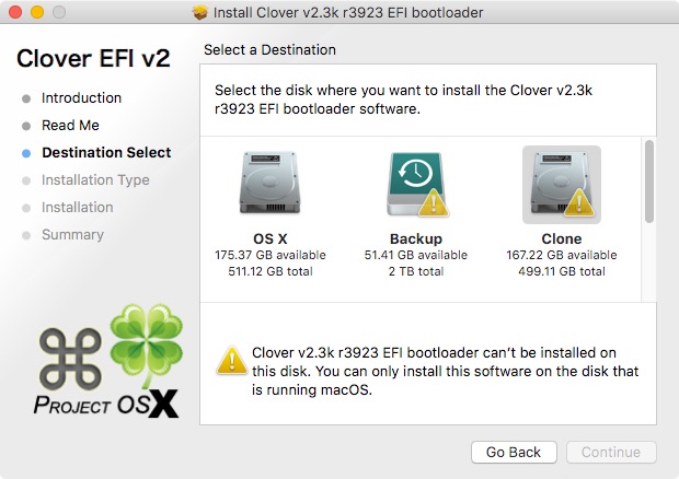

So why with the lastest installer of clover it only allows you to install it to the booted drive and not any other?
I wanted to update clover on the cloned drive. It is partitioned the same as my boot drive.
/dev/disk0 (internal):
   #:                       TYPE NAME                    SIZE       IDENTIFIER
   0:      GUID_partition_scheme                         512.1 GB   disk0
   1:                        EFI EFI                     209.7 MB   disk0s1
   2:                  Apple_HFS OS X                    511.1 GB   disk0s2
   3:                 Apple_Boot Recovery HD             650.0 MB   disk0s3
/dev/disk1 (internal, physical):
   0:      GUID_partition_scheme                        *500.1 GB   disk1
   1:                        EFI EFI                     209.7 MB   disk1s1
   2:                  Apple_HFS Clone                   499.1 GB   disk1s2
   3:                 Apple_Boot Recovery HD             650.0 MB   disk1s3
It has always worked before.
I replaced my FakeSMC info.plist with an unedited one to see.
It displays the default (wrong) SMC version in System Profiler (and IOReg), but bdmesg shows the correct SMC version is being injected.
What is your FakeSMC? It means Slice version or HWSensor.
I use Slice version. I unedit smc rev.
Correctly shown smc version from clover bootloader. Clover override rev value on my laptop
here is
