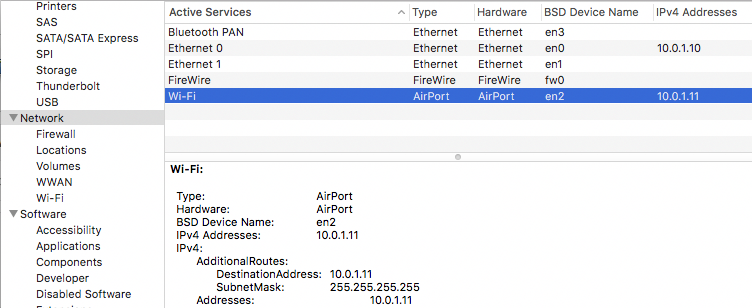

Would anyone be able to tell me if it is possible to have my Apple BROADCOM BCM94360CD WiFi card (Connected via a PCIe adapter) show up in the PCI section of System Report as I assume it does on a real Mac mini (I could be wrong but screenshots found on the Web suggest so)?
Currently it only shows up in the Network section...
I have tried adding an entry to the SMBIOS > Slots section of my Config.plist and also adding the fix "FixAirport_4000" but I ended up with it WiFi not working and an entry for a Dell WiFi card in the PCI section!
With the FixAirport command enabled I see this in the Boot.log...
0:660  0:000  Start Airport Fix
0:660  0:000  found Airport device [001C0004:0] at 37C3 And Name is PXSX
0:660  0:000  Name PXSX present at 0xA2, renaming to ARPT
0:660  0:000  Name PXSX present at 0xE0, renaming to ARPT
0:660  0:000  AirportADR=37C3 add patch size=EA
0:660  0:000  adr 37C3 size of arpt=17
I don't use a custom DSDT which is why I added the FixAirport entry but with this entry added the system reports no WiFi is installed.
Thanks for any advice!

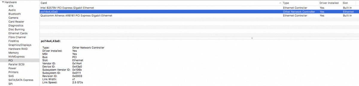

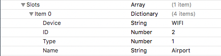

Basically yes,
If I add "FixAirport_4000" then it is no longer detected by macOS.
If I add the SMBIOS > Slots entry below without the Airport Fix I get a Dell WiFi card showing up but it doesn't work...
<dict>
	<key>Device</key>
	<string>WIFI</string>
	<key>ID</key>
	<integer>2</integer>
	<key>Type</key>
	<integer>1</integer>
	<key>Name</key>
	<string>Airport</string>
</dict>

Basically yes,
<dict>
	<key>Device</key>
	<key>ID</key>
	<key>Type</key>
	<key>Name</key>
</dict>
Set NoDefaultProperties=true
