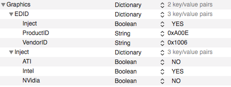

pkdesign Posted September 13, 2016 Share Posted September 13, 2016 Rev 3737 We can fake our EDID to be like Apple's one. Also changes in config.plist (old config also supported) <key>Graphics</key> <dict> <key>EDID</key> <dict> <key>Custom</key> <data>AP///////wAGECGSAAAAAAASAQOAIRV4CunVmVlTjigmUFQAAAABAQEBAQEBAQEBAQEBAQEB3iGgcFCEHzAgIFYAS88QAAAY3iGgcFCEHzAgIFYAS88QAAAAAAAA/gBXNjU3RwAxNTRXUDEKAAAA/gAjMz1IZYSq/wIBCiAgAJo=</data> <key>Inject</key> <true/> <key>VendorID</key> <string>0x1006</string> <key>ProductID</key> <string>0x9221</string> </dict> See, VendorID = 0x1006 is Apple This sounds interesting. What would be the benefit of doing this? Link to comment Share on other sites More sharing options...
Slice Posted September 13, 2016 Share Posted September 13, 2016 This sounds interesting. What would be the benefit of doing this? There was discussion at AppleLife #145 ... where people found that Sierra wants to see monitors made by Apple. Link to comment Share on other sites More sharing options...
Micky1979 Posted September 13, 2016 Share Posted September 13, 2016 To be Apple like for me nothing. But inject the real device id instead of a generic one is cool. Can be also used without the "Custom" data? EDIT I mean, my TV/monitor is/was in the Apple database (or at least was in /System/Library/Displays/Overrides (not checked in newer OSes), but was matching a real bad configuration (color too "hot"), but really OK for the same TV model ..not combo monitor..). I.e. using another edid for the same panel w/o the need to add the data... Link to comment Share on other sites More sharing options...
sebinouse Posted September 14, 2016 Share Posted September 14, 2016 This sounds interesting. What would be the benefit of doing this? This solved an old bug on my build : sometimes I had a black background on my desktop instead of the image I chose ... not any longer ! But no improvement on DRM protected videos (iTunes,QT)/ Dailymotion (webkit) freeze on macOS10.12 on haswell IGPU (Clover r3739) Link to comment Share on other sites More sharing options...

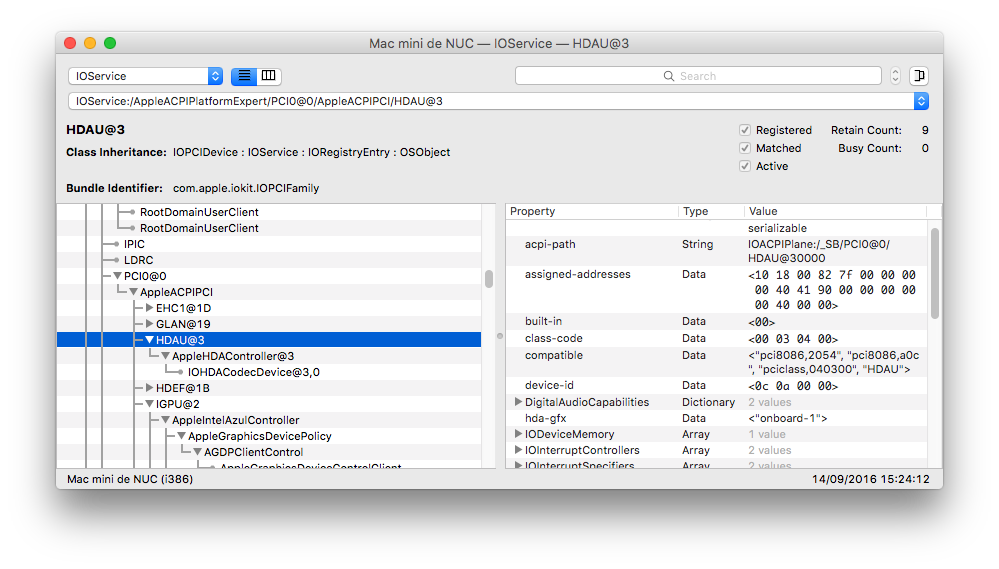

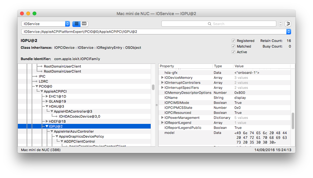

sebinouse Posted September 14, 2016 Share Posted September 14, 2016 This solved an old bug on my build : sometimes I had a black background on my desktop instead of the image I chose ... not any longer ! I've just noticed that it broke my HDMI audio Both HDAU & IGPU are "onboard-1" ... but codec not detected as it use to be ... Even if I use "UseIntelHDMI" it still don't work (I use IGPU and not GFX0). any advice ? Link to comment Share on other sites More sharing options...
Slice Posted September 14, 2016 Share Posted September 14, 2016 My advice is VoodooHDA. Link to comment Share on other sites More sharing options...
sebinouse Posted September 14, 2016 Share Posted September 14, 2016 My advice is VoodooHDA. HDMI out recognized but no sound ... Is there an Apple Display that handle HDMI audio ? If so do you know is EDID ? Link to comment Share on other sites More sharing options...
Slice Posted September 14, 2016 Share Posted September 14, 2016 HDMI out recognized but no sound ... Is there an Apple Display that handle HDMI audio ? If so do you know is EDID ? May be MacMini output sound to TV-set through HDMI. But the TV assumed not Apple's. Otherwise iMac has own monitor. MacBook as well. Old Apple display has USB connector for sound and brightness. New Apple Display has thunderbolt connector. Not sure if Apple ever used HDMI except MacMini. Link to comment Share on other sites More sharing options...
