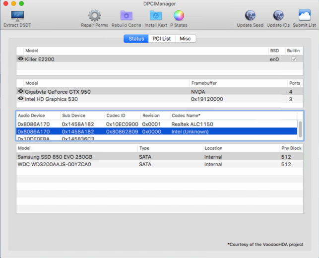

There is no Realtek device (I looked for the Realtek ID 10EC) in boot log. So I'm not sure how would I use the Arbitrary feature of Clover. However, it seems to be recognized in DPCI Manager.
Guys, can anyone, please, fix the Clover Audio layout-id injection for Skylake? It's the best and the easier method to get that fixed. Seems I'm not the only one with this issue. I know it's probably easier said than done, but if I can help in any way (other than coding, that is, since I don't have the knowledge for that), I would be happy to do it.
IN the meantime, I'm trying the Arbitrary method to inject layout-id=1
Could you guys please, take a look and tell me if it's ok, or if I need all that? Like do I need "model" and "built-in"? Also, can anyone, please, tell me, how to calculate these Base64 values like AQAAAA==? Base64decode.org, for example, shows this:post-1303722-0-19112600-1466248407.png . What the hell is that? :))

Yep but remembar to find the cause of the layout-id = 0 in your ioreg because is not a Clover fault  :P

:D Well...I plan to do that. But if it's not the CPU (although other people with the same CPU architecture, namely Skylake, are having the exact same issue, can't be a coincidence), what else can it be? I do want to learn and I do want to find out the cause of this. I don't even know where to start my investigation. :))
So far, two people said it's an issue with Clover's layout-id injection being not supported (yet) for Skylake. These are still very new CPUs so to me, it's quite to be expected not to have support for everything. It's normal. But I honestly don't know what else could it be. If you have a way of finding out the cause of this issue, please, do tell me. I'm all in favor of that. I just don't know where to start. :(
Having a layout-id set in the ioreg is not a coincidence :D (the starting point for you should be there IMHO)

It has been a while since I looked at it, but from what I remember Clover cannot find the PCI audio device on (some) Skylake because it is searching for PCI class incorrectly...
Note that Apple changed the class match for AppleHDAController because they made the same mistake:
10.7.5 and 10.11.5 happen to be the two versions I have installed on my desktop:
10.7.5: IOPCIClassMatch=0x04020000&0xFFFE0000
10.11.5: IOPCIClassMatch=0x04010000&0xFFFD0000
It is possible Clover code was based on the old/wrong IOPCIClassMatch.
I don't use Clover audio inject (prefer ACPI or /Devices/Arbitrary), so I didn't bother trying to fix it...

It is not a layout XML problem. It is a problem trying to use config.plist/Audio/Inject to inject layout-id.
Clover has to find the PCI device for onboard audio... and the mask/compare it is using to compare the PCI class is wrong and only works pre-Skylake (or SKL systems without the alternate HDA class).
This is the code, Settings.c/SetDevices:
        else if (gSettings.HDAInjection &&
                 (Pci.Hdr.ClassCode[2] == PCI_CLASS_MEDIA) &&
                 (Pci.Hdr.ClassCode[1] == PCI_CLASS_MEDIA_HDA)) {
          //no HDMI injection
          if ((Pci.Hdr.VendorId != 0x1002) &&
              (Pci.Hdr.VendorId != 0x10de)) {
            TmpDirty    = set_hda_props (PciIo, &PCIdevice, Entry->OSVersion);
            StringDirty |= TmpDirty;
PCI_CLASS_MEDIA is defined in Pci22.h:
#define PCI_CLASS_MEDIA               0x04
PCI_CLASS_MEDIA_HDA is defined in Platform.h:
#define PCI_CLASS_MEDIA_HDA         0x03
Some SKL systems have the HDAS as:
0:101  0:000  PCI (00|00:1F.03) : 8086 A170 class=040100
It matches against the updated IOPCIClassMatch for AppleHDAController, but does not match for what Clover is looking for.
An EFI/Clover + Clover bootlog + ioreg should help clarify what is happening...
