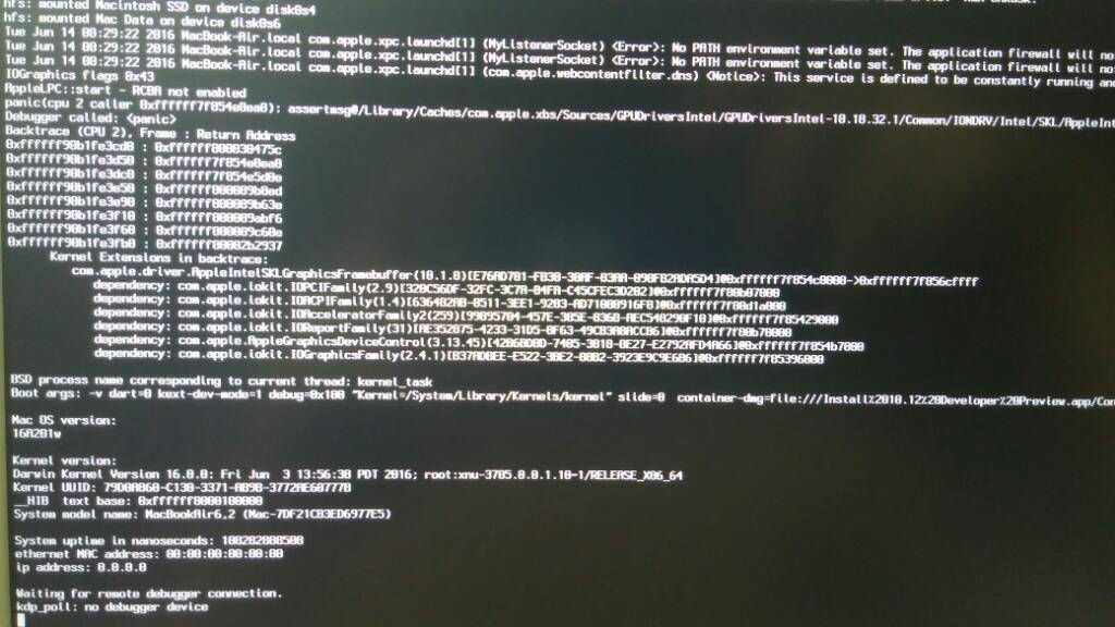

Skylake Driver panic, i use kext patch, but not success.
10.12 SIERRA
AppleIntelSKLGraphicsFramebuffer
45 C8 39 C6 76 51
45 C8 39 C6 EB 51
NOT SUCCESS ABOVE CODE.
I compared el capitan code and sierra, it's same root and functions.
I think we have to fix kext injection full.
