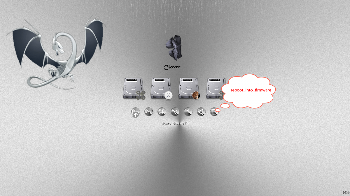

Hey @Slice. I have an enhancement request that could save many headaches with setting UEFI to "Ultra Fast" boot mode. I have been searching for a long time for how Windows does its "Restart to Firmware" button and never got any good results via googling. However just randomly while doing something else I came across an open source implementation of it. Since this is low priority most likely I may end up doing it myself and submitting a patch, however I have never setup a EDKII environment before so it might not be for a while. If you want to take a stab at it before I get around to it here is a pretty clean concise implementation from the bus1 repo.

Not sure what about you.
If that is the "Exit Clover" button, all it does is throw me to a black screen till I manually reset. I'm booted with CSM disabled and secure boot disabled. If that is a dedicated "Reboot into Firmware" button I do not have it o.o I checked the clover revisions at sourceforge and didn't see any commit after my currently installed revision about adding that feature. I'm running 3320 installed from the official package on sourceforge. I know my system supports OsIndications since A. Windows uses it fine and B. manually setting it in OS X via "sudo nvram 8BE4DF61-93CA-11D2-AA0D-00E098032B8C:OsIndications=%01%00%00%00%00%00%00%00 && sudo reboot" reboots into my UEFI setup properly. I see EFI_OS_INDICATIONS_BOOT_TO_FW_UI ​referenced in OsxDxeCore, however I didn't take the time to trace it back extensively and I didn't see how it could be connected to the "Exit Clover" button(I only looked for like 5 minutes, you know your source better than I could glean in a short amount of time :P).

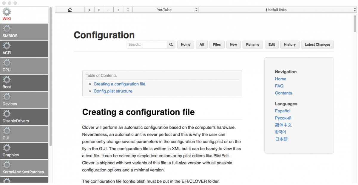

Not really a problem since Chrome can, warning me about insecure connection,.... but the fact is that I made my onw config.plist editor + web broswer with embedded wiki.
Using cocoa I'm experiencing the same behavior, so I'm going to accept the ssl connection by trusting the invalid certificate (ie accepting eliptik.fr as domain)... I'v only to wrote code to install this new one to the key chain.

OsxDxeCore is not used for Clover on UEFI systems, I think it is added in favor of DxeCore into the DUET image, when building the legacy version. I don't think Clover currently supports that functionality, but I guess if you create a patch, Slice will commit it for you.
I'll take a stab at it then :) Should I just default to reboot into firmware if a user presses the "Exit Clover" button you think? Or should I add a new button if OsIndicationsSupported is found? I don't know the UEFI spec well, however I thought that an exit button should tell tell the EFI to continue down the boot order chain.
Yes, exit should remain exit. Though I'm not sure if exiting Clover even makes sense as it does a few overrides quite early, in my opinion it's risky to let the boot flow continue. So, either Clover should be adapter to clean up when it is terminated (EFI_LOADED_IMAGE_PROTOCOL.Unload), or there should be only Reboot, Shutdown and Reboot into Firmware. Just my 2 cents.
