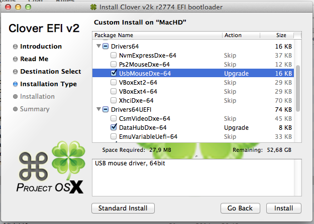

I am dual booting Windows 8.1 and Mac OS X Mavericks in uefi mode and have added the Mouse key under GUI in config.plist. However my mouse doesn't work when the GUI loads. Do I need to add any additional drivers to drivers64uefi?
Any help will be appreciated. Everything else works, just want to use my mouse as my keyboard is bluetooth and isn't available until the OS loads.

May be this one will help you?
Yes, after installation you have to move it to drivers64UEFI
EDITED.
Be sure mouse enabled in config.plist and Speed is not zero.

Thank you for the reply. Those options aren't available with 'Install for UEFI booting only'. Do I add the driver after the initial installation? In doing so will it affect the current EFI installation?
Regards

I am not clear why you want to install Clover "for UEFI only". I installed without this claim and have both method to boot legacy and UEFI and I see no negative profit for this.
Currently I am using UEFI boot.
The installer will place Mouse driver into folder /EFI/CLOVER/drivers64/ while you need it in folder /EFI/CLOVER/drivers64UEFI/ for UEFI boot.
It was proposed that UEFI Firmware always have this driver. In other case you may manually copy this driver from one folder to another one.

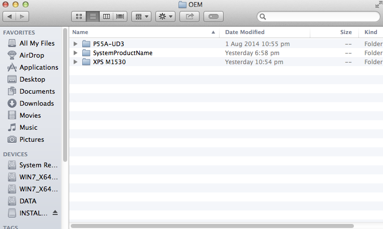

It looks like the latest Clover revisions break loading of config.plist from the OEM folders if the folder name has a space.
I use EFI/Clover/OEM folders to load different config.plists for my laptop and desktop (so I can use the same Yosemite Installer USB for both rigs)....
With Clover r2793 on my laptop XPS M1530, the config.plist does not load from /EFI/Clover/OEM/XPS M1530 but /EFI/Clover ....

With Clover r2758 it is working from EFI\CLOVER\OEM\XPS M1530 ....

Oddly enough, for my desktop, the config.plist loads properly from /EFI/Clover/OEM/P55A-UD3 folder using Clover r2793 ....

Maybe because there is no space in the folder name for that system.
Edit
Fixed.  I actually had to add a space at the end of the folder name ie "XPS M1530 " and now loading from the OEM folder.  Thanks Slice :).
Anyone know why I can't get Clover to boot on my new BIOS? I flashed the latest UEFI beta BIOS for my board so I could take advantage of my new GOP VBIOS. unfortunately, it won't boot anything except Windows 8. Secureboot is disabled, I tried "Other OS," "Windows 8," Windows 8 WHQL," etc. But no matter what it only boots Windows. Everything else leads to a blinking cursor. I did manage to boot an Arch Linux install drive but that's it. My regular Arch disk and my Clover disk do not boot.
12:344  0:025  Using OEM config.plist at path: EFI\CLOVER\OEM\XPS M1530 \config.plist
12:345  0:000  EFI\CLOVER\OEM\XPS M1530 \config.plist loaded: Success
Try to exclude ending space from the name "XPS M1530 "

   need some help.
hardware:  MSI B75A-S40    8gb mem, UEFI booting.
created a usb installer using clover 2774 and yosemite public beta 1.  i used the config.plist from my working mavericks install on the same computer.
successfully installed Yosemite beta to a spare HD.
i installed clover 2774 to the yosemite HD, then copied my EFI folder from the USB stick to the yosemite HD/EFI partition.
upon reboot, just got black screen/apple logo/no progress indicator.  the hard disk access light on the front panel flashed briefly then went out.
tried booting in safe mode.  boot proceeded, setup assistant started, but hung (spinning gear wheel) at the end of the setup--on the "Setting up your mac" screen.
i rebooted, again in safe mode, got the sign-in screen, entered my password, but hung at that screen (spinning gearwheel and spinning beach ball).
booted in verbose mode--after just a couple of lines of verbose messages, got the message:  AptioDrvFix--requested memory exceeds our allocated relocation block
then message that boot would halt for 30 secs, after which nothing happened.
i've attached my config.plist.
i did create a 10.10 folder within the kexts folder on the yosemite HD, and copied the kexts into it from the 10.9 folder on my mavericks HD.
any suggestions?
thanks
EDIT:  turns out that the clover 2774 install on the yosemite HD will not boot my mavericks install, either.  same symptoms: booting in normal mode, lack of gearwheel below the apple logo, no HD access light.  in verbose mode, same error message from AptioDrvFix about requested memory exceeds our allocation block.
config.plist.zip

Have you tried LowMemFix instead of AptioDrvFix?
