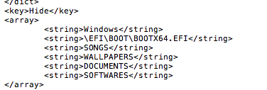

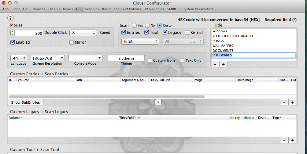

hack.in Posted April 21, 2014 Share Posted April 21, 2014 Thank you @fusion71au Here is my method what i used : i just added some new entries in Hide tab in Clover Configurator Result and Config.plist edited is same as Slice and clover wiki method : #12 PS:May be Easiest way i have found Link to comment Share on other sites More sharing options...
Maniac10 Posted April 21, 2014 Share Posted April 21, 2014 Assuming SONGS, WALLPAPERS, DOCUMENTS and SOFTWARES aren't bootable you shouldn't be required to hide them cause Clover just won't show them anyway. Link to comment Share on other sites More sharing options...
hack.in Posted April 21, 2014 Share Posted April 21, 2014 Assuming SONGS, WALLPAPERS, DOCUMENTS and SOFTWARES aren't bootable you shouldn't be required to hide them cause Clover just won't show them anyway. yep you are right Link to comment Share on other sites More sharing options...

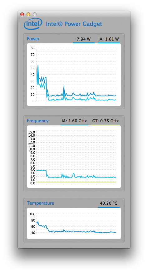

toleda Posted April 23, 2014 Share Posted April 23, 2014 Problem with Intel Power Gadget frequencies compared to Chameleon Z77-I Deluxe/i7-3770K/10.9.2 Chameleon_v2248 IPG freq scale: 0-3 GHz sysctl -A: hw.busfrequency = 100000000 Clover_v2636: IPG freq scale: 0-15 GHz sysctl -A: hw.busfrequency = 400000000 System runs fine. Proposed fix: config.plist/CPU/BusSpeedkHz=100000 Correct? Other suggestions? Link to comment Share on other sites More sharing options...
Pike R. Alpha Posted April 23, 2014 Share Posted April 23, 2014 Please verify if Clover is still injecting SMBIOS table 132 with a value of 0, because then AppleSMBIOS.kext will multiply the bus frequency with a factor 4 (old style quad pumped FSB). Link to comment Share on other sites More sharing options...

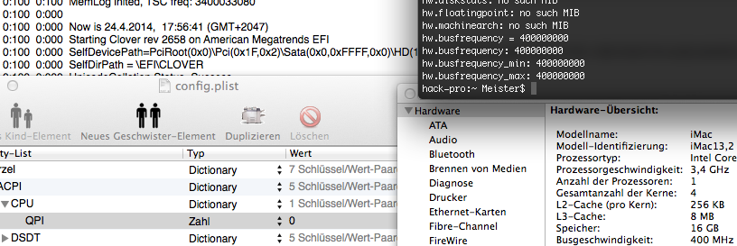

Slice Posted April 25, 2014 Share Posted April 25, 2014 Hi Slice, For me table 132 have been dropped. localhost:~ fred$ sysctl -a | grep freq hw.busfrequency = 400000000 hw.cpufrequency = 3403000000 hw.tbfrequency = 1000000000 hw.busfrequency: 400000000 hw.busfrequency_min: 400000000 hw.busfrequency_max: 400000000 hw.cpufrequency: 3403000000 hw.cpufrequency_min: 3403000000 hw.cpufrequency_max: 3403000000 hw.tbfrequency: 1000000000 machdep.tsc.frequency: 3403358623 Fred Cool, but don't inject SMBIOS table 132 when the value is 0 (zero) because that is the problem here. So, this is wrong suggestion. Link to comment Share on other sites More sharing options...

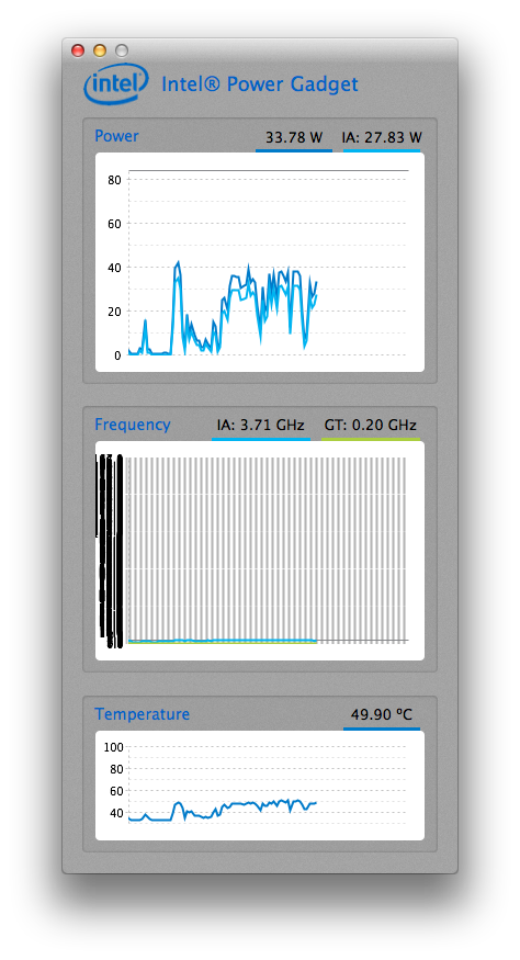

Pike R. Alpha Posted April 25, 2014 Share Posted April 25, 2014 So, this is wrong suggestion. No. Please look at SMBIOS tables of Mac models and you won't find table 132. Not when it shouldn't be there. Not for Sandy Bridge, Ivy Bridge and Haswell models. See also AppleSMBIOS.kext so if people are still seeing 400MHz / hw.busfrequency [factor 4] then something else is wrong, but table 132 should not be injected. Edit: I added table 132 to RevoBoot and BOOM. Frequency scale in the Intel Power Gadget went nuts! Without this table there is no problem. Same thing with Chameleon/Chimera. 1 Link to comment Share on other sites More sharing options...
Slice Posted April 25, 2014 Share Posted April 25, 2014 Frequency scale in the Intel Power Gadget went nuts! See my screenshot #4265 Link to comment Share on other sites More sharing options...
