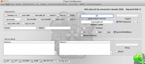

In my case with uefi installed Windows 7, my mistake was to omit EFI as the Default Boot Volume (only had bootmgfw.efi as Default Loader).
To fix the problem, you need to
  • Delete your current NVRAM settings...in terminal
sudo rm /nvram.plist
sudo nvram -c
  • Edit your config.plist, entering the Default Boot Volume and ticking IgnoreNVRAMBoot with Clover Configurator...
  • With the correct config.plist settings, everything works as expected...

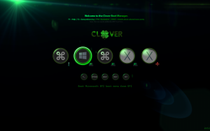

which removes legacy entries (since I have uefi Windows) and the "Boot UEFI internal from EFI".
Looks like this in Clover Configurator:
My boot screen only has UEFI Windows 7, OS X Mavericks and the Recovery Partition:
