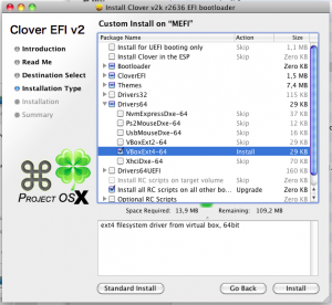

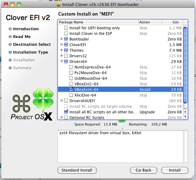

Thunderbolt Posted March 21, 2014 Share Posted March 21, 2014 I have an issue , I have a Ubuntu 13.10 Ext4 installation and mavericks on a GPT on the same HDD, but in Clover boot loader I am unable to see the Linux partition. Can someone please help. My work documens are on it. Link to comment Share on other sites More sharing options...
xpamamadeus Posted March 21, 2014 Share Posted March 21, 2014 I have an issue , I have a Ubuntu 13.10 Ext4 installation and mavericks on a GPT on the same HDD, but in Clover boot loader I am unable to see the Linux partition. Can someone please help. My work documens are on it. Do u have Clover UEFI or legacy? If its UEFI then u maybe need ext4 driver. Link to comment Share on other sites More sharing options...
Thunderbolt Posted March 21, 2014 Share Posted March 21, 2014 Do u have Clover UEFI or legacy? If its UEFI then u maybe need ext4 driver. I think EFI , but I can install clover again , Which ext4 driver ? Link to comment Share on other sites More sharing options...

Thunderbolt Posted March 23, 2014 Share Posted March 23, 2014 Screen shot 2014-03-21 at 17.04.38.png I did that, it gave me the linux partition and I could boot in to linux. but when I try to boot in to Mavericks it will reboot. I guess I am off OS x now, l will keep linux and windows. Link to comment Share on other sites More sharing options...

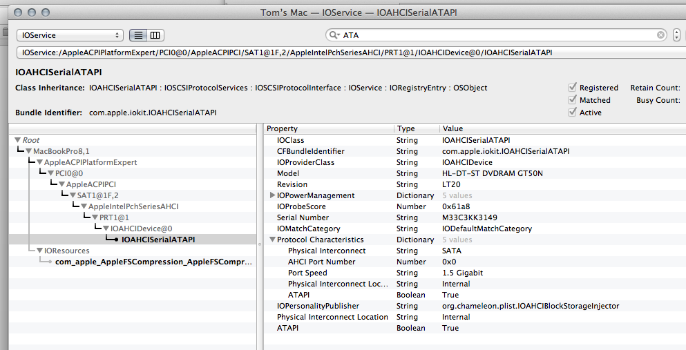

tluck Posted March 24, 2014 Share Posted March 24, 2014 what would be the best way to convert from what IOAHCIBlockStorageInjector.kext does to make the ATAPI DVD internal vs external by using something in Clover config.plist. Should I add _DSM patch to DSDT? or Device add property? kext patch? I have seen a few examples, but did not see one that seems to just address making DVD internal. I was thinking of a property string but was not sure the what the PCI address would be? would it be this?: PciRoot(0x0)/Pci(0x1f,0x2) Anyway any pointers, snippets would be appreciated.... just trying to remove 1 more custom kext. the code (properties) in the kext is: <key>IOKitPersonalities</key> <dict> <key>IOAHCISerialATAPI</key> <dict> <key>ATAPI</key> <true/> <key>CFBundleIdentifier</key> <string>com.apple.iokit.IOAHCISerialATAPI</string> <key>IOClass</key> <string>IOAHCISerialATAPI</string> <key>IOProbeScore</key> <integer>25000</integer> <key>IOProviderClass</key> <string>IOAHCIDevice</string> <key>Protocol Characteristics</key> <dict> <key>Physical Interconnect</key> <string>SATA</string> <key>Physical Interconnect Location</key> <string>Internal</string> </dict> </dict> </dict> ioreg shows the DVD device: Link to comment Share on other sites More sharing options...
