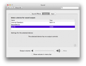

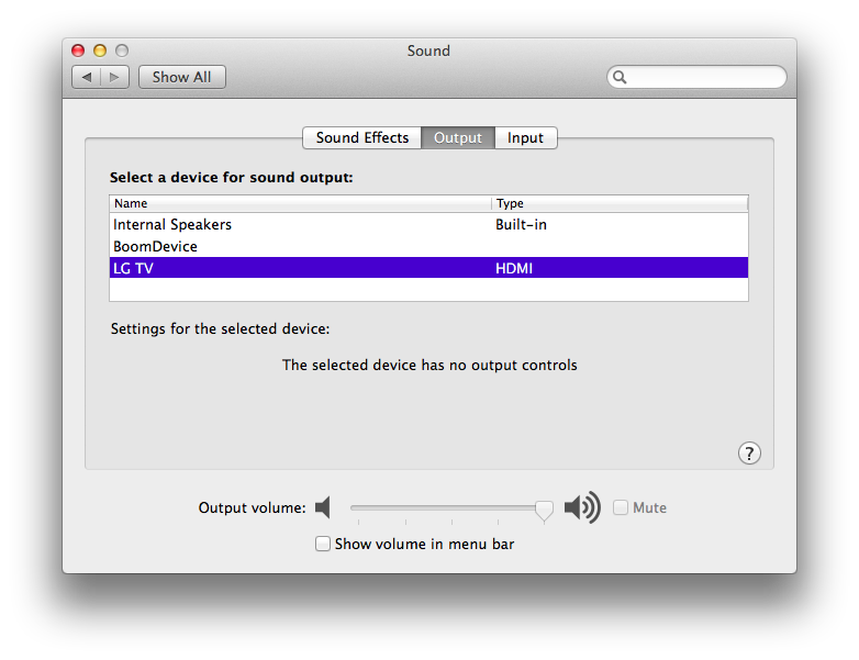

Allan Posted February 28, 2014 Share Posted February 28, 2014 hi, are you talking to me? no, I am showing the results Not required: AddHDMI_8000000, NewWay_80000000 why? I'll try without these flags, then come back with results. Update: Work without AddHDMI_8000000, NewWay_80000000. Update 2: I need to use it? Link to comment Share on other sites More sharing options...
Allan Posted February 28, 2014 Share Posted February 28, 2014 tested and worked without: now my audio and video HDMI works great with Clover!! Inject Intel, UseIntelHDMI, Audio Inject, ig-platform-id. 1 Link to comment Share on other sites More sharing options...

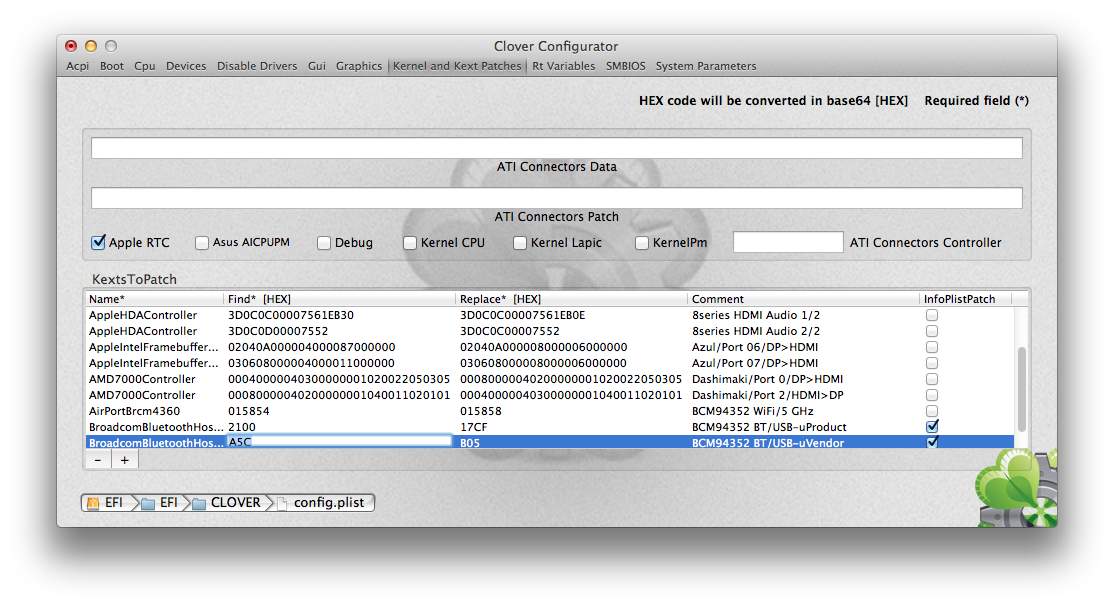

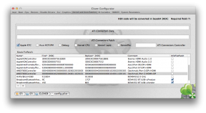

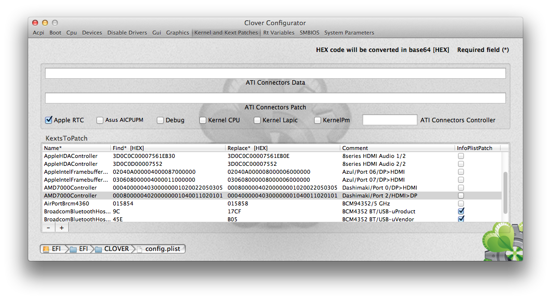

toleda Posted March 1, 2014 Share Posted March 1, 2014 Z87I-Deluxe/HD4600/HD7750/BCM4352/10.9.2/2618 Clover Bluetooth/Not working - Suggestions? 2616-2 KextsToPatch/BroadcomBluetoothHostControllerUSBTransport/uProduct and uVendorI/nfo.plist - not working 2613-3 Clover/kexts/10.9/bcm4352bt/Info.plist - working 2618-2.zip 2618-3.zip Link to comment Share on other sites More sharing options...
Slice Posted March 1, 2014 Share Posted March 1, 2014 Kexts Find and Replace must be the same length. Link to comment Share on other sites More sharing options...
toleda Posted March 1, 2014 Share Posted March 1, 2014 Kexts Find and Replace must be the same length. Of course. 2nd try, Bluetooth Not Available. 2618-4.zip Link to comment Share on other sites More sharing options...
Slice Posted March 1, 2014 Share Posted March 1, 2014 Why not make 4 characters string? Link to comment Share on other sites More sharing options...
toleda Posted March 1, 2014 Share Posted March 1, 2014 Why not make 4 characters string? Trying to patch this entry in the native Info.plist. Suggestions? <key>BroadcomUSBBluetoothHCIController_Dongle</key> <dict> <key>CFBundleIdentifier</key> <string>com.apple.iokit.BroadcomBluetoothHostControllerUSBTransport</string> <key>IOClass</key> <string>BroadcomBluetoothHostControllerUSBTransport</string> <key>IOProviderClass</key> <string>IOUSBDevice</string> <key>idProduct</key> <integer>8448</integer> <key>idVendor</key> <integer>2652</integer> </dict> Find: 8448 0x2100 2652 0xa5c Replace: 6095 0x17cf 2821 0xb05 Link to comment Share on other sites More sharing options...

alexanderq Posted March 1, 2014 Share Posted March 1, 2014 Trying to patch this entry in the native Info.plist. Suggestions? <key>BroadcomUSBBluetoothHCIController_Dongle</key> <dict> <key>CFBundleIdentifier</key> <string>com.apple.iokit.BroadcomBluetoothHostControllerUSBTransport</string> <key>IOClass</key> <string>BroadcomBluetoothHostControllerUSBTransport</string> <key>IOProviderClass</key> <string>IOUSBDevice</string> <key>idProduct</key> <integer>8448</integer> <key>idVendor</key> <integer>2652</integer> </dict> Find: 8448 0x2100 2652 0xa5c Replace: 6095 0x17cf 2821 0xb05 Hello toleda To make that work you have to read this http://www.projectosx.com/forum/index.php?showtopic=2562&view=findpost&p=27408 and then you'll understand why its not working. 1 Link to comment Share on other sites More sharing options...
toleda Posted March 2, 2014 Share Posted March 2, 2014 you'll understand why its not working. Thanks, vey helpful. I will load edited plists from EFI/Clover/kexts/10.9 Link to comment Share on other sites More sharing options...
