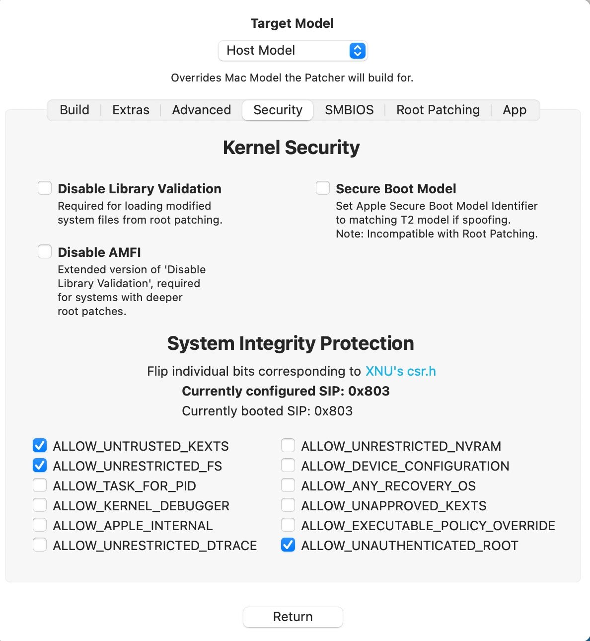

A couple of hours ago I tested Clover on my PC with Fenvi-T919 and:
  • Clover has compiled fine the code (Xcode 15.1)
  • Sonoma has booted well without settings for Broadcom Wi-Fi
  • Sonoma has booted well with the settings for Broadcom Wi-Fi (no more KP with IOSkywalk enabled)
  • OCLP has detected the available patch (Modern Wireless) and has applied it correctly
  • Broadcom wifi works fine, same as with OpenCore.

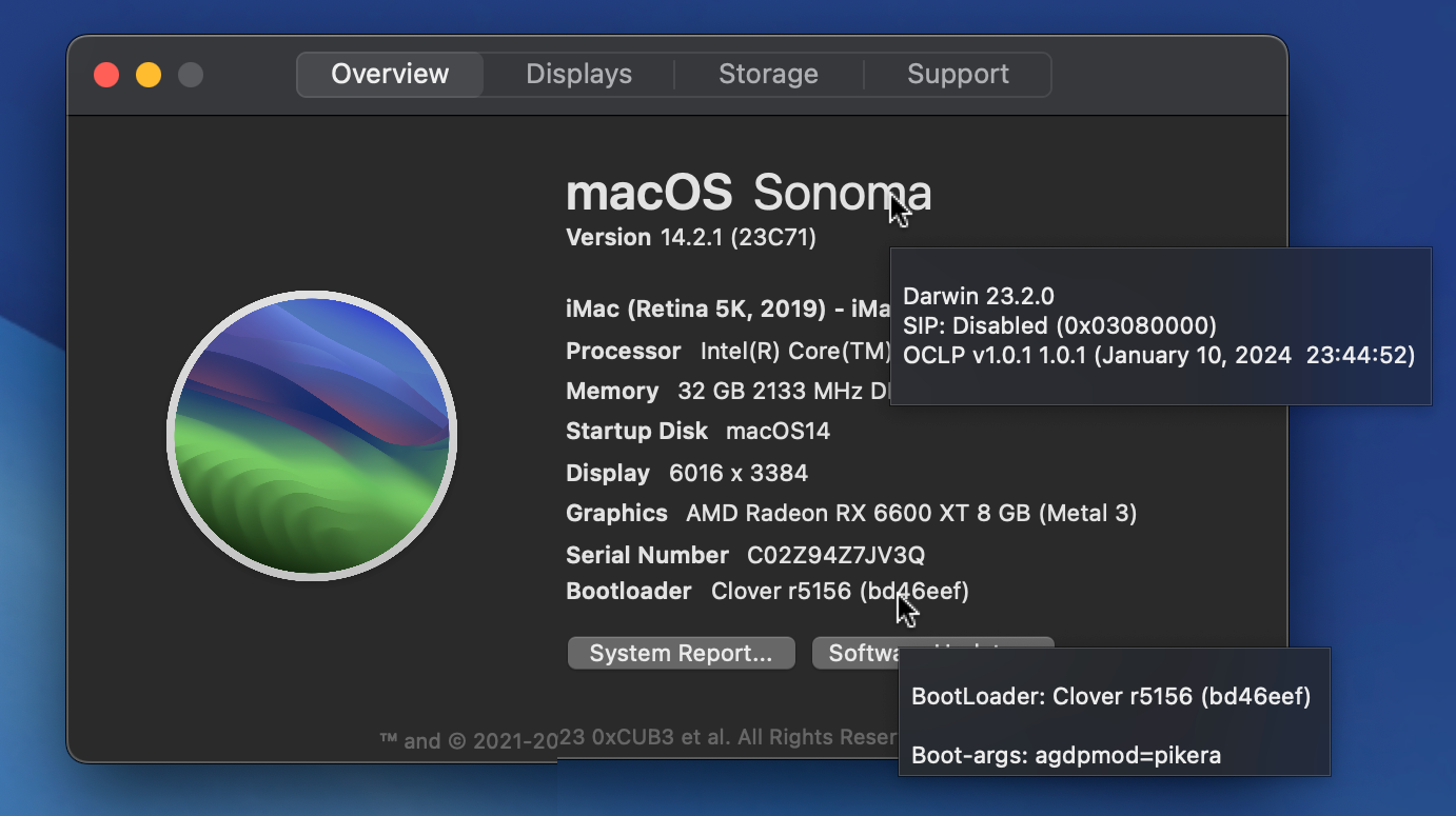

On 12/9/2023 at 7:33 PM, jsl2000 said:
It's very strange that Clover 5156 specific version can boot Sonoma 14.2 in my B85M-G hackintosh with BlockSkywalk enabled and WiFiBCM4352 working too after applied OCLP 1.3.0n.
I'm very glad to confirm that this Clover 5156 version also worked in my Z97 hackintosh too !
Unfortunately it still got hang in early boot in my Z690, Z490, X299 & Z370 hackintoshs as well as Haswell laptop if BlockSkywalk was enabled.
In my FX-6300 hackintosh it got red screen panic if BlockSkywalk quirk was enabled.
Thanks for Jief because his new version of Clover 5156 can boot my FX-6300 hackintosh at Sonoma without red screen now !

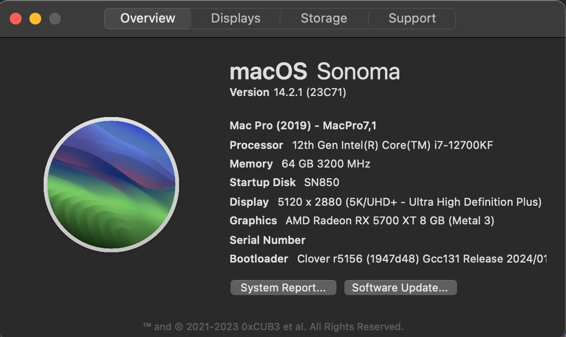

Everything, including the BlockSkywalk quirk, works fine, except displaying the order of memory slots. Physically the memory is located in slots 1 and 3, but in the profiler it appears as if it is in slots 3 and 4.
Spoiler

@MakAsus,
Does the order of slots depend on SMBIOS? I see you use MacPro7,1 which has very specific memory configuration.
Try to set iMacPro1,1 or Macmini8,1
27 minutes ago, Slice said:
@MakAsus,
With Macmini8.1 does not start. With iMacPro1.1 nothing changes, but in OpenCore and MacPro7.1 everything is displayed correctly. In the Preboot.log, everything is correct too. This glitch appeared a long time ago, I noticed it on on my old Ivy Bridge who is no longer on the profile.
Edited by MakAsus
It was a problem that different Macs have different memory map so we didn't come to final solution. One wants this, other wants other.
I will looks what to do to make memory map good for you and me.
SMBIOS->Trust = false?
Yes SMBIOS->Trust = false.
I understand so we didn't come to final solution. And I also just want so that it becomes as it was earlier in Clover and as it is in OpenCore now. The last release in which I saw the correct memory map, it seems to me, was v5.0 r5119.
Edited by MakAsus
