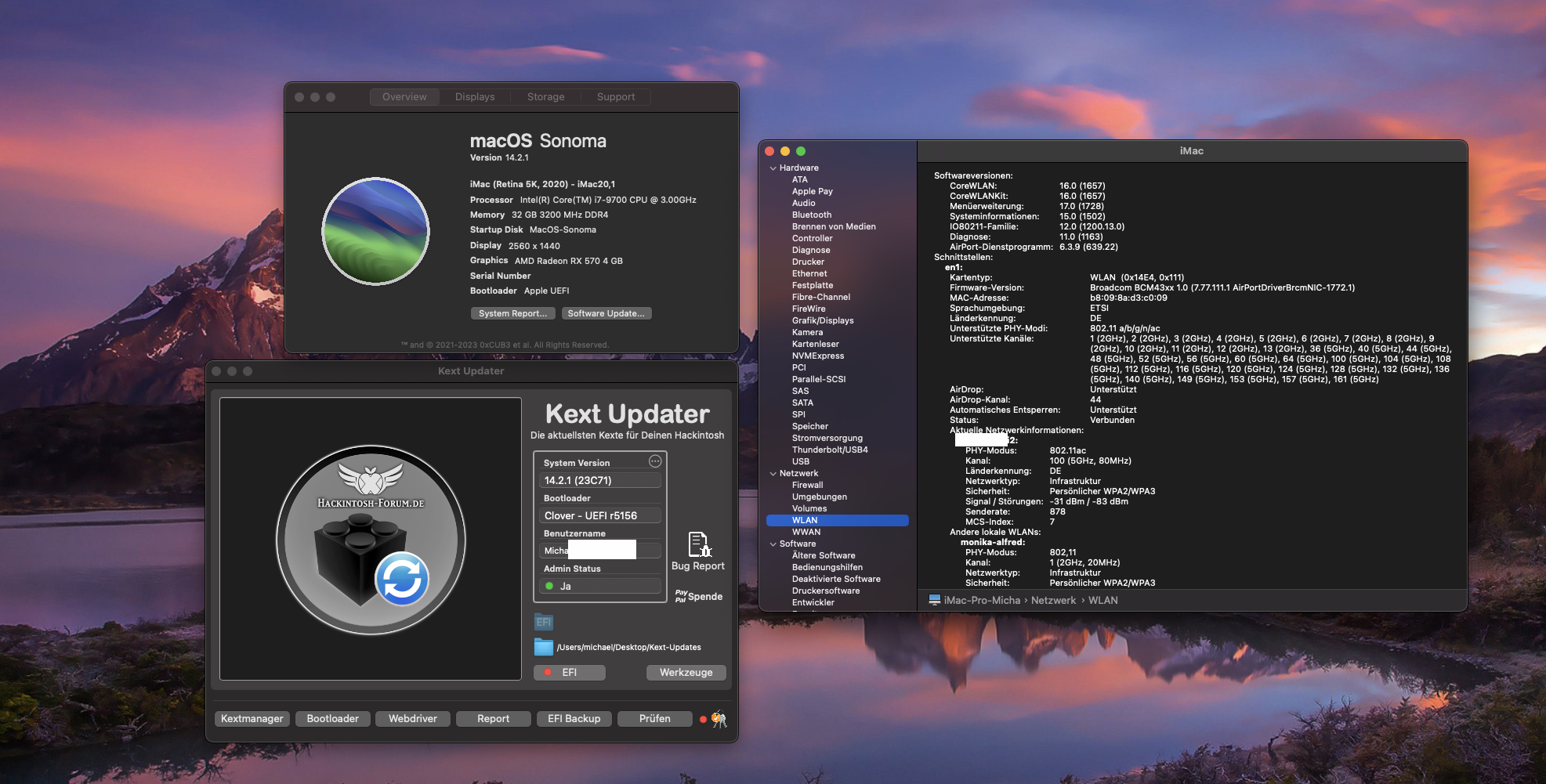

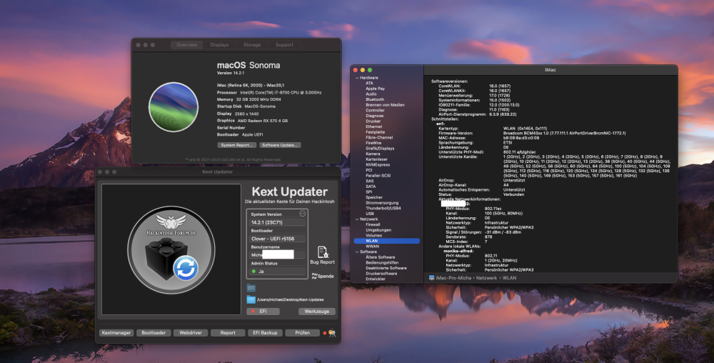

matxpa Posted December 10, 2023 Share Posted December 10, 2023 Just now, cankiulascmnfye said: @matxpa If you can provide a compiled build of your merged version, I could test it on my machine. Hi r5156_bdb7a95 with BlockSkywalk set to TRUE and kexts/14 IOSkywalkFamily.kext --> BCM4360 (0x43a014e4) work fine Clover X64 r5156_bdb7a95 (20231116-22h10) XCODE15 RELEASE --> CloverX64_r5156_20231116-22h10_bdb7a95_XCODE15_RELEASE_master_local.efi r5156_0eac408 with BlockSkywalk set to FALSE and kexts/14 IOSkywalkFamily.kext Disabled (in block kexts in Clover submenu before booting on Sonoma (SSD or HD) Device--> BCM4360 cant' work), if BlockSkywalk stay TRUE and IOSkywalkFamily.kext stay Enabled --> boot hangs (after +/- 10 debug lines in verbose mode) Clover X64 r5156_0eac408 (20231208-19h20) XCODE15 RELEASE --> CloverX64_r5156_20231208-19h20_0eac408_XCODE15_RELEASE_master_local.efi You have to rename those '.efi' to BOOTX64.efi and CLOVERX64.efi (but you know that) Regards 2 1 Link to comment Share on other sites More sharing options...
matxpa Posted December 10, 2023 Share Posted December 10, 2023 (edited) 33 minutes ago, datafeedexpert said: @matxpa i followed these step but still i unable to boot sonoma , there is early KP , while sonoma boot if i moved IOS family kexts from 14 folder or False = Blockskywalk Hi If you use a Clover build with a9b0654 commit to bdb7a95 commit, it could (fingers crossed) work with BlockSkywalk set to TRUE and kexts/(14 or Other) IOSkywalkFamily.kext (and IO80211FamilyLegacy.kext) but it depends of (what Bios ? SMBios ? config content (DSDT/SSDT patches, KestToLoad patches, quirks, devices list and/or content ?), so it works on some Hardware, not on all (it's not necessary a Hard pbm) If you use a Clover build with commit 32fbf76 commit (you can't with this commit Clover build fails) to the last one bd45a8c with BlockSkywalk set to TRUE and kexts/(14 or Other) IOSkywalkFamily.kext (and IO80211FamilyLegacy.kext) boot hangs (after +/- 10 debug lines in verbose mode), and with BlockSkywalk set to FALSE and kexts/(14 or Other) IOSkywalkFamily.kext deactivated --> Sonoma boot (without BCM Wifi) So since commit 32fbf76 apple.Skywalk kext blocking as OC does can't be no more done with Clover. (boot stuck with a page allocation pbm) last lines of a PreBoot Log when Sonoma Clover boot hang ... 31:691 0:000 OCABC: Patching safe mode sur-2 at off ACF4 31:691 0:000 OCABC: AllocPages 2 0xC684C000 (512) - Success 31:692 0:000 OCABC: AllocPages 2 0xC684B000 (1) - Success 31:692 0:000 OC: Supported boot capabilities 4 31:693 0:001 OCABC: AllocPages 1 0xC67F4000 (1) - Success 31:694 0:001 OC: Opening file System\Library\Kernels\kernel with 1 mode gave - Not Found 31:694 0:000 OC: Opening file \1B929771-57FB-4FA4-8BC6-DE76BF06BAD1 with 1 mode gave - Success 31:694 0:000 OC: Opening file \1B929771-57FB-4FA4-8BC6-DE76BF06BAD1\System\Library\CoreServices\com.apple.Boot.plist with 1 mode gave - Not Found 31:697 0:002 OC: Opening file Library\Preferences\SystemConfiguration\com.apple.Boot.plist with 1 mode gave - Success31:698 0:001 OCABC: AllocPages 2 0xFB00000 (71015) - Not Found 31:730 0:031 RestoreConfig called Param1=2 41:757 10:026 OCB: InternalEfiExit C78E2E18 - Aborted / Unsupported 41:757 0:000 StartImage failed : Aborted Regards Edited December 10, 2023 by matxpa 2 Link to comment Share on other sites More sharing options...
cankiulascmnfye Posted December 10, 2023 Share Posted December 10, 2023 (edited) 2 hours ago, matxpa said: Hi r5156_bdb7a95 with BlockSkywalk set to TRUE and kexts/14 IOSkywalkFamily.kext --> BCM4360 (0x43a014e4) work fine Clover X64 r5156_bdb7a95 (20231116-22h10) XCODE15 RELEASE --> CloverX64_r5156_20231116-22h10_bdb7a95_XCODE15_RELEASE_master_local.efi r5156_0eac408 with BlockSkywalk set to FALSE and kexts/14 IOSkywalkFamily.kext Disabled (in block kexts in Clover submenu before booting on Sonoma (SSD or HD) Device--> BCM4360 cant' work), if BlockSkywalk stay TRUE and IOSkywalkFamily.kext stay Enabled --> boot hangs (after +/- 10 debug lines in verbose mode) Clover X64 r5156_0eac408 (20231208-19h20) XCODE15 RELEASE --> CloverX64_r5156_20231208-19h20_0eac408_XCODE15_RELEASE_master_local.efi You have to rename those '.efi' to BOOTX64.efi and CLOVERX64.efi (but you know that) Regards Thank you very much! I tested Clover X64 r5156_bdb7a95 (it's detected a r5157, btw) and it boots! Wi-Fi and BT are workig (BCM4352). Awesome 😍 Edited December 10, 2023 by cankiulascmnfye 1 Link to comment Share on other sites More sharing options...

matxpa Posted December 10, 2023 Share Posted December 10, 2023 (edited) 2 hours ago, cankiulascmnfye said: Thank you very much! I tested Clover X64 r5156_bdb7a95 (it's detected a r5157, btw) and it boots! Wi-Fi and BT are workig (BCM4352). Awesome 😍 Hi r5157 yes coz' Slice's r5156 had been released and published so new commits are (a beta) r5157 one. Cosmetic modifications in buildme, ebuild.sh, REFIT_MAINMENU_SCREEN.cpp, CloverVersion.cpp and CloverVersion.h and main.cpp (and tools_def.template to trap build errors on Xcode8,14 and 15) Regards Edited December 10, 2023 by matxpa 1 Link to comment Share on other sites More sharing options...
