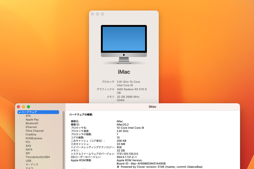

odemolay Posted June 26, 2022 Share Posted June 26, 2022 9 hours ago, Slice said: I’m upgrading Monterey to Ventura and it failed. But I have new observation. It was smbios iMacPro1,1. When I switched to iMac17,1 the installation finished successfully! Tell me please who has a success what smbios have you used? for me iMacPro 1,1 with iGpu disable in Bios, the clover commit is not anymore visible in hardware overview, do you know what is the setting to make it visible again ? 1 Link to comment Share on other sites More sharing options...

Slice Posted June 26, 2022 Share Posted June 26, 2022 4 hours ago, odemolay said: for me iMacPro 1,1 with iGpu disable in Bios, the clover commit is not anymore visible in hardware overview, do you know what is the setting to make it visible again ? <key>NoRomInfo</key> <false/> 3 Link to comment Share on other sites More sharing options...
