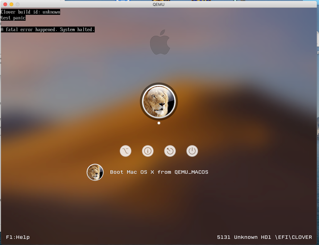

Jief_Machak Posted March 17, 2021 Share Posted March 17, 2021 Got this in console : Loading 'mach_kernel'... Could not open file 'mach_kernel' Error loading kernel 'mach_kernel' (0xe) and this in screen : The kernel is not there so all that seems normal. No crash... If you can reproduce, try launching from Qemu folder in Clover with the qemu in qemu-portable folder. maybe we have qemu bug problem... Also, the clover you gave me doesn't boot with timeout. I tried compiling one, but no crash either. Link to comment Share on other sites More sharing options...

Slice Posted March 17, 2021 Share Posted March 17, 2021 OK, I reproduce this one more time. git checkout 0dc0a93045a9ff1490277cfc2738f4a1d0c637db No matter, some commit between bad and repair. Insert one line into sources: nvram.c INTN FindStartupDiskVolume ( REFIT_MENU_SCREEN *MainMenu ) { INTN Index; // LEGACY_ENTRY *LegacyEntry; // LOADER_ENTRY *LoaderEntry; // REFIT_VOLUME *Volume; REFIT_VOLUME *DiskVolume; BOOLEAN IsPartitionVolume; XStringW LoaderPath; XStringW EfiBootVolumeStr; //test crash by timeout return 0; // This return 0 makes me boot by timeout for first entry. ./hebuild.sh -fr cp /src/CloverBootloader/CloverPackage/CloverV2/EFI/CLOVER/CLOVERX64.efi Qemu/ ./Qemu/launch Qemu/CLOVERX64.efi And voila! CLOVERX64.efi Link to comment Share on other sites More sharing options...
Jief_Machak Posted March 18, 2021 Share Posted March 18, 2021 I 10 hours ago, Slice said: cp /src/CloverBootloader/CloverPackage/CloverV2/EFI/CLOVER/CLOVERX64.efi Qemu/ ./Qemu/launch Qemu/CLOVERX64.efi And voila! Ok, making progress. I did that and I got the crash ! If I used the img you've sent me few post ago, I got stuck at : I also have ehci: PERIODIC list base register set while periodic schedule is enabled and HC is enabled ehci: ASYNC list address register set while async schedule is enabled and HC is enabled in the mac console. Knowing which img you use is easy. The img committed in Qemu folder has this theme : Could you have a quick check by copying the img you've sent me in Qemu folder? Rename it to "disk_image_gpt.img" or modify the launch command. Link to comment Share on other sites More sharing options...

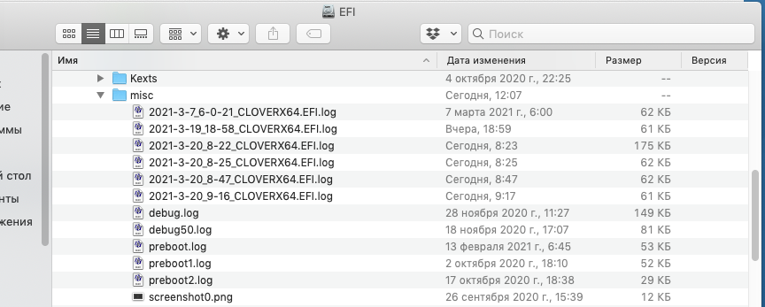

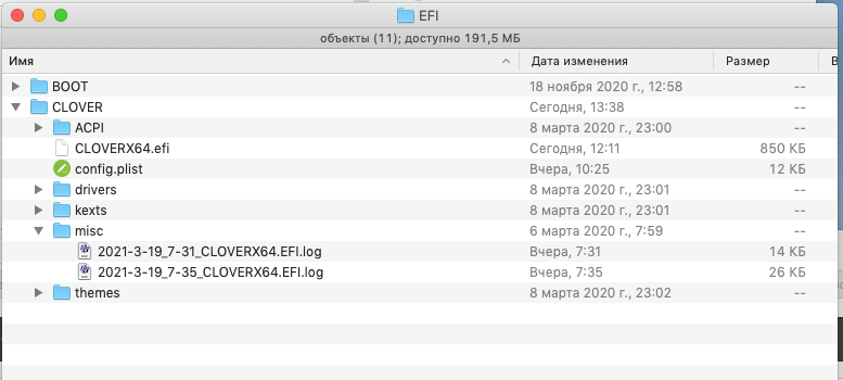

Slice Posted March 18, 2021 Share Posted March 18, 2021 One more issue. debug.log is not created at this crash. It is very-very bad. Old method for debug.log assumed that it must be created at any crash. Not now. In the old method file opened or created and closed at every line. In the new method it will be open once and so not saved at incidence. 1 Link to comment Share on other sites More sharing options...
Jief_Machak Posted March 19, 2021 Share Posted March 19, 2021 For decades, I told programmer : "check return status of everything you call, even in experimental code. If you are sure of the return status, still check it and panic (or exception) if it's not what you think". The obvious reason is to quickly know where is the problem when things change. If you don't panic, crash happens later on. You waste a lot of time understand where and why. Why also in experimental code ? Because pieces of experimental code always crawl into production code ! I killed a lot of programmers over few decades to not follow this ! Look what I did when I was trying to integrate OC EFI_HANDLE DriverHandle; Status = gBS->LoadImage(false, gImageHandle, FileDevicePath(self.getSelfLoadedImage().DeviceHandle, FileName), NULL, 0, &DriverHandle); DBG("Load OpenRuntime.efi : Status %s\n", efiStrError(Status)); Status = gBS->StartImage(DriverHandle, 0, 0); DBG("Start OpenRuntime.efi : Status %s\n", efiStrError(Status)); Do you see it ? I call StartImage even if LoadImage fails !!! So bad. At that time, I thought OpenRuntime.efi was mandatory. But that's no excuse. By not testing the result code (Status) of LoadImage, I just wasted 2 programmers a lot of hours. Arg, shame on me. If I had put something like this : EFI_HANDLE DriverHandle; Status = gBS->LoadImage(false, gImageHandle, FileDevicePath(self.getSelfLoadedImage().DeviceHandle, FileName), NULL, 0, &DriverHandle); DBG("Load OpenRuntime.efi : Status %s\n", efiStrError(Status)); if ( EFI_ERROR(Status) ) panic("Cannot load OpenRuntime.efi"); Status = gBS->StartImage(DriverHandle, 0, 0); DBG("Start OpenRuntime.efi : Status %s\n", efiStrError(Status)); See the "if ( EFI_ERROR(Status) ) panic("Cannot load OpenRuntime.efi");" ? The message would have been very clear when people try to not put OpenRuntime.efi. Bug would have been fixed in 5 minutes top. Good example that my advice was good and I must have followed it . Sorry everyone. @Slice : and please say sorry for me in Russian on Applelife.ru 3 Link to comment Share on other sites More sharing options...
Jief_Machak Posted March 19, 2021 Share Posted March 19, 2021 Ah and for the log : in the config.plist in the Qemu disk image, the key was Log instead of Debug. I fixed it and it's in the zip. Delete "disk_image_gpt.img.zip" and the launch script will re-extract the zip. I don't understand why you said that I'm not closing the log, and why you re-import old method. At the end of the new "SaveMessageToDebugLogFile", there is "closeDebugLog();" If there is a log creation problem, tell me how to reproduce and I'll fix it. Link to comment Share on other sites More sharing options...
