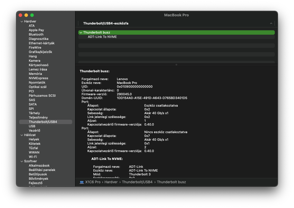

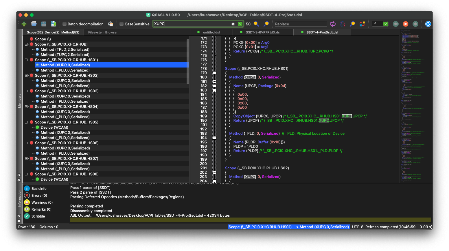

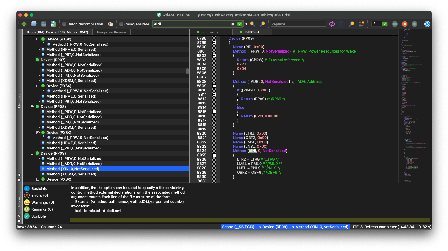

How can I transform OpenCore ACPI patches to Clover?
In OC I have these (and more like these) for my Thunderbolt 3 controller on X1C6.
(all patches are here: https://github.com/tylernguyen/x1c6-hackintosh/blob/master/EFI-OpenCore/EFI/OC/config.plist, and the TB3*.amls for them are in EFI/OC/ACPI)
TableSignature: SSDT
OemTableId: 52565037 52746433
TableLength: 7453
Find: 5F505330
Replace: 58505330
Comment: TB RP09:_PS0 to RP09:XPS0
Count: 1
Find: 5F494E49
Replace: 58494E49
Comment: RP09._INI to RP09.XINI for ICM disable
Count: 1
Skip: 11
OemTableId: 50726F6A 53736474
TableLength: 6103
Find: 5F555043
Replace: 58555043
Comment: XHC1: _UPC to XUPC
If I simply just put the Find & Replace value in Clover, Thunderbolt 3 does not work unfortunately.

First one
            <key>RenameDevices</key>
            <dict>
                <key>_SB.PCI0.RP09._PS0</key>
                <string>XPS0</string>
            </dict>
Same for others but look your DSDT for exact names/pathes.
Count and Skip are not correct because we must rename all occurence of the name.
Long path in Clover guaranties that rename will be only where needed.
