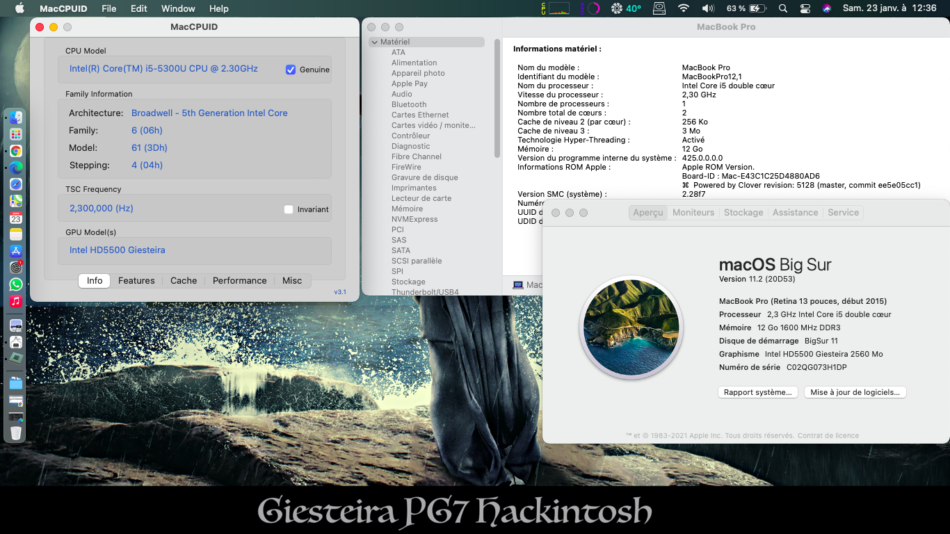

Spoiler
195075117_Capturedecran2021-01-20a02_25_07.thumb.png.e62e314a66a292d33daf0f02987444cb.png
  • Like 4
