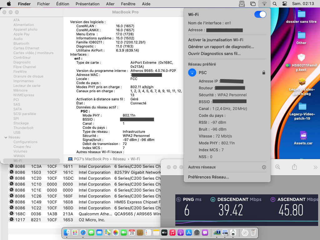

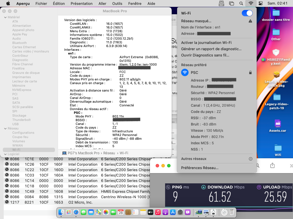

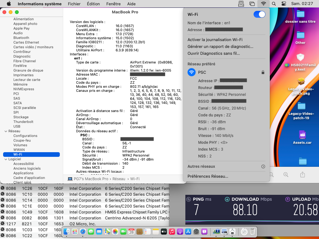

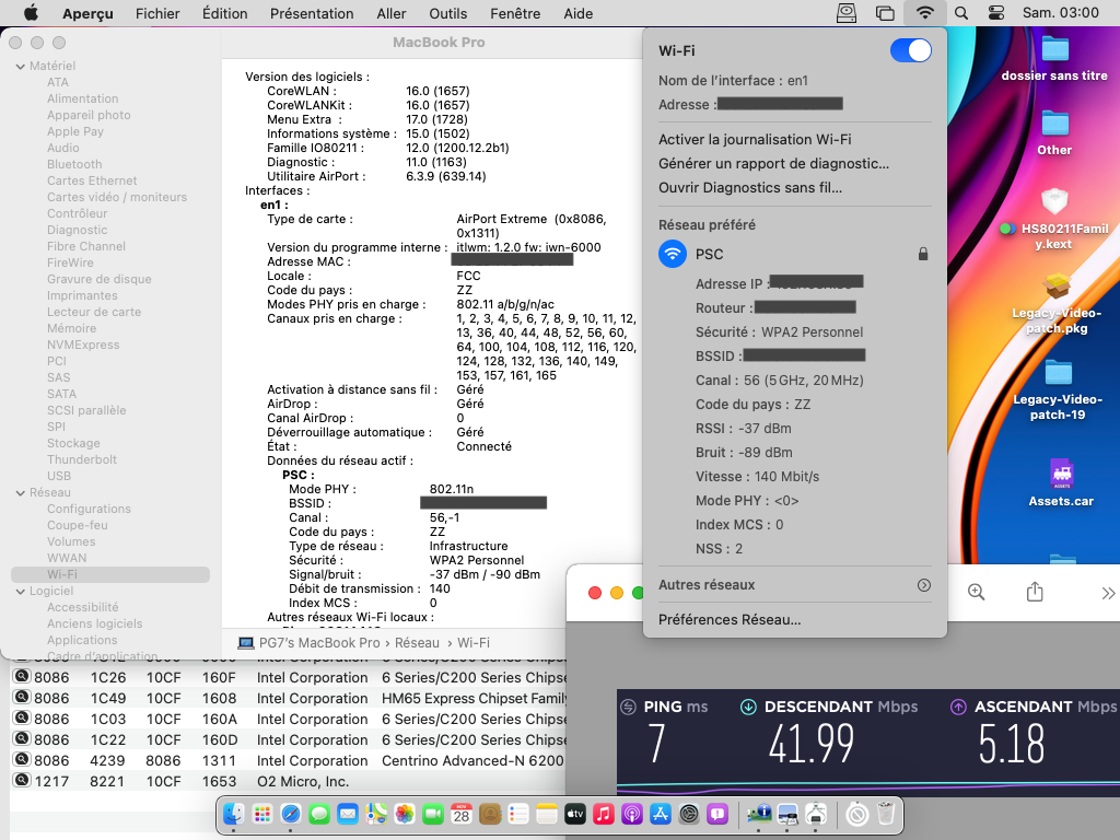

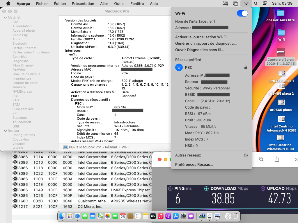

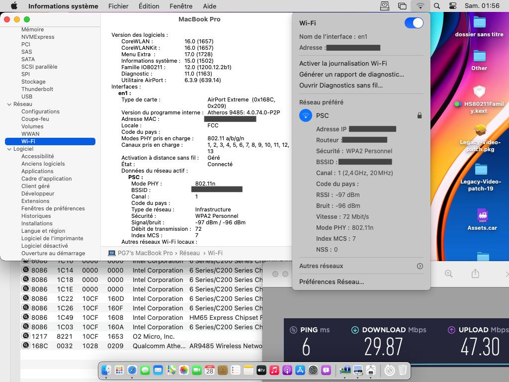

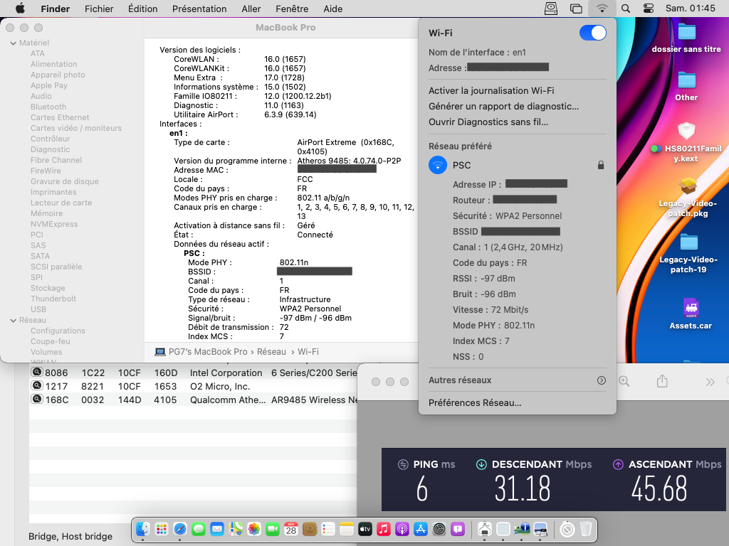

PG7 Posted November 27, 2020 Share Posted November 27, 2020 2 hours ago, Jief_Machak said: Could you try this efi with original version of kexts ? CloverX64-2020-11-27-23-25-30-d4f3145-dirty-jief.efi first test in All In One Normal -Kext = OK not to have problems with NVRAM = Boot OpenCore + Reset NVRAM Delete NVRAM boot Clover r5127 - kex HS80211Family + AirPortAtheros40 with id 2b for ar9285 on Clover in separate kext = OK but I have to confirm on others because these HP are fake means with NVRAM that is loaded even after forcing to download but tomorrow I test on others and I tell you if continues to work! Thanks for everything Link to comment Share on other sites More sharing options...
