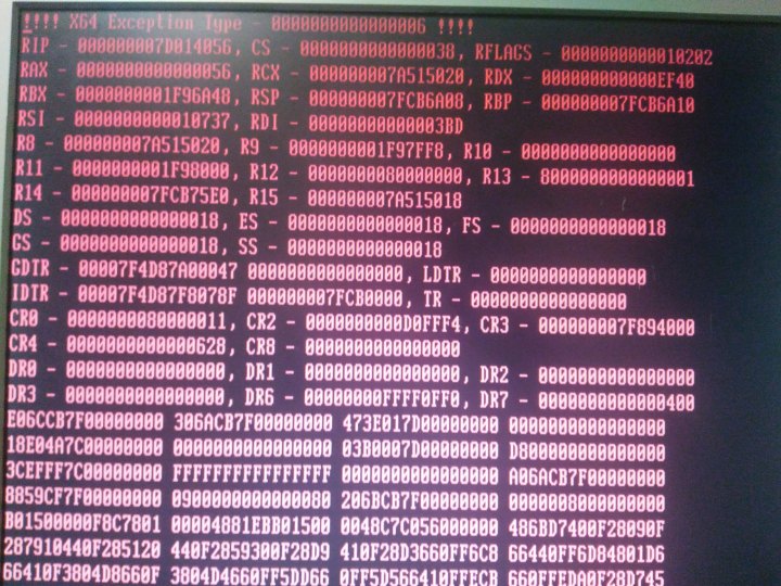

Issues with AMD CPUs again. I'm still using r4392 as updating to the release on SF or above ends with the X64 Exception Type error we had before. Has the code for AMD changed at all or is it something else. All tests of Clover were booting the same system with only r4392 booting successfully. Slice sorted it before in r4114.
Here's the debug log.
3 hours ago, Shaneee said:
Any of the devs got a thought on this?
The log is closed so it's something that is happening after boot. It's really hard to pin point without a better idea of what works and which revision is the one that actually stops working. Are you able to build yourself? Because if you could get at least within a few revisions, that would be most useful. Also did you not get an exception screen? Because sometimes that can be helpful, maybe.
Somewhere between r4392 and r4411 is where it stopped working. Yeah there's the x64 Exception Type error. I can take a pic of this if needed. I can't build the source as I get a Segmentation Fault 11 error near the end of building.
https://github.com/Dids/clover-builder/releases?after=v2.4k_r4406
Here is each builds. Install each builds step by step
You have to find wrong point from revision between 4392 and 4411.
The problem is rev 4395
VOID
 EFIAPI
 OnExitBootServices(IN EFI_EVENT Event, IN VOID *Context)
+  UINT64 msr = 0;
+  msr = AsmReadMsr64(MSR_PKG_CST_CONFIG_CONTROL); //0xE2
+//  AsciiPrint("MSR 0xE2 on Exit BS %08x\n", msr);
AMD CPU will crash at the MSR 0xE2
I will correct this in 4428

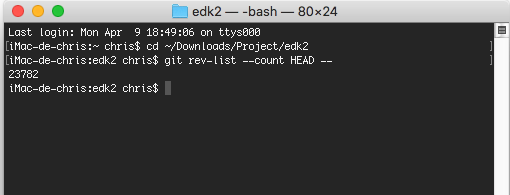

10 hours ago, chris1111 said:
how you made to check the EDK2 revision that you use with Git?
SVN its easy
EDK2 Revision
svn info /$HOME/src/edk2 | grep "Revision" | awk '{print $2;}'
First, you can get the number of commits of a git branch from the command I posted previously in the build script command topic, or you can use the hash of the commit and that should be sufficient to determine if you are at the recommended commit. Second, I don't even bother with the suggested revision, I (revert then) pull the edk2 repo (then recopy the patches) and update the clover repo before every build/commit, never had a build issue save maybe once in a while but it's usually either compiler specific or typo/bug. I guess no point in not just giving the commands here.
The command for number of commits in a branch (this actually does not match the svn commits):\
git rev-list --count HEAD --
The command for the commit hash:
git rev-parse HEAD
git rev-parse HEAD
Thanks but I not used command script, I build clover with my personal way and the commands of Clover Wiki
since many years that I do it using svn.
I will try git edk2 to another directory to test your advise
EDIT **
Thats work thanks man
Edited by chris1111
