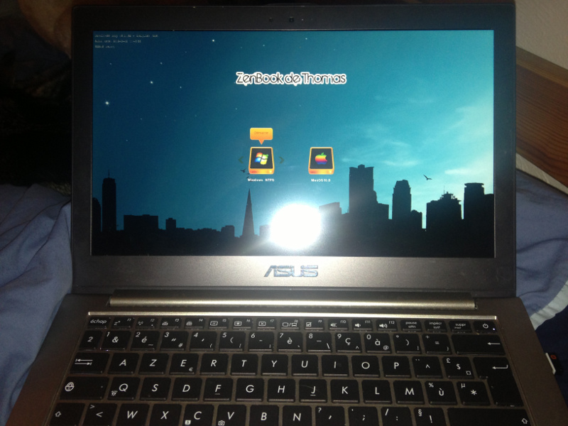

maybe the smbios or x 32 mode div by two the perfs, , i'm trying to get chameleon in 64b
Thomas, as far as I know, all bootloaders have one problem: they all let the OS recognize only 3.5GB of RAM. System Profiler tells you that you have 6GB (or more), but if you look at Activity Monitor (or "top" from the shell) you will see that the free RAM is less than what should be.
To my knowledge, the only bootloader that solves this, is Clover.
If Clover is an alternative for you, please consider using it.
I run a 64bit kernel on 10GB of RAM with Clover, with no problems.
ok, wel'll change chameleon to clover in my how to
could you explain how to get a great clover on hdd , using the /etra folder and the kexts i uploaded? we'll do a full how to with clover
it need to be able to boot windows 8 too
INSTALLATION TUTORIAL ML 10.8 on Zenbook UX32VD (works for other zenbooks too)
NOTE: I used CLOVER bootloader as it was the only one that fixed a a bug that other bootloaders (like Chameleon) have in recognizing only 3.5GB of RAM rather than 10GB like I have. If you already installed ML and use Chameleon check your "Activity Monitor" or "top" from the shell: there are good chances that your FREE RAM is less than it should be. The only way I know to fix this, is to use CLOVER.
NOTE: one SMBIOS that works well is "MacBookPro9,2"
