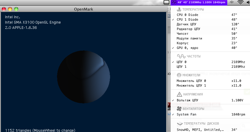

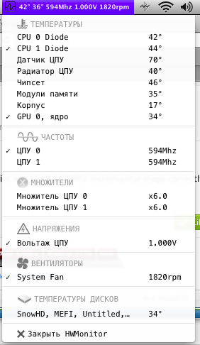

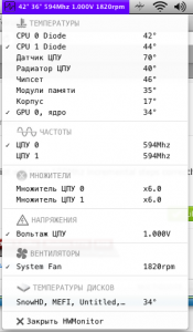

Slice Posted April 8, 2013 Share Posted April 8, 2013 I have no CPUPStates MacBook:1 slice$ ioreg -lw0 | grep CPUPStates MacBook:1 slice$ But my speedstep works fine Link to comment Share on other sites More sharing options...
blackosx Posted April 10, 2013 Author Share Posted April 10, 2013 Hi Slice CPUStates are only present in ioreg when X86PlatformPlugin is loaded. I believe this only happens when using IvyBridge or newer CPU. In your sig I see i3-2120 which is SandyBridge so you will have ACPI_SMC_PlatformPlugin loaded in which case you'll have PerformanceStateArray. Link to comment Share on other sites More sharing options...
