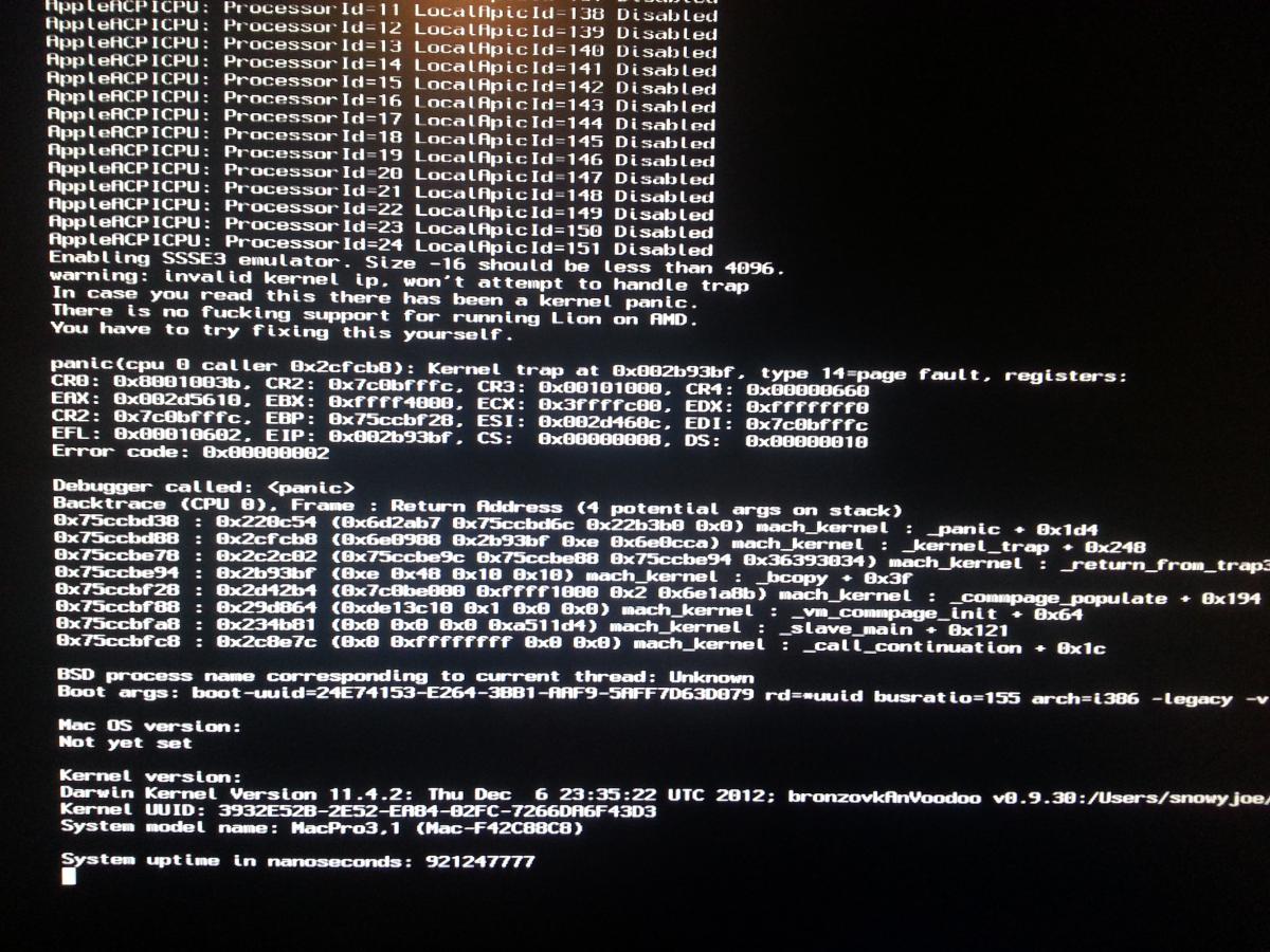

Sinetek Posted December 7, 2012 Share Posted December 7, 2012 sounds like a problem with the wonderful apple compiler.. have to look into that. is it still showing a size of -16 or something silly like that? Link to comment Share on other sites More sharing options...
theconnactic Posted December 7, 2012 Author Share Posted December 7, 2012 Yes, size--16. Precisely this. Link to comment Share on other sites More sharing options...

mac_carol Posted December 7, 2012 Share Posted December 7, 2012 Hi, folks! As i promised, i recompiled the sinactic 10.7.5 Lion kernel with the ssse3 emulator using the flags recommended by Sinetek. I added them at osmkf/conf/Makefilei386. Let's see if the ssse3 emulator starts without any runtime errors! Remember, this is for non-Bulldozer/Piledriver only. If possible, put vids or pics of your verbose boots. Good luck! sinactic.zip The same KP still happened, either with: or without: -legacy Link to comment Share on other sites More sharing options...

wastez Posted December 7, 2012 Share Posted December 7, 2012 My Lion install panics as same as mac_carol´s did. Doens´t matter which kernel flag i use. Link to comment Share on other sites More sharing options...
spakk Posted December 7, 2012 Share Posted December 7, 2012 I can not test on Lion 10.7.5, I have only 10.7.4 on my AMD I've tested the latest kernel on 10.7.4, I get the same error message as mac_carol (with the same boot flag as mac_carol). and if I boot with boot flag: -v -f then comes this strange error message: PCI Parity Error! Press F1 To Continue F2 To reboot ..... PCI Parity Error! Press F1 To Continue F2 To reboot ..... the F1 and F2 keys do not work, then I've switch my PC manual off and on. Edit: My speaker makes a duration-sound-error during the kernel panic. Link to comment Share on other sites More sharing options...

byransays Posted December 9, 2012 Share Posted December 9, 2012 AMD Athlon II X4 645 Also the system speaker kept beeping super fast Im running 10.7.3, I cant use 10.7.4 or Ethernet wont work, I havent tried 10.7.5 as Im not sure if Ethernet will work or not. Edit: Im trying to attach the picture but its not working. Link to comment Share on other sites More sharing options...
spakk Posted December 9, 2012 Share Posted December 9, 2012 AMD Athlon II X4 645 Also the system speaker kept beeping super fast Im running 10.7.3, I cant use 10.7.4 or Ethernet wont work, I havent tried 10.7.5 as Im not sure if Ethernet will work or not. Edit: Im trying to attach the picture but its not working. The kernel needs to be modified, we get the same error as you. we are all waiting for the new modified kernel to test please, test them with boot flag; -v-f . I want to know if you get the same error. Link to comment Share on other sites More sharing options...
theconnactic Posted December 9, 2012 Author Share Posted December 9, 2012 The ssse3emulator isn't ready yet, so that's why all you are getting a =-16 error from the ssse3 emulator. I'm working on it, and i know Sinetek is also working on it. The way i see it, our roadmap now consists of three main points: 1) Proper implementation of the ssse3 emulator for arch=i386 with 64-bit mode (-force64) so we finally have a trully stable 10.7.x kernel for all AMD and legacy CPUs; 2) Proper implementation of the ssse3 emulator in full 64-bit mode (arch=x86_64) so we can run Mountain Lion (or Lion 64-bit) in legacy AMD and Intel CPUs; 3) Solving the instant reboot issue with Bulldozer and Plidriver CPUs when booting 64-bit (arch=x86_64). If it wasn't for it, the first connactic patched kernels for 10.8.0 would have been sufficient for them to run either Lion 64-bit or Mountain Lion with the patched kernels. About it, i propose an experiment to the FX users (Gilles, if you're reading, you too, even if you post the results in another site): download please the latest iteration of chameleon (2.2, rev 2xxxx:Chameleon-2.2svn-r2117.pkg.zip ), one which contains the kernel patcher module and try to boot with: a] The connactic kernel for 10.8.0: connatic.zip b] The connactic kernel for 10.7.5, booting with archx86_64: connactic64 for 10.7.5.zip As usual, post pics and vids of the results. Good luck! 1 Link to comment Share on other sites More sharing options...

mac_carol Posted December 9, 2012 Share Posted December 9, 2012 a] The connactic kernel for 10.8.0: connatic.zip sorry mate, but are you sure that kernel is your latest build? since its build date was Oct 24, 2012 here are the tests: 1. flags: arch=x86_64 (without: fips_mode=0) 2. flags: arch=x86_64 fips_mode=0 b] The connactic kernel for 10.7.5, booting with archx86_64: connactic64 for 10.7.5.zip As usual, post pics and vids of the results. Good luck! 1. flags: arch=i386 -legacy result: instant reboot 2. flags: arch=x86_64 FYI, both Lion 10.7.5 & ML 10.8.0 were running within Chameleon v2.2-r2117 on AMD P-II x4 965 Link to comment Share on other sites More sharing options...
SS01 Posted December 9, 2012 Share Posted December 9, 2012 sorry mate, but are you sure that kernel is your latest build? since its build date was Oct 24, 2012 here are the tests: 1. flags: arch=x86_64 (without: fips_mode=0) 2. flags: arch=x86_64 fips_mode=0 1. flags: arch=i386 -legacy result: instant reboot 2. flags: arch=x86_64 FYI, both Lion 10.7.5 & ML 10.8.0 were running within Chameleon v2.2-r2117 on AMD P-II x4 965 Wait, what? Instant reboot with arch=i386 and -legacy? :confused: That's great about arch=x86_64. Though I don't know what that could mean, I do know that its not an instant reboot or even a kernel panic. Link to comment Share on other sites More sharing options...
mac_carol Posted December 9, 2012 Share Posted December 9, 2012 Wait, what? Instant reboot with arch=i386 and -legacy? :confused: I think the kernel was built for x64 PCs, so it won't work with x86 ones but I don't know if it also can run on old AMD, or it's only for the Buldozer AMD That's great about arch=x86_64. Though I don't know what that could mean, I do know that its not an instant reboot or even a kernel panic. yup! maybe you're right the kernel was able to pass the BSD-root detection (no: waiting for root device error) but then it stuck at Kernel is LP64 line 1 Link to comment Share on other sites More sharing options...
ham4ever Posted December 9, 2012 Share Posted December 9, 2012 Lion 10.7.5 athlon II x3 used flag arch=x86_64 stuck in Kernel is LP64 used flags arch=i386 -force64 also same stuck in kernel is LP64 Link to comment Share on other sites More sharing options...
